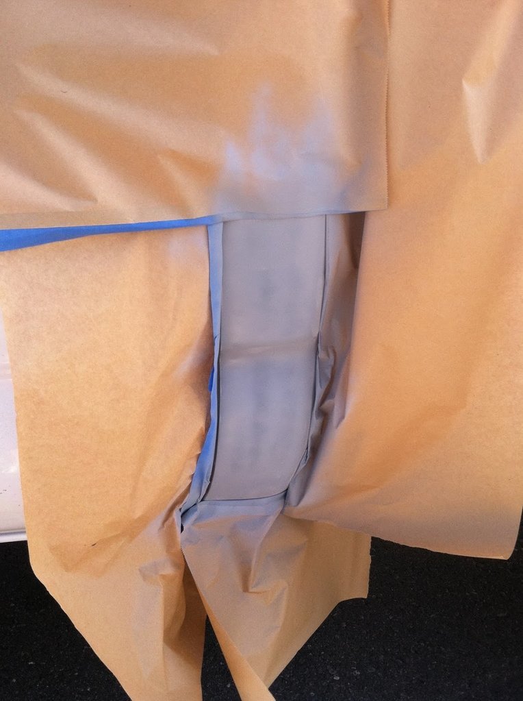

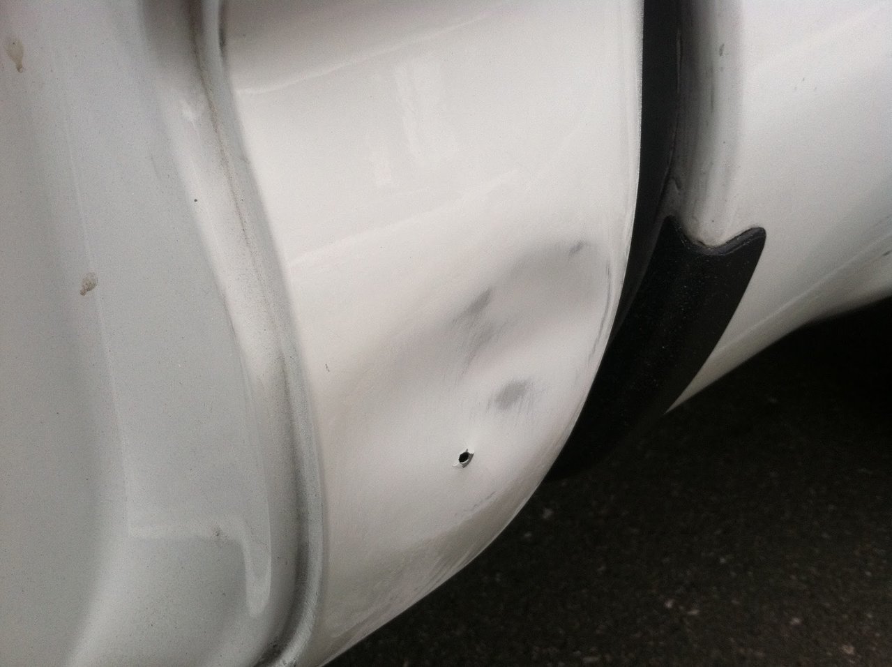

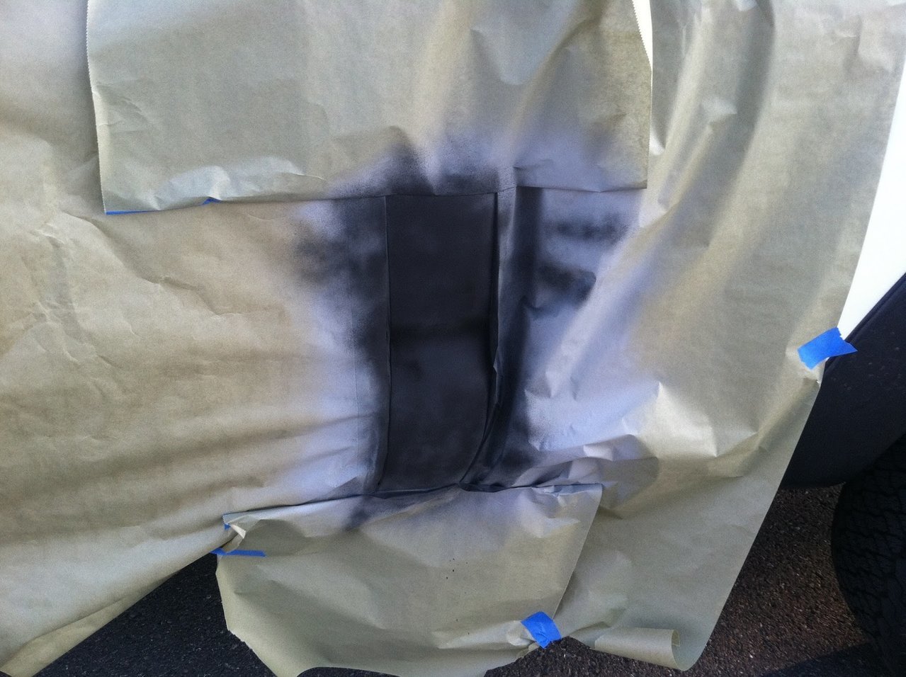

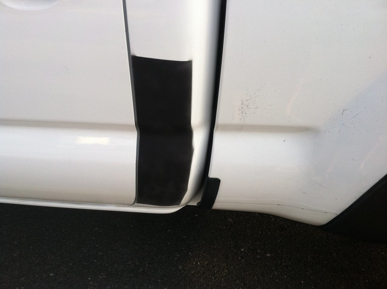

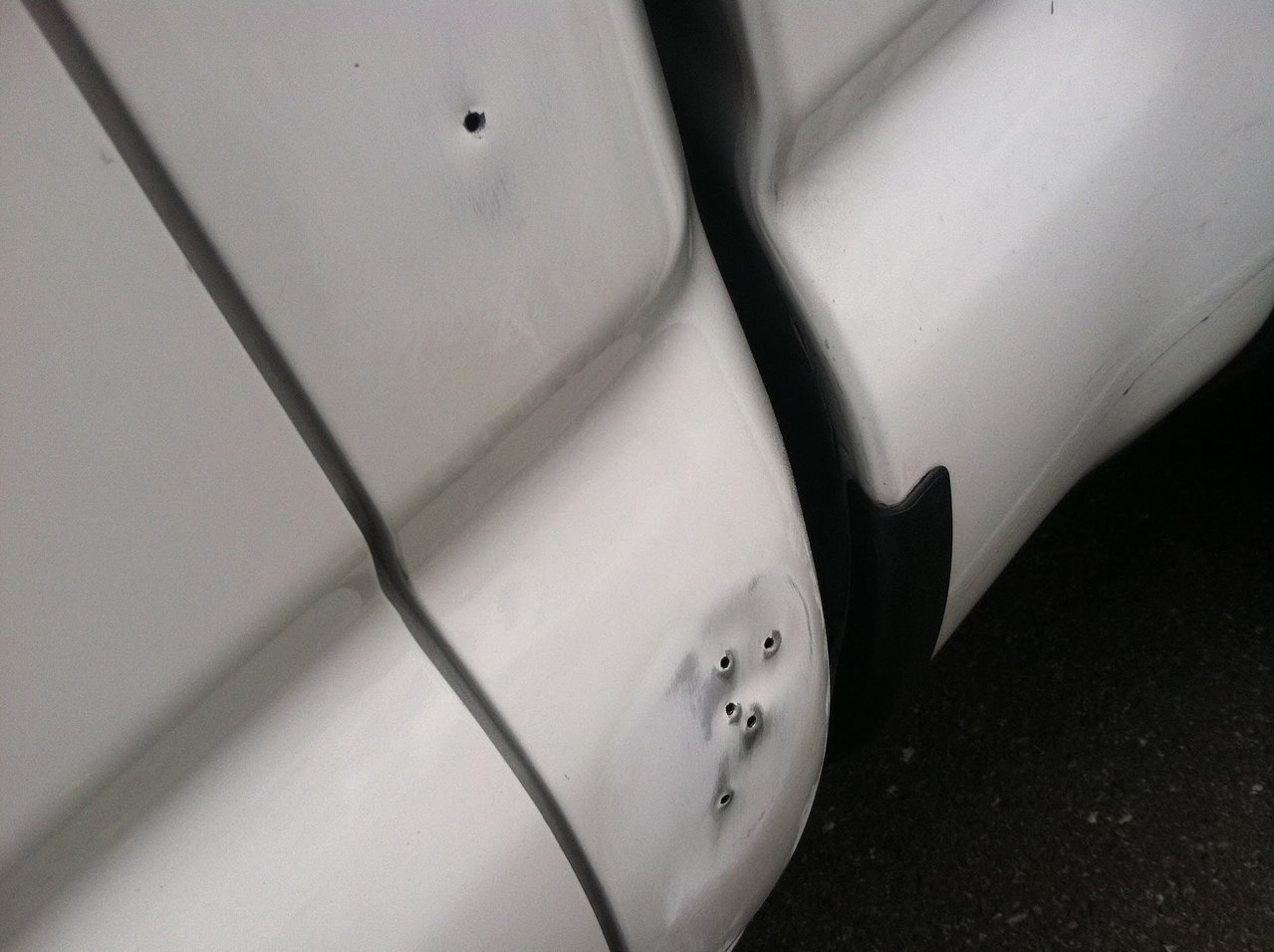

    The dent...
    I bought the truck (again it was a farm truck so it probably got hit by some equipment) with this dent and it bugged me - it stood out more and more as I made improvements to the truck. I stopped by the auto body shop to ask how much it would be to paint it if I fixed it and the guy there told me how to fix it - drill a hole and stick a screw in there and yank with some pliers. I didn't use pliers, but some water heater strap that I pulled the screw with once it was in the hole. Here's the progress:
    shEC099Dj7bSXmzTHNxE0f1_NWu8zdcWce_drW_X_5d9db5db2aa024f2d11a5da36ad220a830139d09.jpg
    loRpxxT7TI4N5C2sBEZFlq9m16VDlcy9BHx3qBoq_ac2fc9ab245be5d37e01a8954c75e4f921436dee.jpg
    Zzdl8g5SGBwjHLYRPjxg-g0Rc03OajoB165un9az_3db9b28ca6346ba466442fcf7592d6f13b0435bf.jpg
    BmwDm6_hZBUVJ19k3ok9OYAYK2EOv2RdbD8Vbcvl_8c1f87abdcd3f1b5aa922f772a8ce78c25f5568a.jpg
    MJg0vqHpuXv6wWw43400Jgl6rX22zV5HHj3mcm8W_58aa11dc3e72cf59f9a2640fe9f2040c969d5599.jpg
    jGbcNq2BOs-06y7PuNiagcawBP_-Rsa5FaWlvXuW_18274995360f468ca1760a4ed226c33c8b9e7b5d.jpg

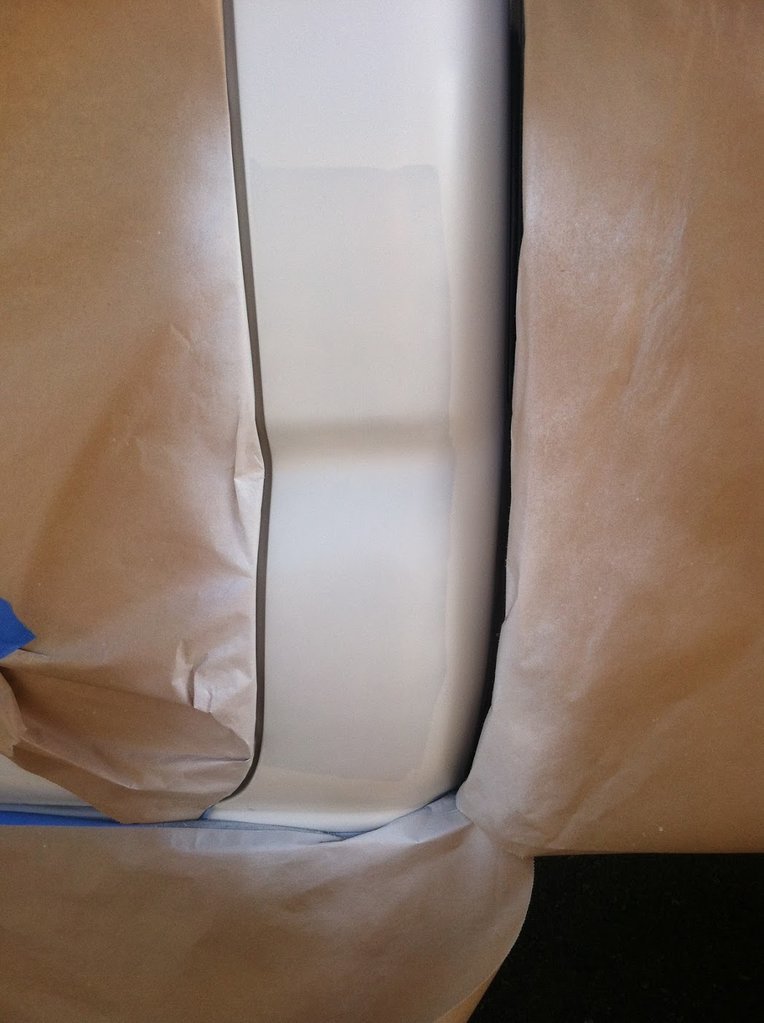

    I don't know why I stopped taking pictures. I put a few more coats of white on it and left it for inspection the next day. I was bummed out to find that the bondo was a little high in the biggest fix. I think that I'm the only one that would notice it besides an autobody specialist (maybe that's being too optimistic lol). Anyway I held back from clearcoating it and I'll probably sand one more time and paint it again when I do another painting project on the truck and I have all my materials out again.

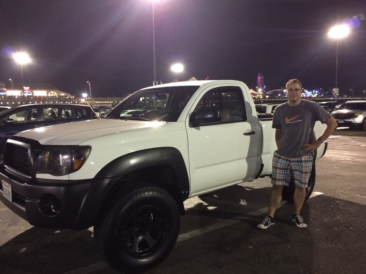

    Did an oil change today and drove a couple hundred miles around Orange County and LA - PCH all the way up to Deer Creek Road on a night run with Dan. Here we are at the Santa Monica Pier.
    sAhrCkv53mTszMFRnMQDMTH1IcZ091Vj0lm3ev1I_dcce47a99c66e4ec157fdd254c6c3493d462bf76.jpg
    I'm pretty much his tour guide while he's here. It's cool with me - I get to have a good excuse to drive to all my favorite spots :)

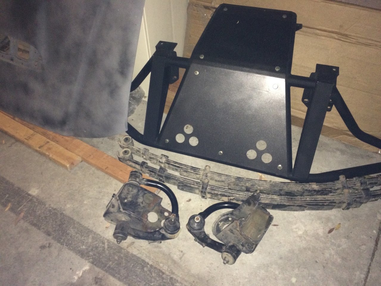

    Oh and I picked up a few things...
    :spy:
    s34PZlGdLJHCIf_arti49Nf8GTsYlreaLyIw3jrt_992837762855862e142f3fec26d4f018cd308651.jpg
    I got the springs and the uca's from a deal on craigslist that was too good to pass up. It turns out they were being sold by a cool guy named Jordan who used to work for DeMello off road. He hooked it up big time - $340 for the springs and uca's. I got the bumper off of a forum member here for a hundred less than a new one and it's in brand new condition pretty much.

    Next time if you have a dent like that and you seem handy enough....try getting behind the dent...you probably have to remove the interior seat belt area and then push the dent out ...just like the paintless dent repair. You'll probably go too far, but it's better than drilling holes and then bondo so much... not sure if black primer was good either if your truck is white. I didn't see final product all done...but just a suggestion.
    Biscuits and Dalandser[OP] like this.
  5. Aug 27, 2015 at 11:59 PM
    #25
    Dalandser
    Dalandser [OP] ¡Me Gustan Las Tacos-mas!
    Feb 19, 2015
    #149090
    16,770
    Anthony
    Downey
    08 PreRunner Regular Cab / 98 4x4 Extra Cab
    Empty Wallet Mod
    All good advice. I tried to get behind that dent, but there's an inner skin blocking the whole thing inside the cab :( The black was a guide coat for sanding which I still messed up a little :/ I'll keep working on the thing - it's good for now, but I have a hood I'll be painting and I'll do the whole she-bang at once. Thanks for the advice - if I hadn't tried those things I certainly should have - does that make sense? lol

    Oh I see...the black was to spot the high spots. What kind of paint did you use? Duplicolor? What about clear coat...you using 2K clear coat or just regular from spray cans? The 2K is more expensive and dangerous to breathe, but it supposed to be close to the automotive clear coat in terms of longevity
  9. Aug 28, 2015 at 12:08 AM
    #29
    Dalandser
    Feb 19, 2015
    #149090
    16,770
    Anthony
    Downey
    Empty Wallet Mod
    Yeah I used Duplicolor from Amazon. It was alright, but a little yellow. The body shop guy told me about a local automotive paint store that I'll probably try. I have a can of 2k clear waiting in my "workshop" (water heater closet lol). I have a respirator - I used to paint commercial and residential properties for a living so I feel pretty comfortable painting (doesn't mean I'm great at it though).

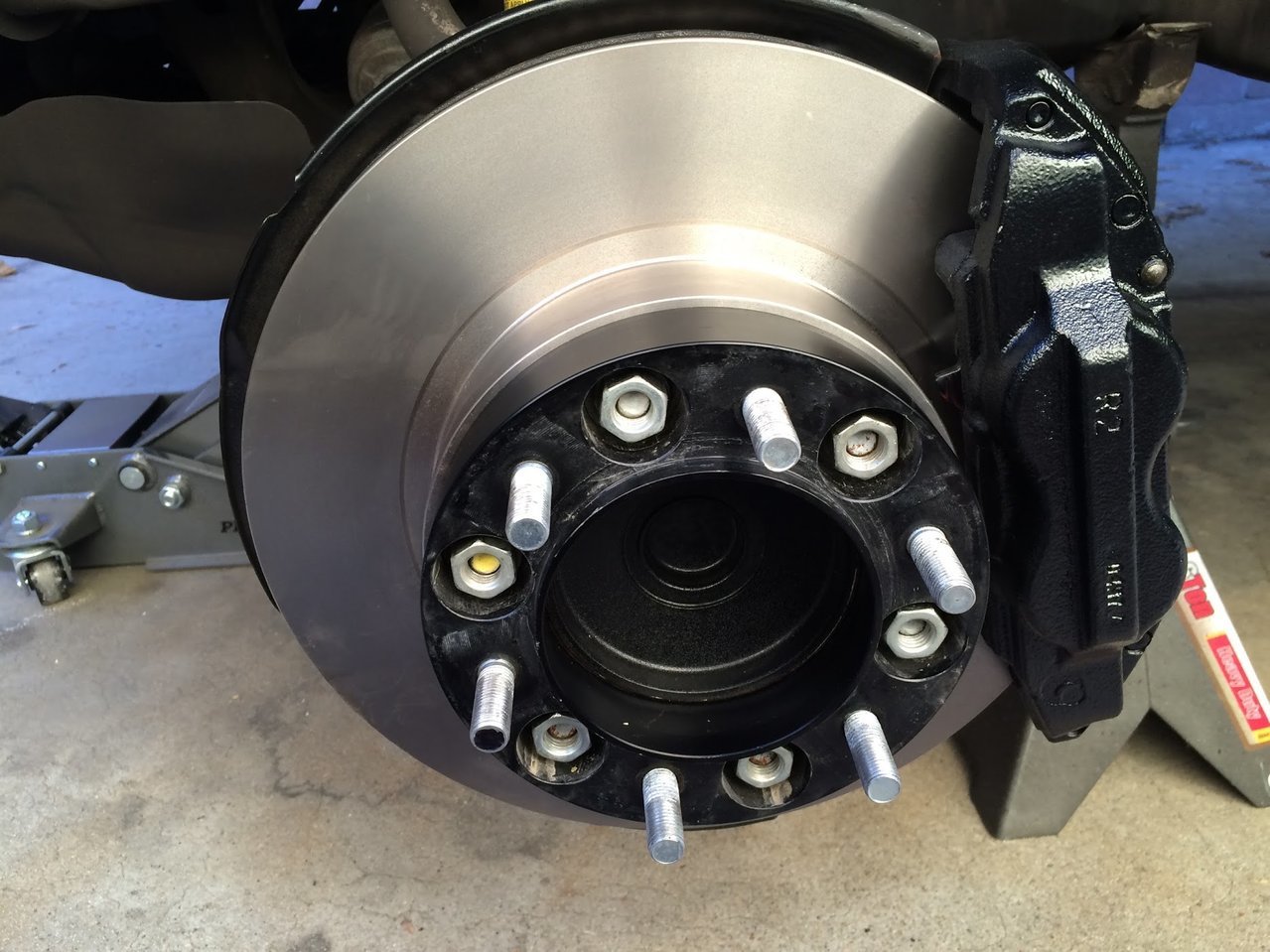

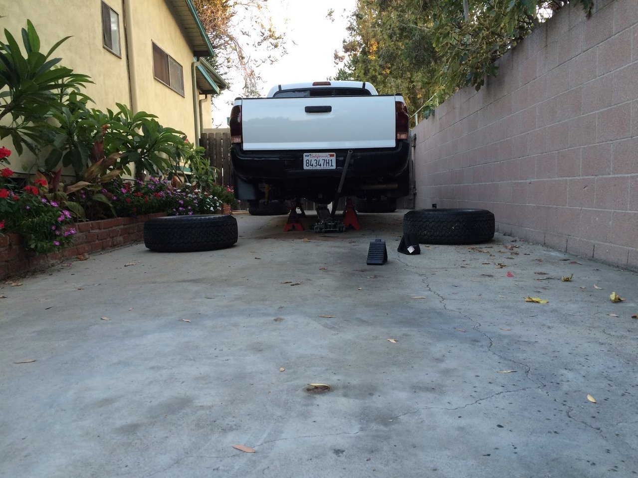

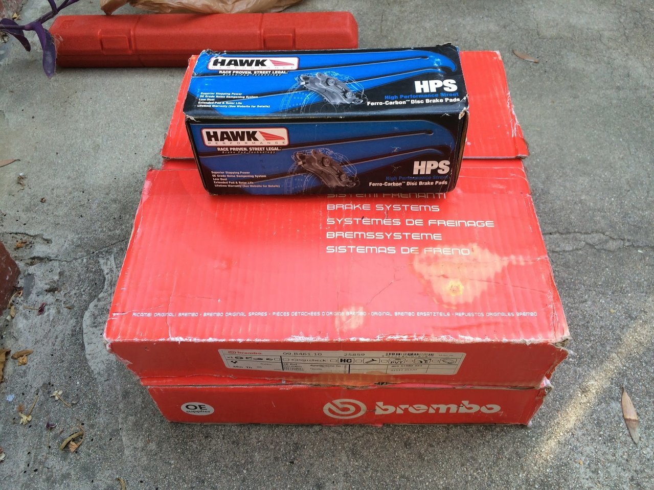

    New front brakes.
    vhBsJ17s0k-pfqNvFt44A8qDZJjhaz97eTJxXYo1_53c6d36d5573c00c5c2a099e0720f56e00162438.jpg
    Thanks to another forum member here - got the pads and rotors for $175 and watched this video to learn how to do it:
    https://www.youtube.com/watch?v=AiMVzzasVCw
    Here's a thread on tacomaworld with the video - the video was made by him.
    https://www.tacomaworld.com/threads/how-to-change-front-brakes-pads-and-rotors.353082/

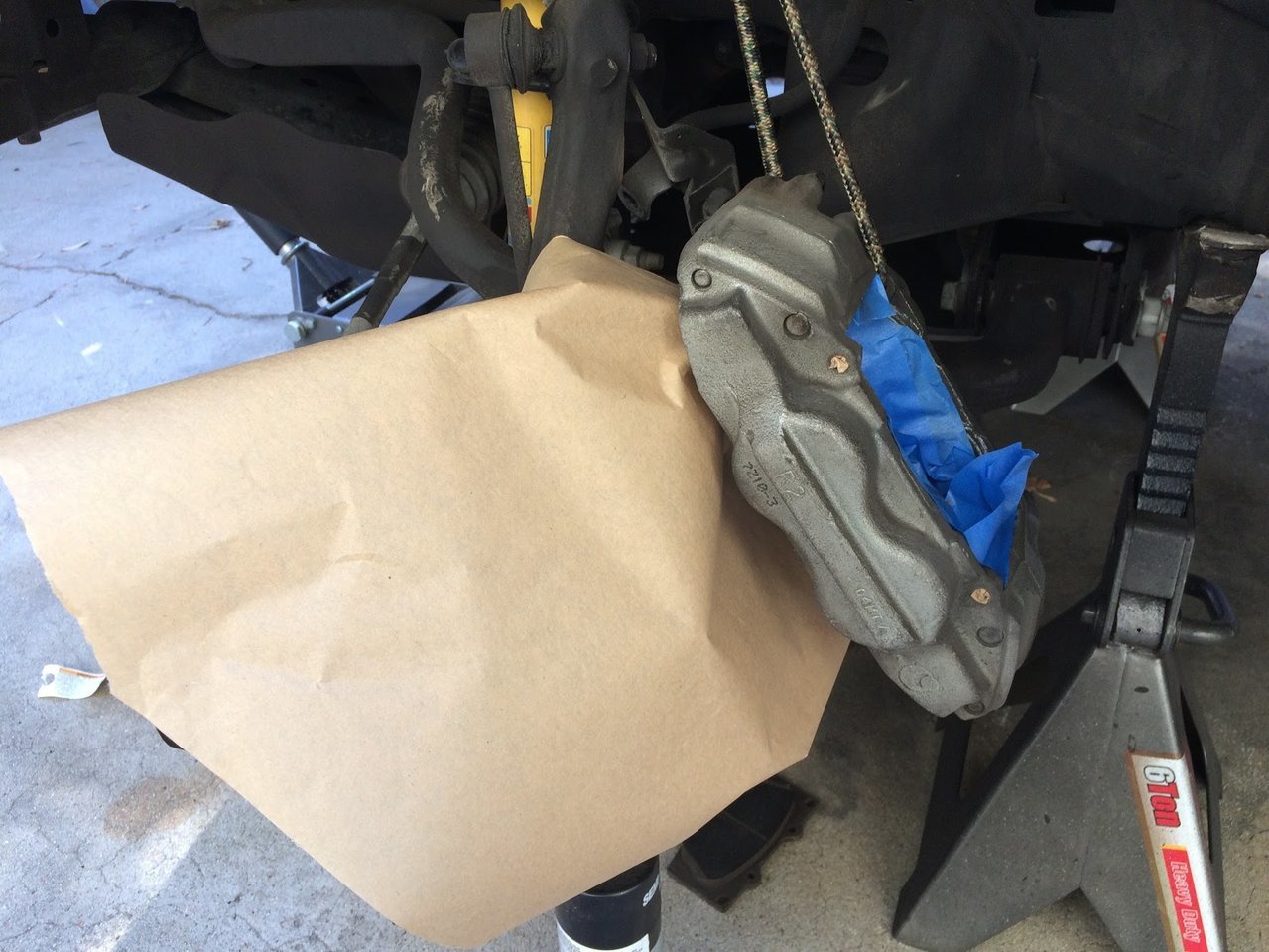

    I decided to paint my calipers - I used Duplicolor semi-gloss black engine paint. I just hosed them with brake clean and brushed them with a metal brush for a bit.
    0DBHT2Db2ZL_K6WgJpRXKv4D2C8F9WjJ7I-hv0Xn_26d2a67458312eed7cc741a1d12d106674db28d1.jpg
    The new brakes!
    29GOx2X76oGyVvMq36lzrWRZILcJu18ro8HoS6na_e2bcda3fe08dd0a3f291ae966cc33de3f2861ebb.jpg
    A year ago I'd never believe I'd see my own vehicle like this!y5Zmaoj49PedfUcX61-JKkryjU1640c79SYQJex6_64a78a2746948b019e9edc8177067ec5ecf91fa2.jpg
    I took the time to rotate my tires since I did the oil change yesterday.
    Driving around the block I could feel a difference in the braking power. I'm glad I did this - next up is the brake flush and some interior stuff :)
