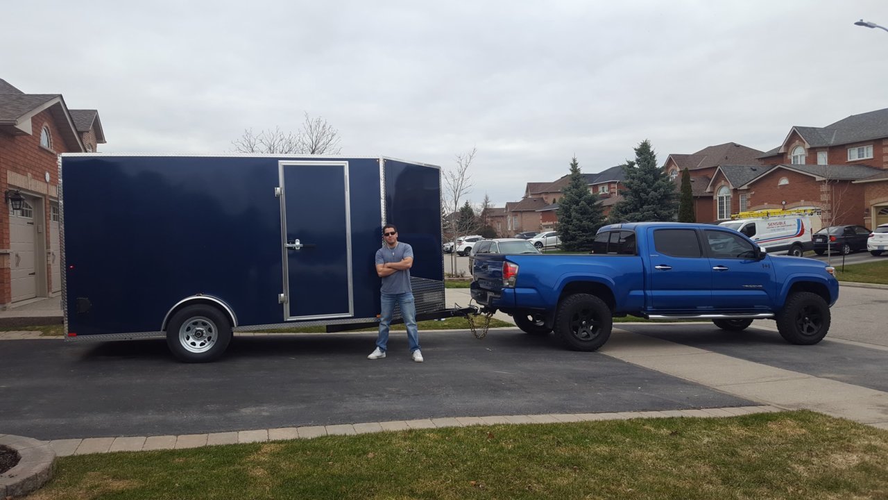

    So I thought I would show my trailer build here as well. Instead of it being on the front page with the truck stuff, ill just add it in here

    Trailer is a 2020 Canadian Trailer Company 7' x 12' v-nose.
    Measurements:
    Full Length: 16 feet long, 7 feet wide
    Factory Features:
    16 o.c. wall joists
    16 o.c. roof joists
    16 o.c. floor joists
    3/4" Pressure treated floor
    3/8" plywood walls
    Electric Breaks, with breakaway
    8,000 Pound Jack
    Side Door
    Ramp Door
    Ramp Extension
    Grade 8 safety chains
    Bar locks
    Stabilizer jacks
    My Add-ons
    AMP Lock - BRP 2
    Tri Max locks

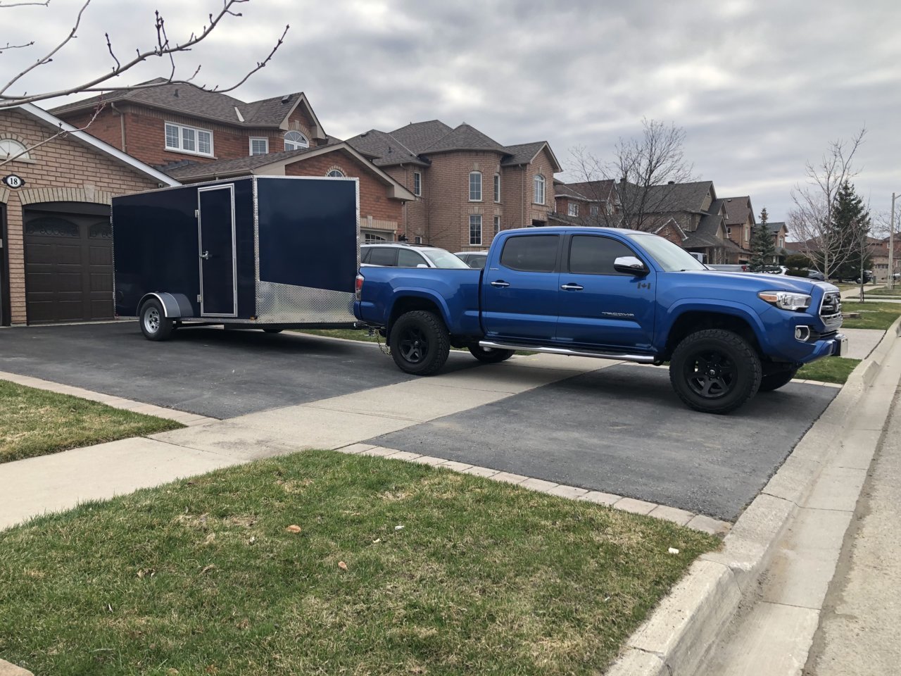

    Some Pics,
    Owner, Brian and myself.
    Canada strong
    Hooked up

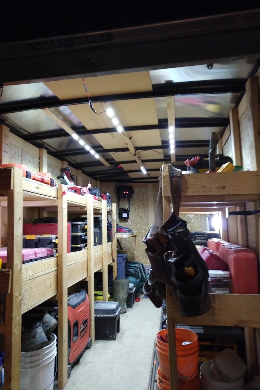

    Alright well, mods are coming quick.
    This trailer is for my business. I want it organized, functional, and badass. Heres the to do list
    Light bars and pods on the outside,
    Interior lights,
    Solar Panel to recharge the battery,
    Shelving,
    Cabinets,
    Tough System racking ,
    Hooks and organization

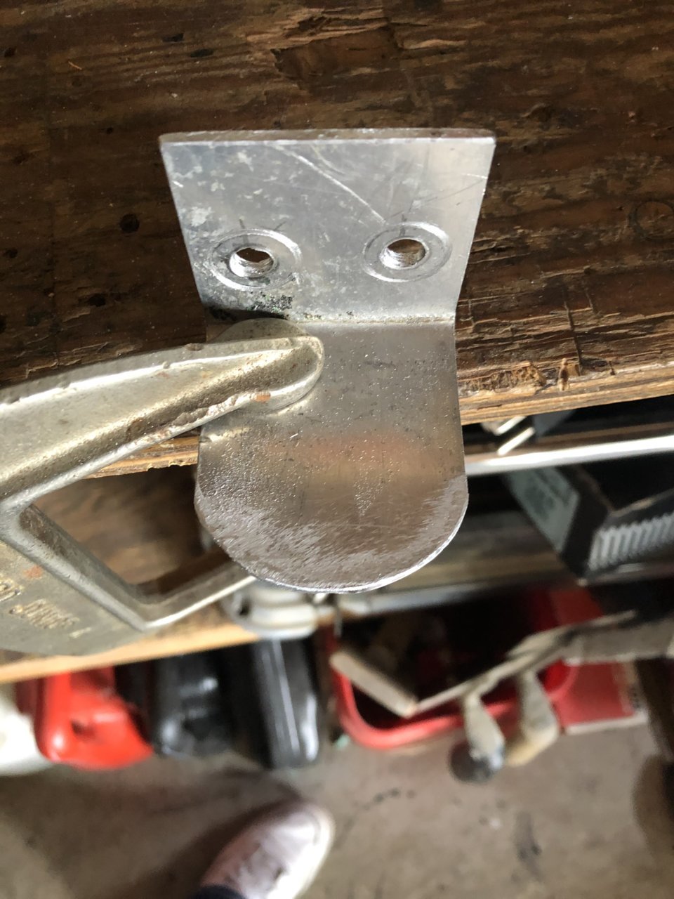

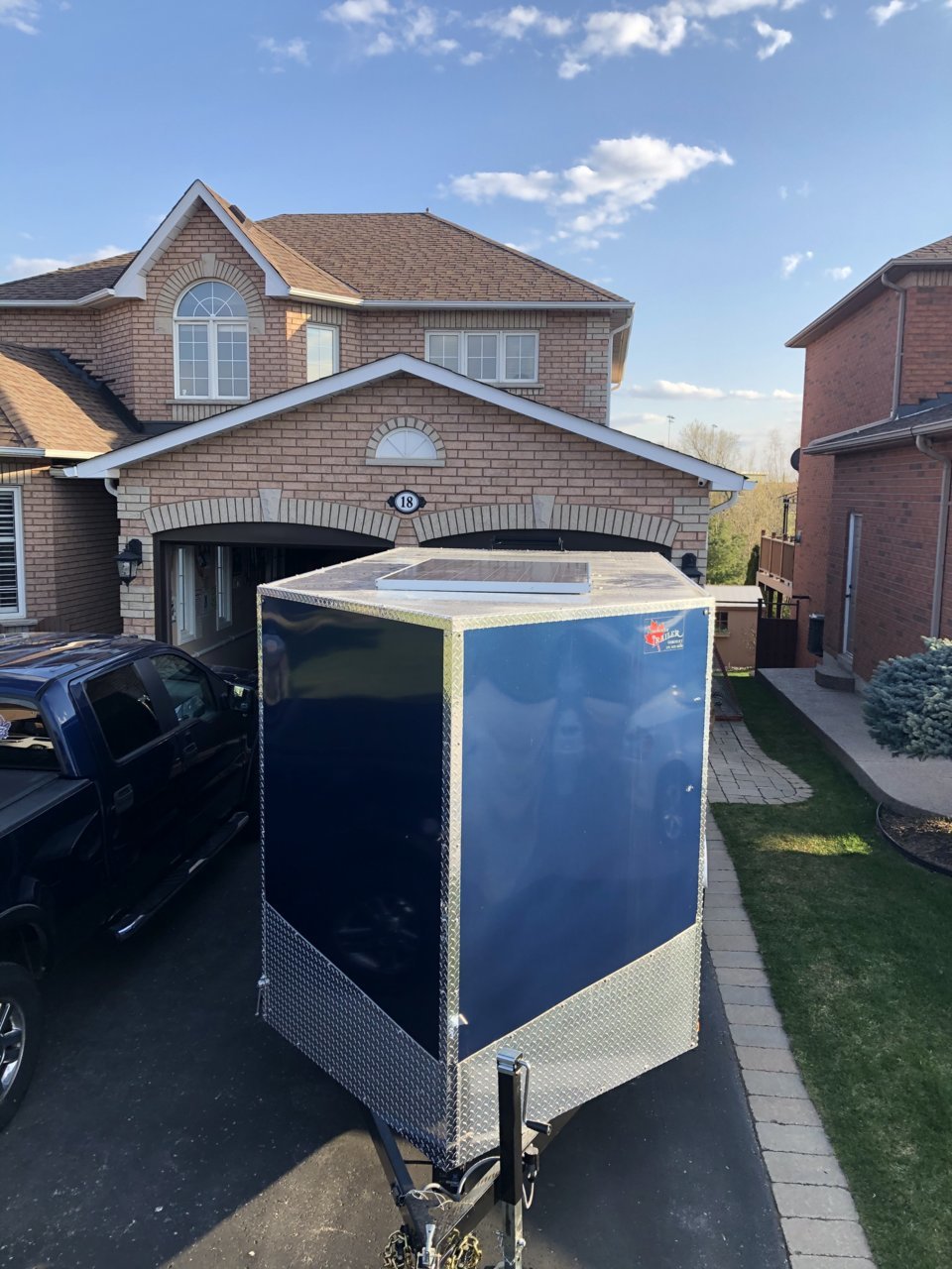

    Well this was the start. I scored on a 230 Watt Solar panel. So I made my own Aluminum brackets, and bolted it through the roof and through the roof joists with all stainless hardware. All holes got silicone through them and around them. Looks pretty sweet up there!

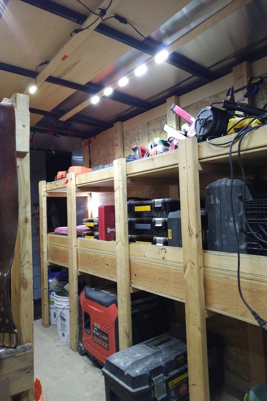

    I did some lighting in a buddy's trailer similar to yours.

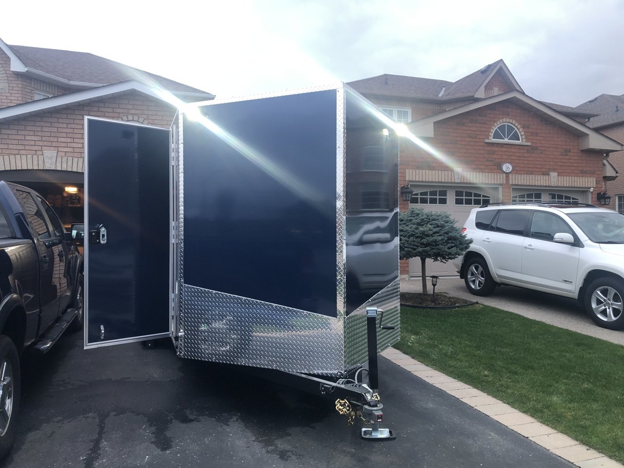

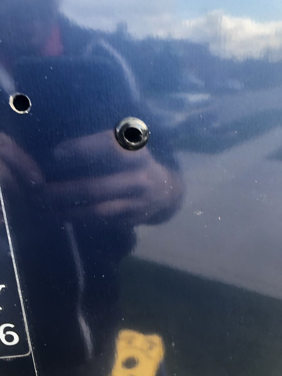

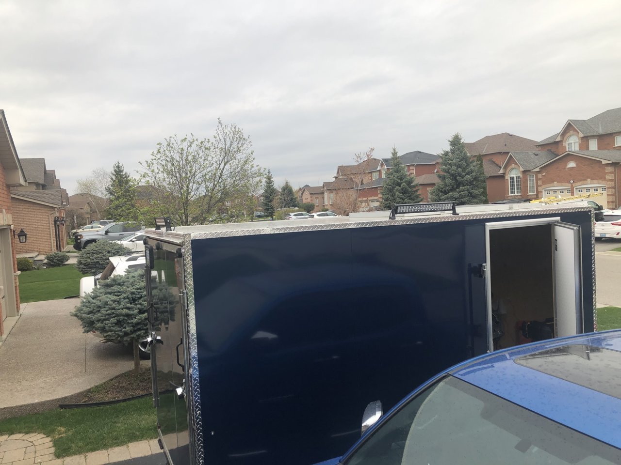

    Next was the lights
    Was nerve racking drilling into this beaut

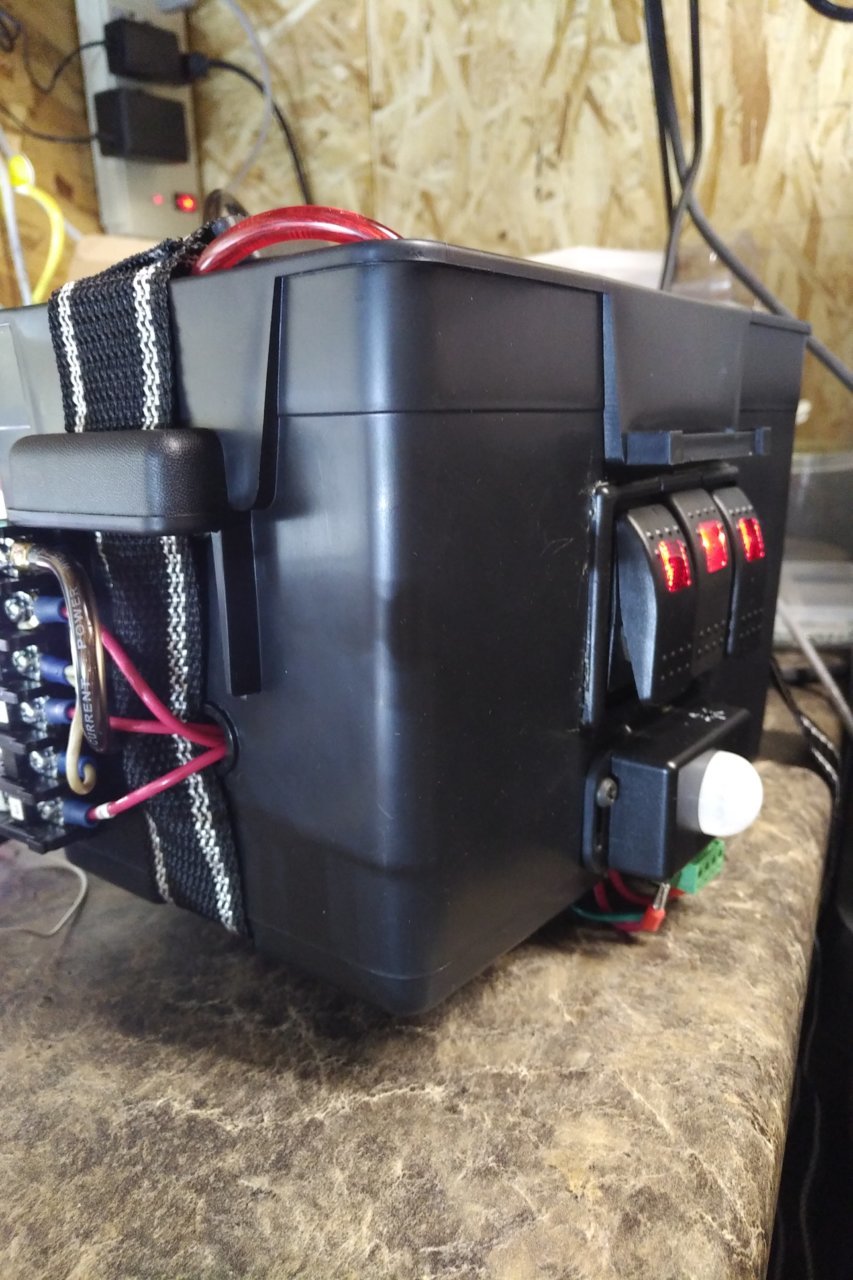

    Add added contacts on the back and side door so when the door opened then an LED strip over the door would com on. The 3 switches on the battery box are for override if he was doing some work inside.

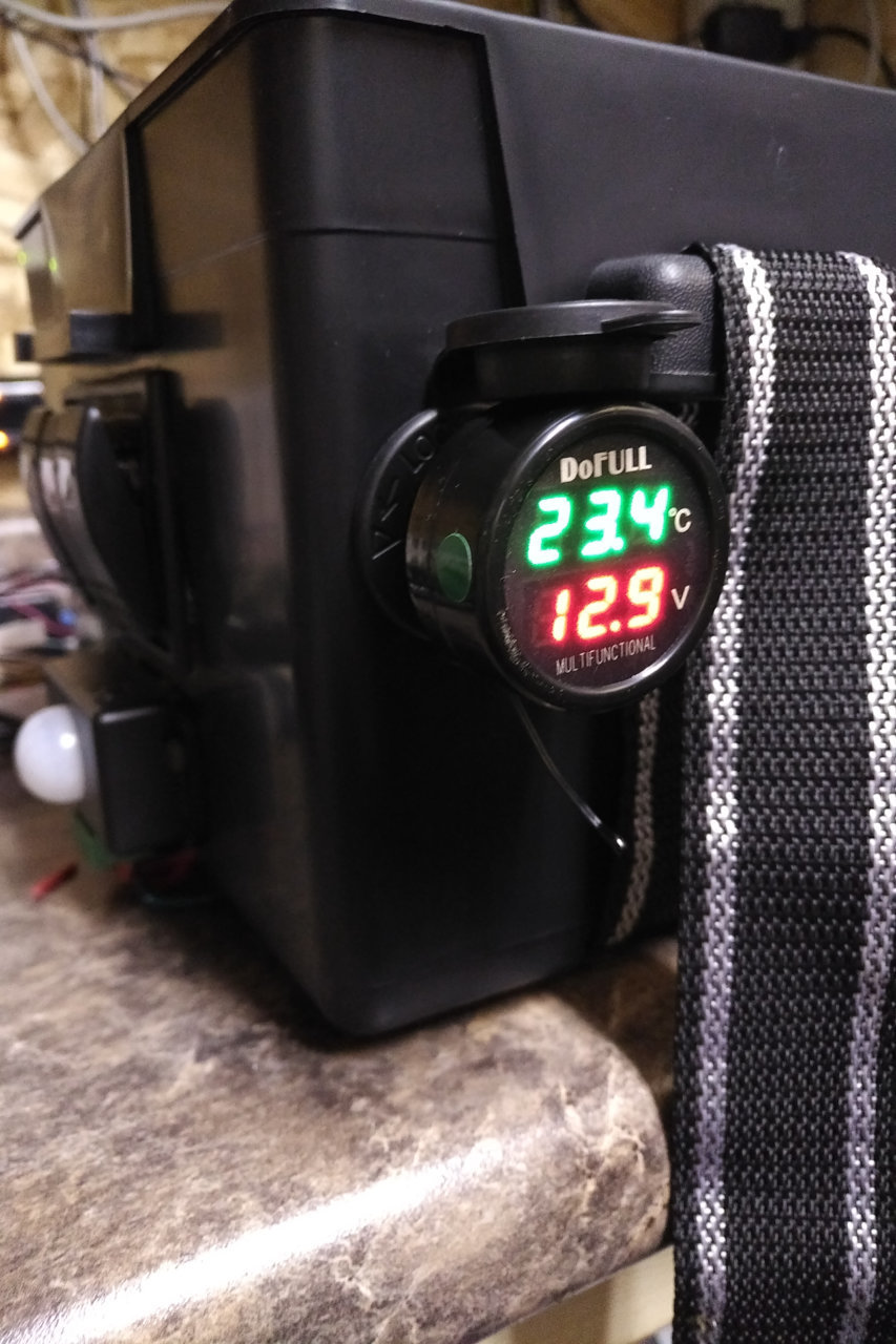

    I also added a DC plug on the side of the battery box which provider voltage, temp and a USB jack to charge a cell phone.

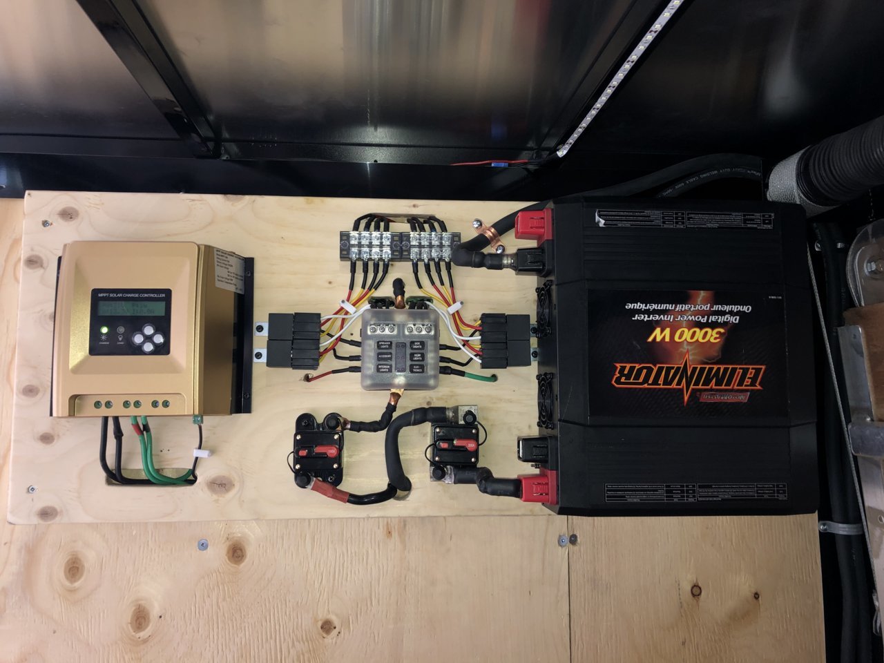

    Panel board is all done. Pretty happy with most of it. Only thing i would do differently is have everything before I start it:p

    Looks great!
    Nice and clean man good job :fistbump:
