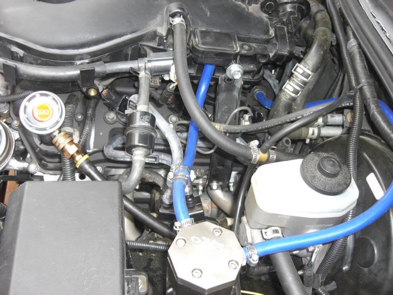

    Here is another. Follow the blue hose.

    Awesome thanks

    Here's my lower mounted one, got the idea from the XR forum.

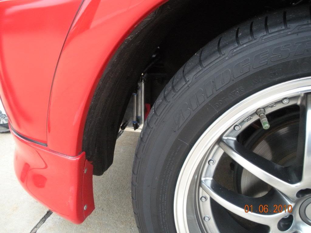

    I think I may have spent about $40.
    I have run the set up for a couple of years with no problems. I am an X-Runner, so no off roading. While the catch can is exposed, it is in front of the wheel. If it was behind the wheel it would catch a lot of crap.

    As I'm a 4x4 it is out of reach of the wheel if it was stuffed all the way, probably a couple of inches clearance. It stays surprisingly clean for it being right there in the front. I give mine a wash each time i wash the truck. Real easy being right there in the wheel well area.
