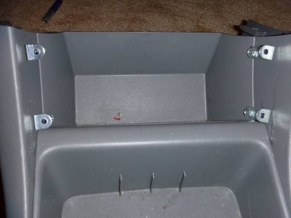

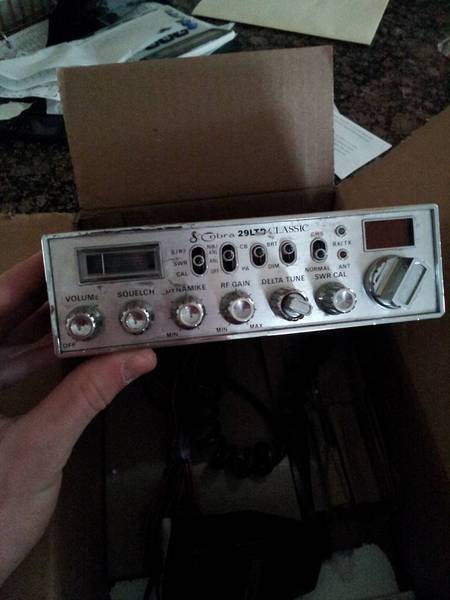

    I wanted a CB for when I go wheeling and just to play around with, but as yall know there aren't alot of options for mounting a cb in the Taco. I came across a Cobra 29 for $35 and got my inspiration from db (http://www.tacomaworld.com/forum/audio-video/49635-cb-radio-cobra-29-mod-mount-center-console.html). I got my radio in the mail and immediately began diving into the massive amounts of soldering.
    And 10 hours, and 126 solders later, I was finished moving the controls.

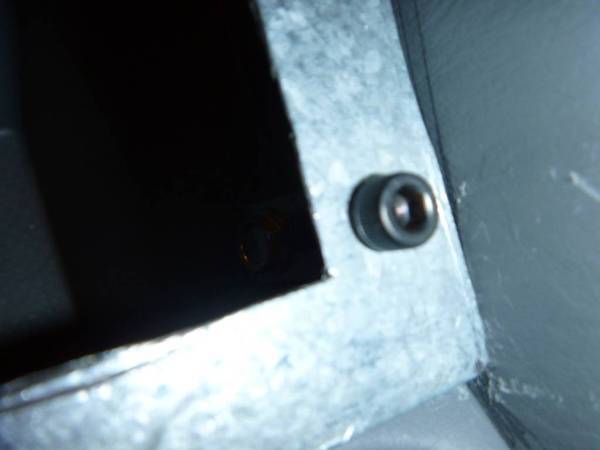

    Now was time for the faceplate. I made a cardboard template and cut the face plate out of 1/8" sheet metal.
    I got some L brackets and alen screws and mounted up the faceplate into the cubby in front of the shifter.
    I proceeded to mount and run the wires under the center console back in the truck.
    (I'm not gonna lie, kinda felt weird cutting such a nice truck haha).
    I ran my coax cable out under the drivers seat and to the bed where it was attached to a home made bracket I made using angle aluminum and grounded it. I have a 4' Firestik.
    After it was all buttoned up it actually works :D
    I love the location, super functional and clean:cool:. Let me know what yall think
