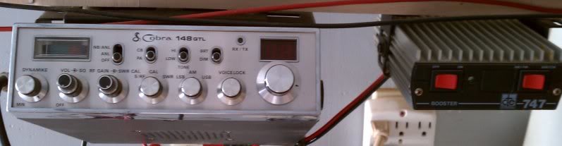

    My setup, currently installed in my garage.
    Cobra 148 GTL modified with variable deadkey, aluminum knobs replaced the stock plastic knobs, funny channels (able to select about 80 channels above and below the stock 40 channels) Tuned to about 12 watts AM and 24 SSB. On the right is a 100 watt modulator, I used to have a Palomar 300 watt unit that required a 4 gauge cable from the battery. I have yet to decide how to mount in my Taco this setup. I will probably hunt the internet for another linear like the 300 I had. I will probably end up with a TexasStar 625.
    I really enjoyed your write up. If I may suggest, Wilson 1000 magnet mount on the center of your roof. I was able to talk to South Africa on SSB with that antenna and the 300 watt linear. My SWR on the Wilson 1000 was 1.2:1 at each end of my frequency range and 1:1 near the center of my frequencies. I am an older CB fanatic. I am glad that there are still users out there.
