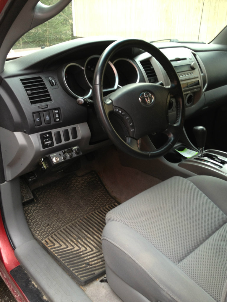

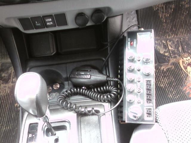

    Love that location. One question tho, what keeps the coin tray from opening?
  3. Dec 2, 2012 at 8:29 PM
    #123
    650H1
    650H1 Well-Known Member
    Jan 3, 2011
    #48689
    8,680
    Michael
    VA
    2020 (Cement) TRD O/R
    the wires that i run between the lower dash plastic and the bottom of the coin tray keep it really friggin tight actually. i just closed mine, and it stay there, doesnt even rattle or anything :)

    What speaker is that in the cubby?
  6. Feb 28, 2013 at 9:31 AM
    #126
    Infra
    Infra Well-Known Member
    Apr 29, 2010
    #36238
    2,951
    Jason
    Az
    2010 MGM DCSB 4x4 TRD OR 6spd
    CBI Bushmaster 2.0 rear bumper with swing out tire carrier & fold down camp table, CBI Moab 2.0 front bumper, Warn M8000-S, Icon 2.5 RR CDC Extended travel CO's with 700lb springs, Icon 2.5 RR CDC rear shocks, Icon hydro bumps, Total Chaos uniball UCA's, All Pro Expo leafs, U-bolt flip kit, Softopper, diff breather mod, extended rear brake lines, Grillecraft mesh grille, Elusive Elements behind grille light bar with B.A.M.F. LED light bar brackets, okLEDlightbars.com 20" double row LED light bar, Relentless Fabrication hood cb antenna mount, Wilson Silver Load CB antenna, Uniden 520 Pro XL CB radio, Wet okole seat covers, Weather tech floor liners, Weather tech in channel window deflectors, trasharoo spare tire trash bag carrier, Box Rocket 2nd gen bed rack with (2) 2 gallon gas rotopax mounted on drivers side, (2) 2 gallon water rotopax mounted on passenger side, (1) 3 gallon gas rotopax & (1) 2 gallon gas rotopax mounted on CBI swing out, Avid weld on sliders, Mattgecko LED bed light
    probably just an external speaker for his cb
