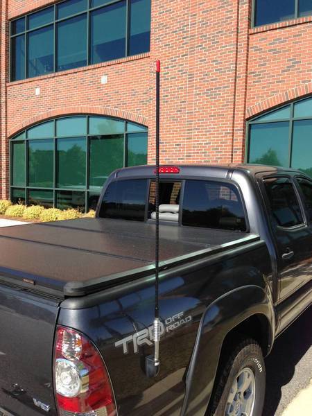

    hmm... the main difference that i see is that i am using a 4 foot antenna while you are using a 3 foot antenna. perhaps try moving your antenna to the back of the bed just to see if you can get a better swr.

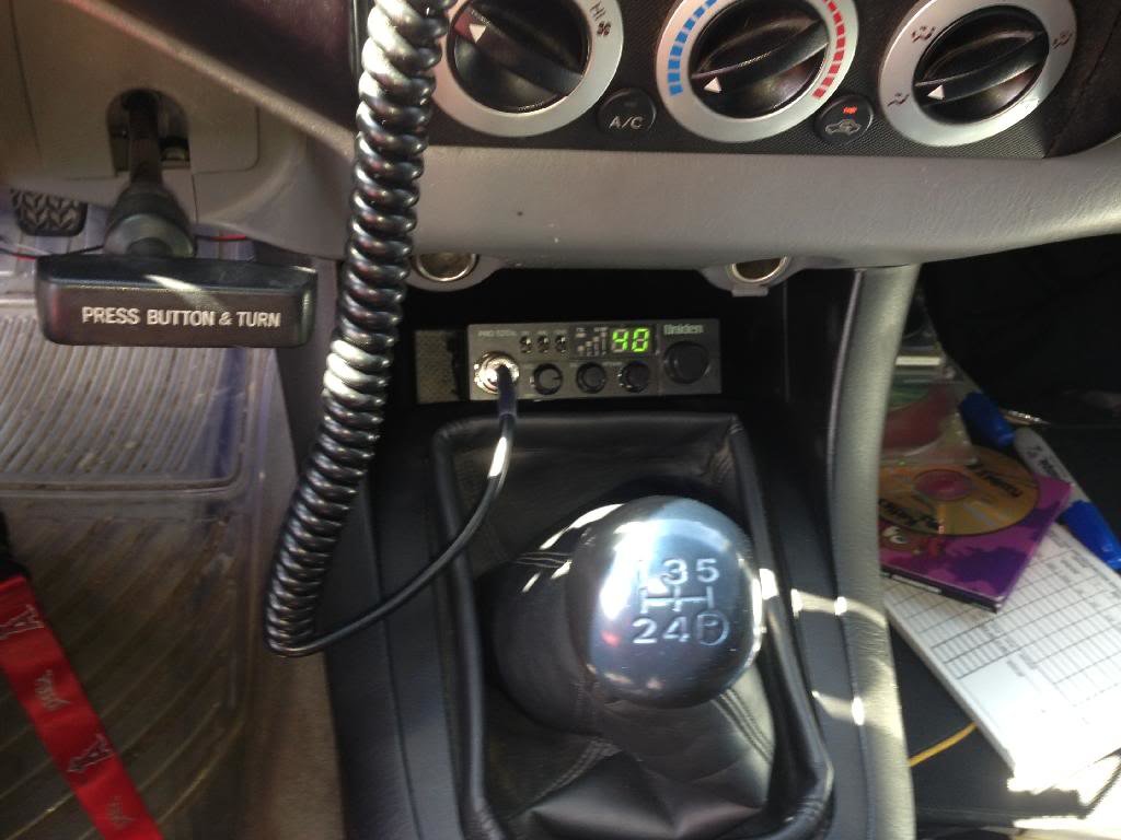

    Hey I was wondering, below your 520, how much room do you have roughly? the radio I'm looking at is about 1-1.5in longer than yours. Is there much clearance below yours? Going towards the ground of course.
  5. Jul 18, 2013 at 6:04 AM
    #145
    NetMonkey
    NetMonkey [OP] Well-Known Member
    Aug 14, 2008
    #8536
    1,734
    Geogetown, TX
    2010, 4x4, DC, off-road, shortbed, automatic
    Toytec Ultimate Lift @ 3", Mickey Thompson MTZ's 285/75/16, Moto Metal 955b, rear 2" ALL, Marlin Crawler sliders
    this pic shows how much room there is

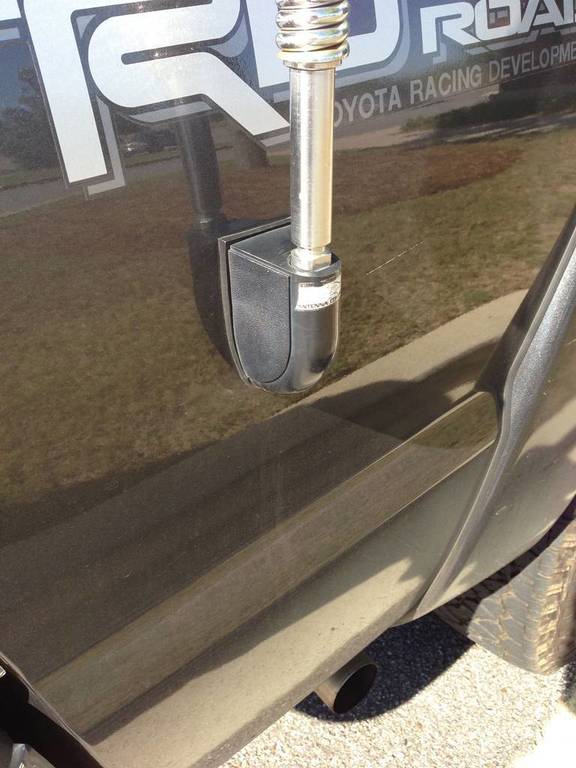

    Hey OP how is that fold over antenna adapter working? Where did you get it? I have read horrible reviews for the couple for sale on Amazon but I really need one for the parking garage at work.
  17. Sep 8, 2014 at 10:02 AM
    #157
    SManZ
    SManZ Sold the Taco in June 2020
    Sep 15, 2009
    #22817
    1,365
    Fauquier County, VA
    Current, 2020 Ford Super Duty Tremor, Previously 2010 Supercharged 4x4 Tacoma Sport 6-spd
    TRD Supercharger, King 2.5" extended travel remote-resi coilovers, OME Dakar leaf packs, King 2.5" extended travel rear shocks, Total Chaos UCAs, MBRP turndown exhaust, TRD intake, TRD Quickshifter, Goodridge SS brake lines, EBC Sport Rotors, Hawk HPS pads, TRD FJ Cruiser Special Edition 16" Anthracite Rims, Spidertrax wheel spacers, 265/75R16 A/T, Autometer oil pressure, oil temp gauges, TRD boost gauge, PLX DM-100 OBD II scanner, flexpod mounts, A-pillar gauge pods
    I have one as well, mounted to a 4' Firestik II and a stainless spring.
    I saw the negative reviews on Amazon too but also found no other good options, so I bought one.
    All the reviewers that complain about it being too hard to pull the collar up are babies with girl-child hands.
    Keep it lubricated for corrosion protection. After just 2 weeks on the truck, mine is showing rust on the insides.
    There is some play in it when in the upright position, but I can't hear it from inside the truck and the antenna stays pretty still.

    I have a standard 4' Firestik II, mounted to the same location as the OP with a bed rail bracket. My SWR on Channel 20 is 2.8-2.9. My range is a quarter mile at best. I was hoping a 4' NGP would be a magic solution.
    I found a bed rail bolt that is grounded but my SWR didn't change. It actually seems to make no difference whether the mount is grounded or not. I've checked for no continuity between the antenna/coax collar and the mount and its ok.
    Getting pretty frustrated with this setup. My next move is to run a ground from the bed down to the frame but I'm hearing the length of the ground wire can screw things up.
