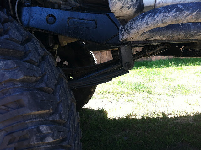

    OK Here's the shackle angle:
    As to the other questions…
    1) the kit came with studs. You'll have to source some, you'll need at least 4 more (2 per side) than a factory yota anyhow. Might as well get new ones all around. Like I said I didn't have to worry about this myself, it was included.
    2) rear driveline is the same. Had issue with the front, was told that they got away with reusing the stock…? nope. You'll have to find a front yota solid axle driveshaft, but KEEP your IFS unit around you'll need the flange off of it (solid axle DS flange little different).
    3) I DID NOT reuse the rear brakes. It's a lot of meat to stop both in terms of leverage (taller tires) and weight (it's a beast after all the mods). I did the rear disc upgrade via Trail Gear, despite all the warnings from all the "I know what I'm talking about" people on this forum and others that drum is fine and actually stops better than disc. Ignore them. They're full of crap. I mean, it MAY be true in best-case scenarios, like BRAND-NEW drums properly adjusted under controlled scenarios… but in real world use? my braking with the new setup (Kit C came with new calipers, plus the rear conversion), with no rear reservoir, I stop SO MUCH FREAKING BETTER than I used to with the drums and 33"s. for a few reasons. 1, no one actually adjusts drum brakes, let's be honest. 2, with all the off-roading the outer axle seals CONSTANTLY fail. Where does the axle fluid go to with a drum setup? right onto the drum and shoes, making them essentially useless. 3, if you do any mud or water crossings, your drums are even more useless than ever as they're full of crud and will be until you get around to cleaning them. So, do the swap. Just consider doing what else I did too, if you have a rear adjustable proportioner that's tied to the rear axle height… cut that tab and tie it all the way up. It's like dropping an anchor.
    4) No trimming up front. Axle comes true-width and they ask for 3.75" backspace, but I couldn't source that anywhere so I had to settle for 4.0"BS 17x9" wheels, meaning that under full lock my turned in wheel is a little closer to the axle. I think even with 37's I have more room. Am actually considering either hunting down a 3.5"-3.0" wheel or getting a quality spacer actually to increase my track and most importantly my tip angle some.
    Only rub I had was the rear wheel well. I don't have it bumpstopped way down, and my rear springs are sort of my weak spot right now… I had originally had Alcan custom make some springs for me back when I had a 3" lift. Well they goofed or something and the truck's rear was WAY high. Figured I could reuse them with maybe an add-a-leaf after the SAS, but… was pretty damned short. Had to add-a-leaf, a 1" block, arch the springs more, and add longer shackes, and it's STILL 1.5-2" short in the rear, even after a month of settling the front springs :-/
    Thing was at the time, I had asked Alcan to move the center pin forward about .5" to correct the rear axle's stock rear bias, so the wheel would come up center. However with 37's and all the work, it's a little too far forward, and I rub a hair on the FRONT of the rear wells. I trimmed and bent the metal down so that it doesn't cut in, the wheel will push it out as time wears on, but YMMV depending on your rear setup. I myself plan on either a NEW, properly tuned set of alcans or TG's own rear kit. Only thing is that install gets either a) expensive if you source a shop (my only option really I work too much) or b) time-consuming because you basically have to refab the entire rear to make it work.
    Totally do this, just do it right. and adjust expectations. Mine's a DD on 37's with 5.29s and a supercharger. Still a little sluggish at highway speeds though, and the gas mileage is probably like 14 at BEST. If your measurements are good and you have decent springs, it'll even ride pretty damned good too. I don't have any complaints, I think it actually rides better than it did with IFS cranked 3". Only the steering is a little wonky but you get used to it fast.
