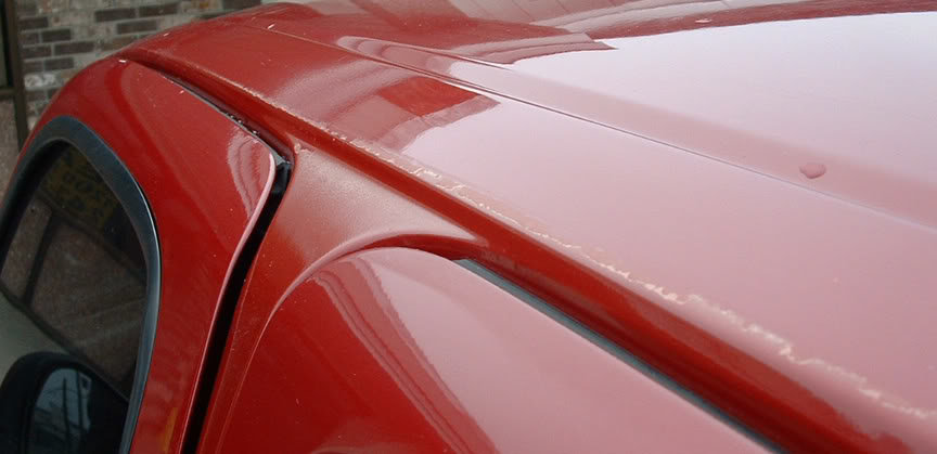

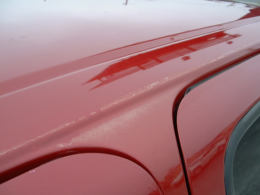

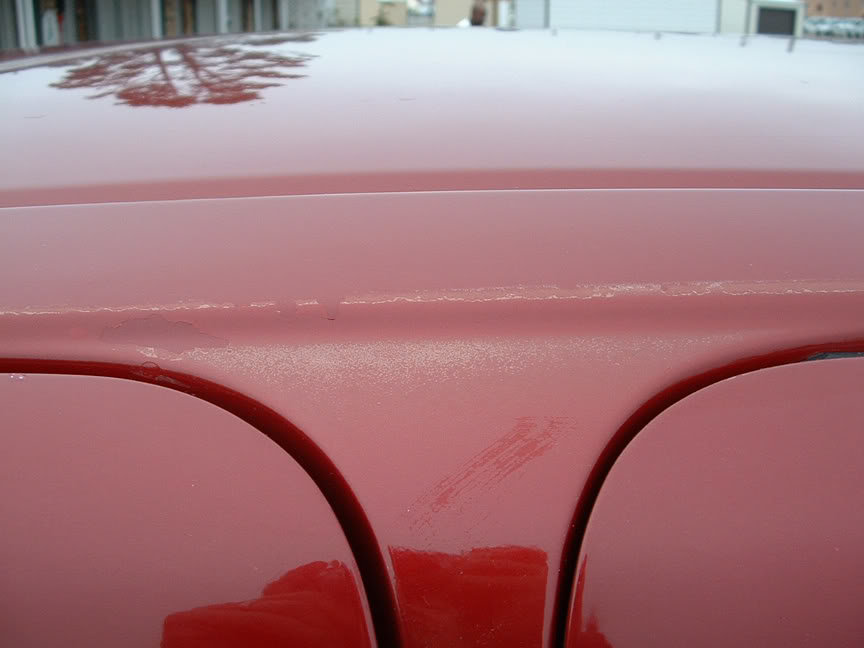

    Ah man, that sux! Here's where I'm at. Along the roof, near the door frame. Looks like I'll have to get the whole area repainted. Is there anything I can do to stop, or limit the deterioration? The rest of the truck is in good shape, but along the tops of both sets of doors, the clear coat is coming off. It's a 2002 Taco with around 150K miles.

    ^ You are gonna need a new paint job! And that small area on the 2nd pic on the bottom left looks as your truck may have been re-painted at sometime?

    I'm pretty sure it's been painted before. The GVRW is missing or painted over. We were trying to figure out my payload and/or towing capacity... If I could just get the roof painted, and have them "blend" along the pillars, it may look ok(I'm a mechanical geek, not a paint and body guy). Also, the genius that had the truck before me took the front mud flaps off. So the undersides of the doors are in bad shape too. Hmm, might be time for a whole paint job.

    A reputable painter will give you a few options, and it depends on how picky you are. You can get only the affected panels painted, but they most likely won't exactly match adjacent panels. To match adjacent panels, they must be blended. When you do that, the cost goes up significantly.
    I for one TOTALLY notice when someone just has a door, fender or hood repainted. Be it a variation in orange peel, pearl, or actual color, you can usually see the difference if you have a critical eye.
    So if you had your roof repainted, the contiguous metal that goes down between the doors might look different if you go the inexpensive route, as it is part of the same panel and would be the same color as the roof.
