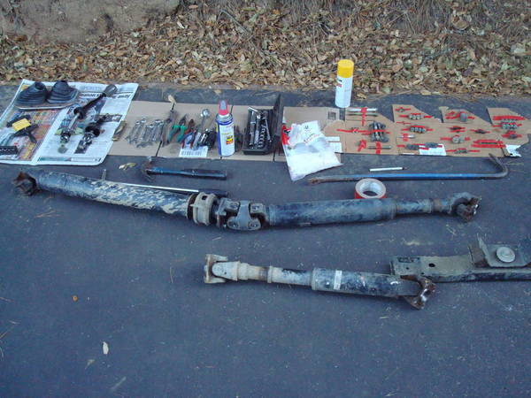

    So this is going to be my journal for the next few days.
    Background: I am attempting to replace my clutch because it is slipping if i dont feather foot the damn thing. Iv done all my suspension work myself but had never done anything like this. well needless to say I worked on it for 7 hours today with my dad. and we dont even have the transmission out yet..... Im waking up at 6 tomarow to attempt to get it out and replace the clutch and hobefully get the tranny back on before schol at 12:30. I was working my ass off so i didnt take a whole bunch of pictured but heres a couple.
    This is my pile of parts and tools
    Anyways Im feeling pretty damn overwhelmed at this point. I need encouragement. Ill have more tomarow.

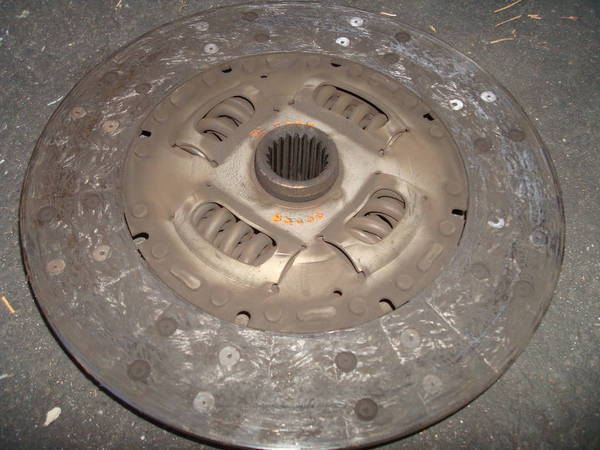

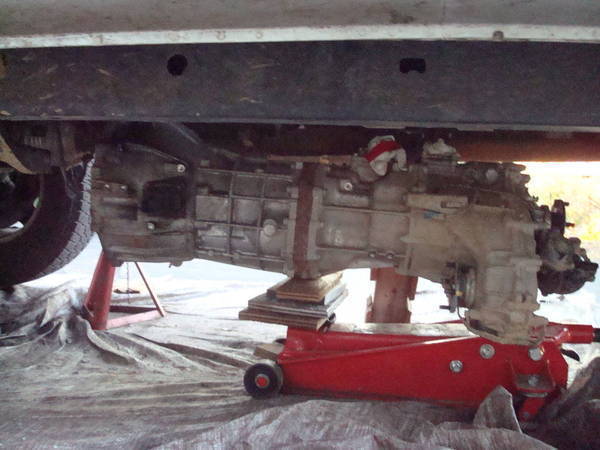

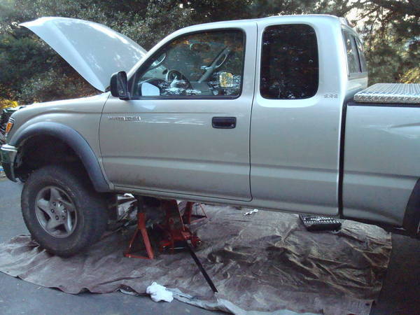

    Ok i dont know if anyone cares about this thread but heres an update.
    Day #2: spent around 4 hours in the morning working on it. Finally got the transmission out. Getting the two top bolts out took almost an hour and half by itself.
    I replaced the throw out bearing, pilot bearing, pressure plate, and clutch disk
    This is a picture of my old clutch disk that was worn down past the rivets.... no wonder I was having problems
    So I start putting everything back together tomarow and hope to have it done by tomarow night. I dont know how people say this takes 6 hours. So far iv been working on it for 11 and im still far from done.

    be carefull on reinstall of the tranny. Keep her supported and dont try to use the bolts to pull the tranny to the block. you would be surprised how easy it is to snap a lobe on the bellhousing, then youd be cutting into the money you saved.
    Dont ask how i know
