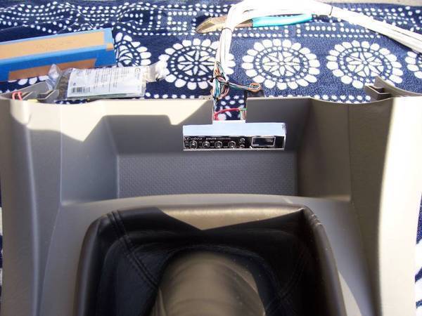

    So i got a Cobra 29 LTD Chrome last week and realized there is ABSOLUTELY no where to mount this thing without it being in the way, its too large!
    Solution:

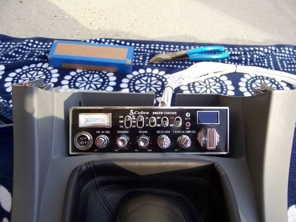

    Use Cat-5 wire and extend the face plate from the box about 5'. Took around 150 total separate solders (NEVER want to solder again after that mess!) Followed the work done by DB. (http://www.tacomaworld.com/forum/audio-video/49635-cb-radio-cobra-29-mod-mount-center-console.html)
    Then Cut out the space needed to slide the face plate into the center storage area just south of the AC controls.
    After that I was able to test fit it into the location I am going to secure it to tomorrow! So stoked on how it looks and how well its going to come out!

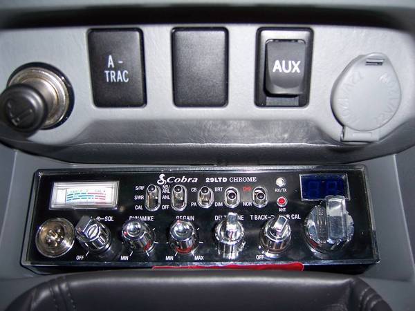

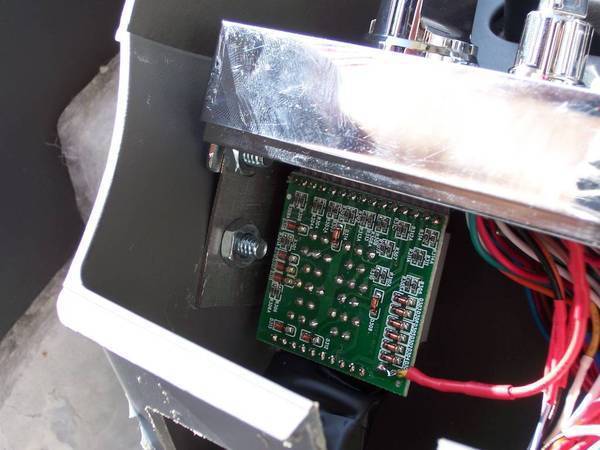

    ALL DONE! took most of the day because I wanted it to come out right! I was planning on putting a small lid on top of it to keep the wires and everything clean but couldnt figure out how to mount it!
    Here are some pictures of the final product, Let me know if anyone wants a DIY/Write-up on this. Took a ton of pictures so I could if there is any interest.
    Hope you all enjoy my enjoy work as much as I am enjoying my beer while playing with my new CB!!!
    Finished mounted in its new location:
    Box under the passanger seat. Held it down it velco!
    How the faceplate was mounting into the center console trim under the AC Control:
