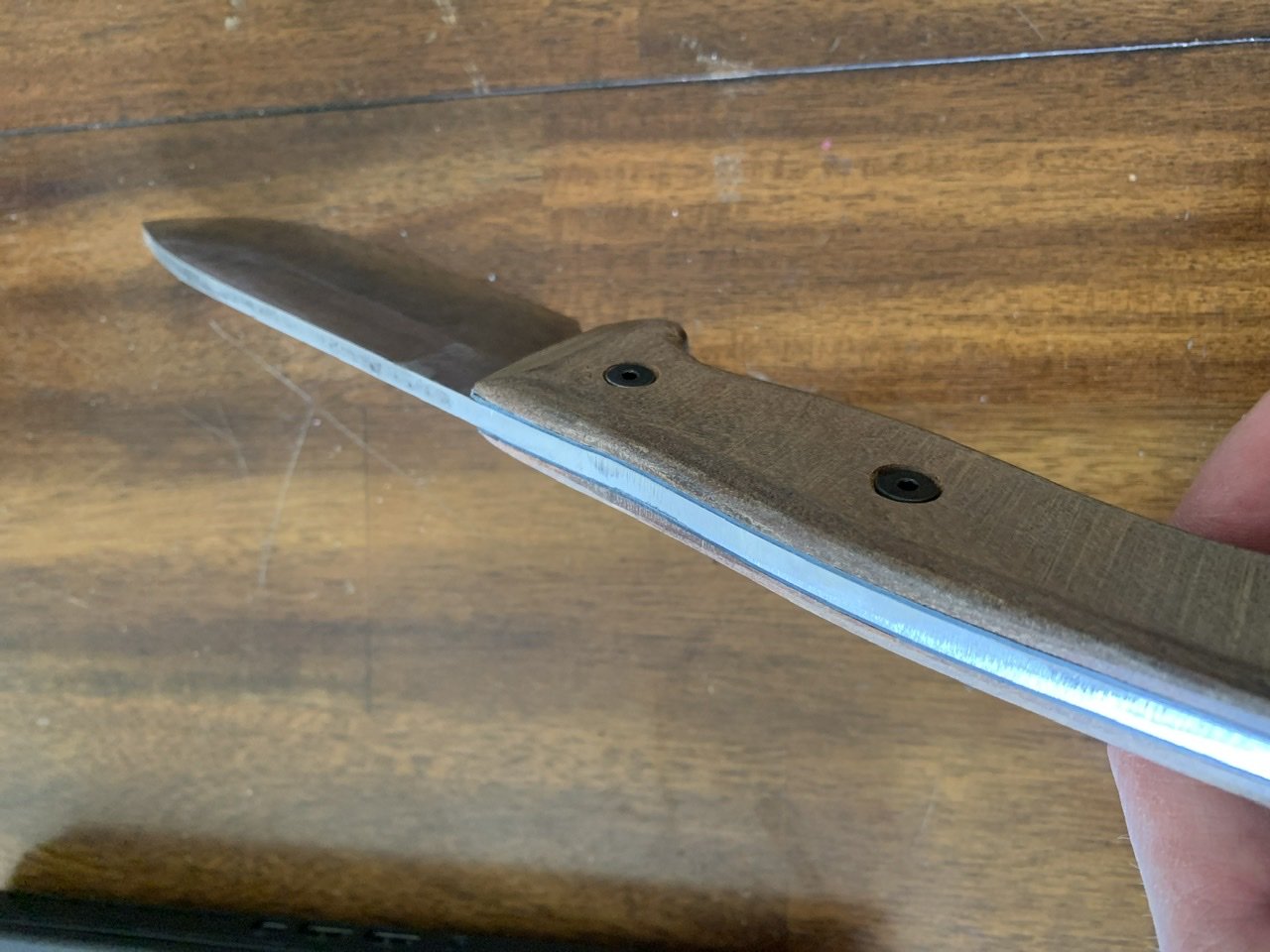

    Very nice. Way better than mine. Hopefully I get better in the next batch.
