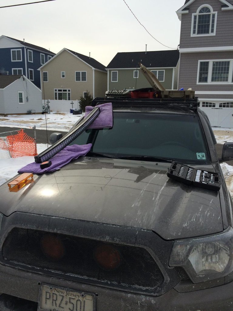

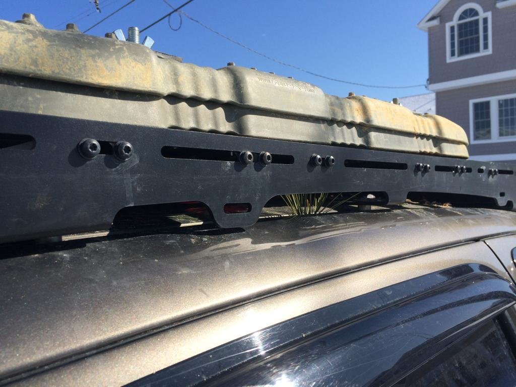

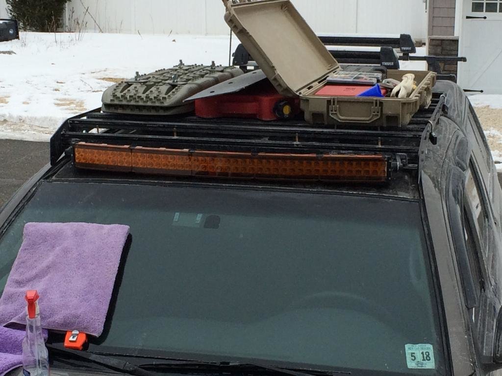

    8C3477C7-E5D0-4580-89C4-5434CDCF6DAB_zps_9bd126ad767bf42b0c80eaafab45775c6662e653.jpg
    7A970137-63C6-47CC-AF7D-B7AAEAB58C8C_zps_a9fb0388f544c724dcf436f5de5d7ff2e25a87d4.jpg

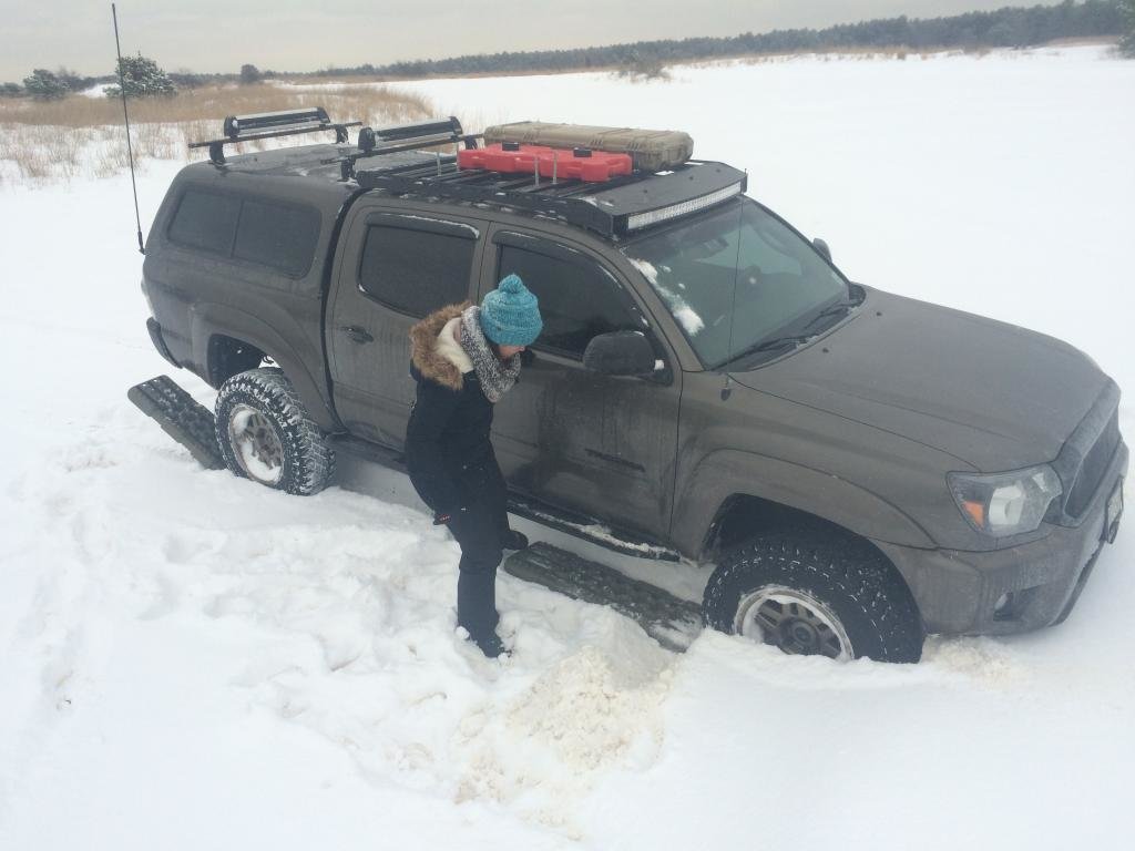

    Girlfriend setting the TREDs
    F5AB54EF-17E6-403D-B4F8-CB13E6F529CF_zps_738469e3c51f8688c12e552fefbfe88a90576f43.jpg

    How many cross bars did you order? Looks to me like 8 +1 for the fairing/light bar
  8. Mar 5, 2015 at 7:45 AM
    #28
    Chux
    Chux [OP] Pura Vida
    Oct 1, 2013
    #113652
    6,234
    NJ beaches
    2013 TRD O/R Beach Buggy
    Click on my Build
    Correct, the one for the light bar doubles to hold the fairing.

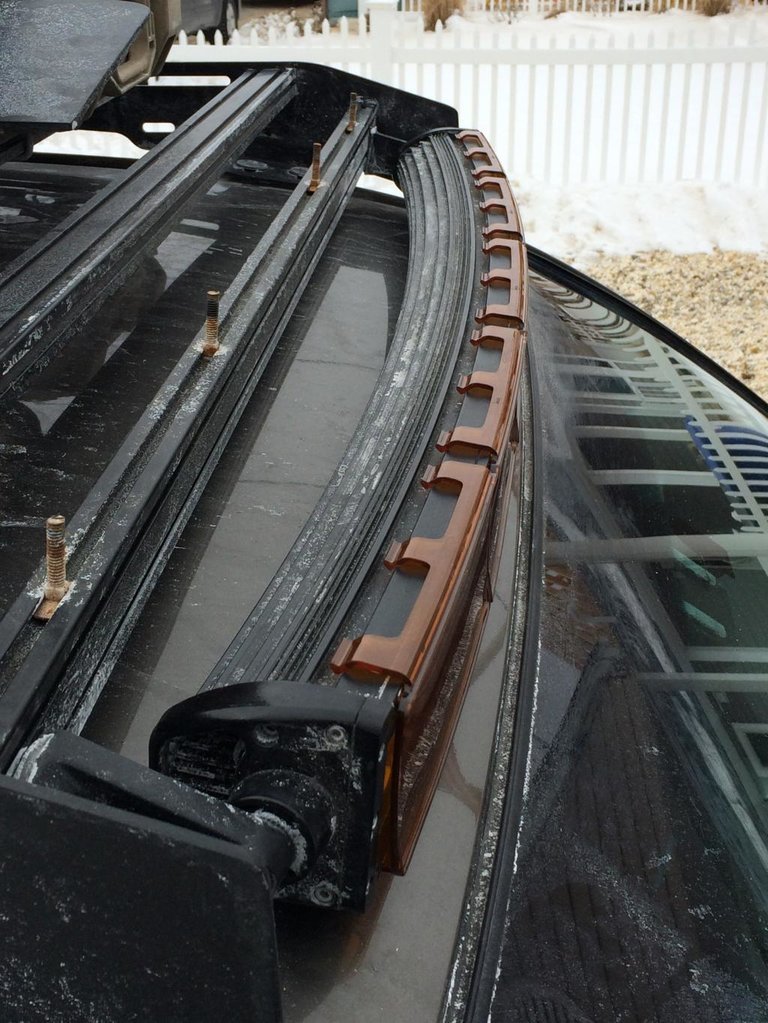

    Did you cut that plexi with a circular saw? That is talent.
    Excellent job on this.

    It really all depends on your personal needs..
    I got lucky with mine. Knowing exactly what I wanted to mount on the rack and knowing its going to live up there, I started laying out the mounts and accessories to my liking. I wanted all the forward most part of the accessories to be lined up. Given they are all different lengths with different mounts, mounted they all used different bars. I think all of the bars are mounted on to give the accessories a clean mounted look. Except the center one but I will be using it to add a bolt to for the center of the Rotopax mount, there is some rattling noise when the fuel can is empty. Basicalle the more bars you have the more options you have. I could in fact mount the same thing I have with less bars, but it wouldnt be as easy or clean.
    Thanx Dude! Yea, circular saw with grinding wheel attached. Had the table guide pulled up to just more than the thickness of the plexiglass. Doing this makes cutting anything on a curve easier.

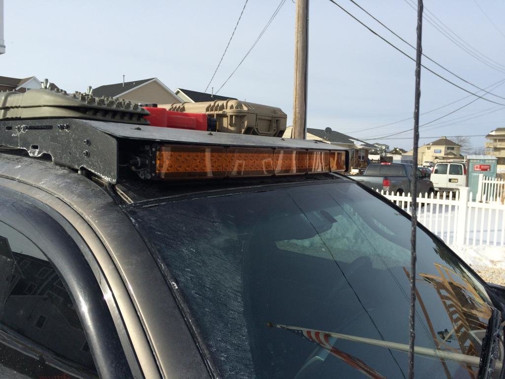

    7EBAFE98-A3D0-4CC8-8E94-837598D2FFBC_zps_906ae4d70bd9de9667c7d35c6cd2765bba1b0e19.jpg
  19. Mar 6, 2015 at 11:26 AM
    #39
    Glueman
    Glueman Yersinia pestis
    Dec 27, 2012
    #93882
    2,119
    Utah
    The Plague....
    6 inch Douche Bag lift...what else do I need?
    Nice work. Looks like a lot of fun to create a new solution for the light bar and fairing.
