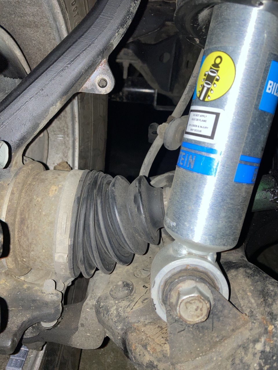

    Thanks for the pic. Did you end up sliding the outers without removing the CV-axle and filling the indent where the boot originally sits, and did it stay? What clamp did you use?

    Yep. Experienced this too on first test drive. Did you end up sliding the outers without removing the CV-axle and filling the indent where the boot originally sits, and did it stay? What clamp did you use?
