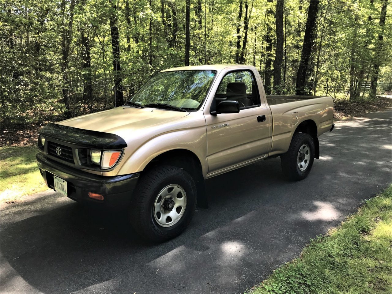

    You are exactly right, at least that's what my experience owning/operating a chain of auto parts store for 16 years taught me. Most people change their oil fairly regularly and ATF fluid from time to time, but that's about it as far as fluid changes go.
    My 96, MT, 2.7 with 415,000 trouble-free miles on it has never had manual trans/transfer case/differential fluid replaced. And all runs, shifts smoothly and perfectly quite. In fact, I wish my 2018 TRD Sport was as quite.
    I take very good care of my vehicles as the below photos demonstrate. Engine oil has been changed every 5,000 miles since new. I'm planning on changing my differential fluid soon.
