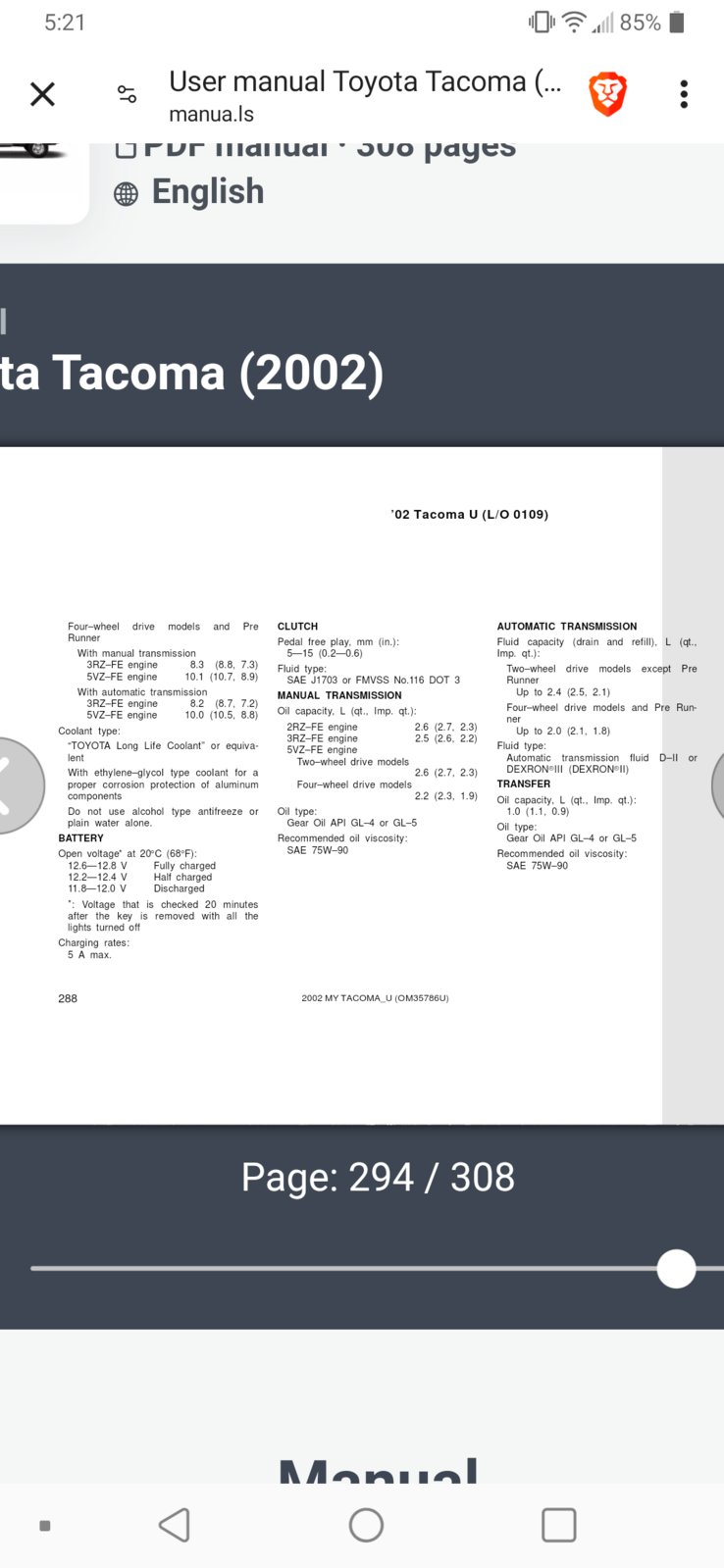

    Hi, I called the dealer and was told the 2002 prerunner takes dexron III ATF fluid. would need 4 quarts. But manual I found online says 2.0/quarts. How would I be certain?
    Also, is it better to use the conventional ATF fluid or synthetic ATF fluid? Truck has 268k miles.
    I attached the online manual.
    Thank you for your help

    I'd use Toyota ATF if possible. Good stuff, kinda pricy, but either way just get the right spec. Ok, so do what the manual says for a drain and refill. So warm up the fluid if you can just a bit. It will flow a bit better. Drain. (I start the car when the fluid stops for just a few seconds and shift thru the gears for just a second in each position then kill the motor. This gets a bit more fluid out. (If you don't feel comfortable w/ that then skip and you'll be fine.)
    Refill per the manual. You check the fluid w/ the engine running. Start it, cycle the shifter thru P R N D 2 L a few times, leaving it in each position for a few seconds. Leave it running and check the dipstick. If it's cold, fill it to the cold line. Or add as needed, but don't overfill and you are good. check it a few times after driving it a bit to be sure you got it.
