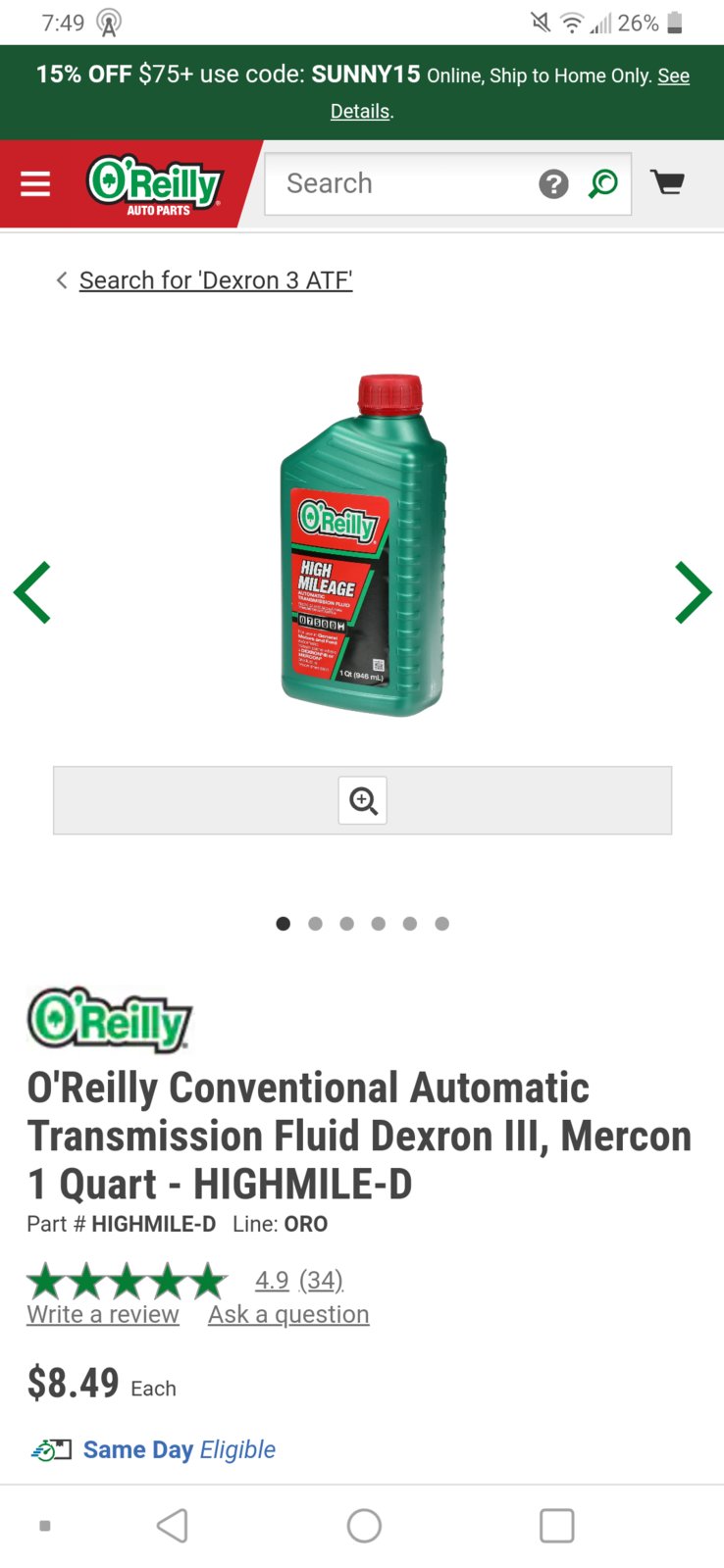

    Hi controlcar and others,
    Would using synthetic dexron III ATF fluid be okay? I want to extend the life of the transmission as much as possible.
    I assume using synthetic ATF fluid would extended the transmission as the ATF fluid will not breakdown as easy as conventional ATF fluid by heat.
    Thank you for any help you can give.

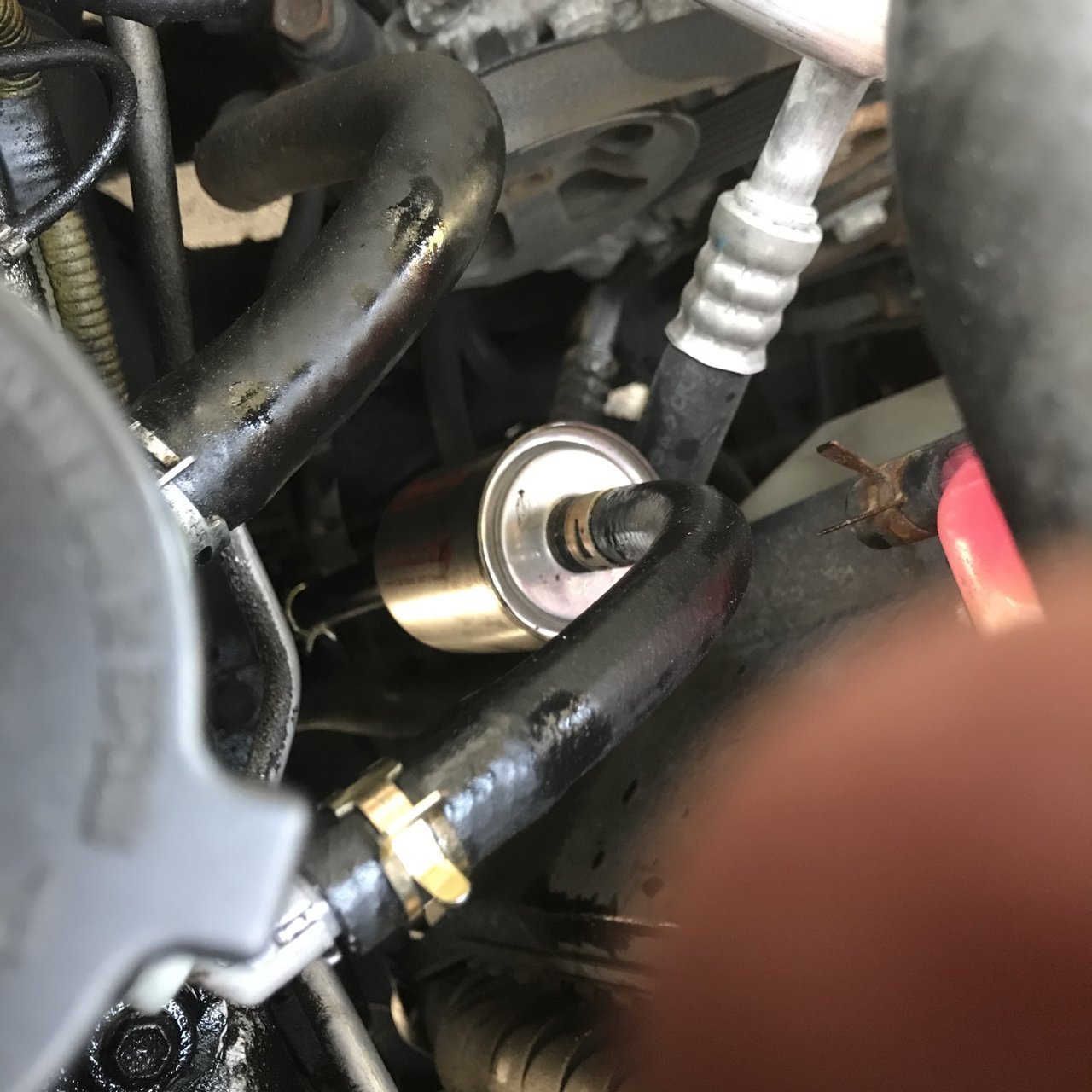

    I use that same pump. But when doing the PS fluid I do the following
    1)plug input line to PS reservoir
    2)Hook pump input line to PS return line
    3)Put output line from pump in a pop bottle.
    When I turn the pump on it sucks the fluid from the reservoir all the way thru the system. I keep adding new fluid to the resivoir until the fluid that is being sucked out by the pump is clean and clear.
    This way you replace all the fluid. Not just whats in the reservoir.
    And I also have a magnefine filter in the return line as well.
    And yes, someone else who agrees the transmission pan filter is a meant to catch boulders and an inline filter is the way to go :thumbsup::thumbsup::thumbsup:

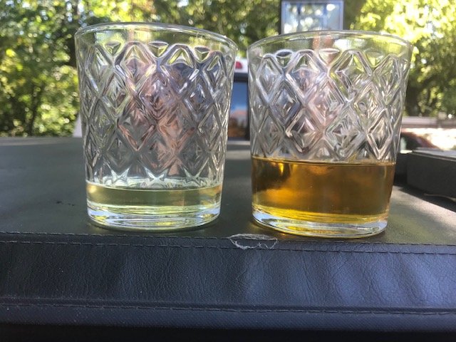

    And for brake fluid... Its hygroscopic (absorbs water right from the air) . That's why is says never use from an open bottle. As the percentage of water increase the boiling point decreases. And so does the possibility of corrosion of brake components. With new ABS components being in the order of thousands of $ this is something you want to prevent. Since i do my own summer/winter tire swaps I purge all the old fluid every 3 years at the same time since wheels are off. I have stainless speed bleeder screws so i can do it myself without needing another person. This is a time dependent activity, not mileage based.
    http://www.speedbleeder.com/
    This is new vs 3 year old fluid (not vodka vs scotch :rofl:)

    Not so sure about using an in-line filter on the PS.
    It makes since on a mostly metal parts grinding against each other in a tranny.
    But for a power steering its really just valves and passages, if it were a mesh filter, that would be different.
    So me thinks best for PS is just change the fluid every couple years........or half like I do every year.

    From the following article
    https://www.motortrend.com/how-to/129-1002-automatic-transmission-and-power-steering-filters/
    "We also installed a Magnefine into the return line of the rack and pinion steering and ran it for 552 miles before resampling the oil. The ISO code dropped from a dirty 20/17/12 to a clean 17/15/12. Similarly, when installed into the long-overdue-for-an-oil-change power steering of our '86 test rig, it dropped the code from a filthy 21/18/14 to 18/16/13 in just 289 miles."
    That first # is particles of 4 micron size, second is 6 micron and third is 14 micron. Might not seem like a drop from 21 to 18 is a lot but the count for 21 is 10,000 to 20,000 particles and 18 is 1,250 to 2,500.
    The counts are base on 2 raised to the # power so 2^21 is of course much larger than 2^18

    Just as long as Dextron III u good
    My 96 taco says Dextron II but D III is now the option bc D.II no longer available
    Think I remember reading the same on the qt container
