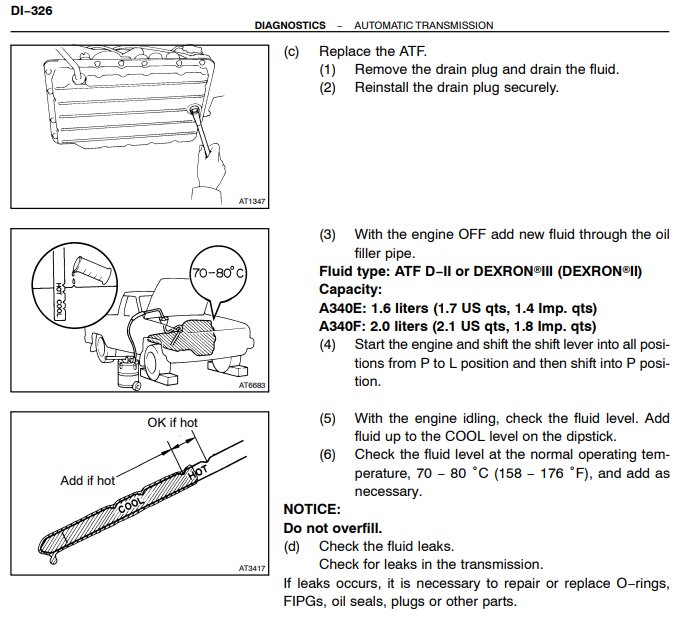

    Hello,
    I did NOT Intend to cause friction on The thread. I found it since I had questions about transmission fluid, though the truck i have has an automatic tranny. I have tried YouTube, but it's for other Tacoma's In regard to ATF transmission. I am new to truck maintenance.
    Can a 2002 4cyl Tacoma prerunner SR5 2.7l refill the transmission fluid through the dipstick area once it is drained? Just wanted to Confirm it can be done.
    time623 likes this.
  10. Apr 19, 2024 at 12:10 PM
    #70
    time623
    time623 Well-Known Member
    Jun 26, 2015
    #158230
    3,479
    James
    AZ
    1995.5 White Tacoma 4x4
    You're good, you didn't do anything wrong at all.
    I don't have an auto so I can't confirm exactly, but here's the owners manual's guide to changing atf fluid
    Hope it helps
    JoeDavola[QUOTED] likes this.

  12. Apr 19, 2024 at 12:17 PM
    #72
    O'Silver_Taco
    O'Silver_Taco Well-Known Member
    Aug 26, 2021
    #375390
    4,202
    MD
    98 Dlx Sr5 ext AT Rwd
    3rz to 2Rz bebuilt block and new heads
    Sure you can, you just need to find a long slender funnel that'll fit in the mouth of that tube...
    I actually use a long lower funnel.....with another med long above that....
    the upper one just catches/ rests on the fuel lines..
    Fill it super slow so you dont have fluid back up the tube and leak out at bottom of the low funnel..
    how do think the fluid got in there in the first place....
    that pump comes with a long rigid straw tube that pulls it right out....
    have to manipulate that tube to get to the bottom of the pan...
    I'm really anal about the fluids..... mine are crystal clear....
    except the Dot3.....that ambers pretty quick......especially with the proportion valve recirculation....
    all those who hate old thread jumpers....can move to North Korea.....pretty sure they got dissent tamped down there....might even thrive there.....
