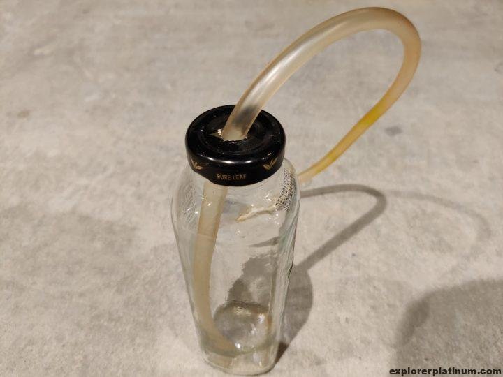

    Bleeding/flushing brakes on non abs is a breeze.......you can make a catch can/anti back-fill can out of a salsa jar....
    How To: Make a DIY One-Person Brake Bleeding Bottle – Explorer Platinum

    When I did my 2015 i bought 3 of the normal sized bottles (12 ounce ?)
    You will need a helper.
    Start from farthest from master cylinder and work to closest (passenger rear , driver rear, passenger front, driver front)
    Don't let master run dry.

    I used about 32oz flushing my brakes. Can be done alone with a vacuum brake bleeder. $25 at harbor freight
    I did mine today and every single brake bleeder valve was jammed full of dirt. Just be aware if you crack it open and nothing comes out, its probably clogged and you'll have to fully remove the valve, plug the hole it came out of, and clean it out.
