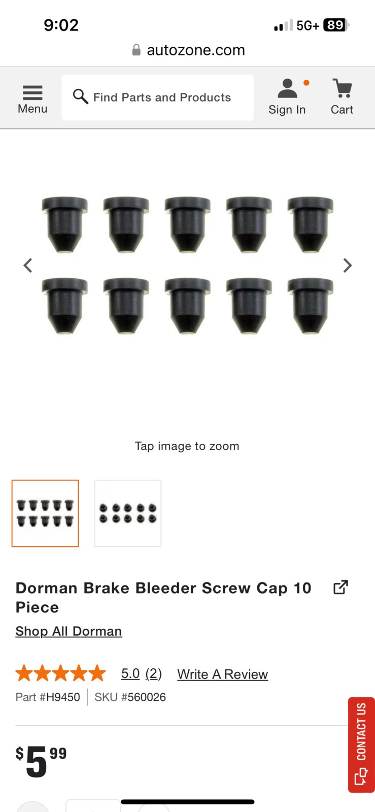

    Mine may have come on my stainless speed bleeders. But since these rubber caps (like the ones for zerk fitting as well) have been out there forever I would think after your many vehicles vehicles you would have added them after just one clogged up bleeder screw. This is an 18 pack but you can get 60 packs if you have a lot of cars/bikes etc...
    So note to all. If you don't have them already spend the couple of $'s and get them. And its so cheap you can get spares in case one dries up and falls off or just gets lost.

    All new vehicles come with them in one form or another. They do get old and dry rot and fall off or a lazy tech might not put them back but every single vehicle came with caps from the factory. They keep the dirt and mud out of the bleeders. If you're missing them you can buy a 50 pack for like $10.

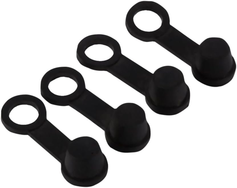

    Those sound interesting. Let me know if you can locate them. I don't need them since my bleeders are stainless steel but i can pass on the info...
    I have seen the ones that have a retaining strap thingy to keep them from getting lost.

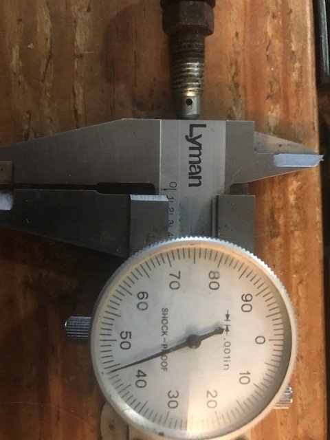

    For those throwing out brake pressure as say 2000 psi and thinking this would blow out any blockage, you are neglecting the si (square inch part)
    I dug up a old bleeder screw. The diameter of the bleed hole at the bottom was 0.045 inches.
    That works out to an area of 0.0015904 sq/in
    Since according to pascals law given the same pressure the force is proportional to area.
    So the actual force applied to that tiny little hole is max of 3.18 lbs (not 2000).
    And since normal (not panic) brake pressure is 800-1200 its probably half of that.
    That's never going to do the job if its totally blocked.
    Since pressure equals force per unit area, then it follows that
    F1/A1 = F2/A2
    2000/1=3.1/0.0015904
    https://www.grc.nasa.gov/www/k-12/WindTunnel/Activities/Pascals_principle.html
    I knew my university physics text book would come in handy someday:thumbsup:

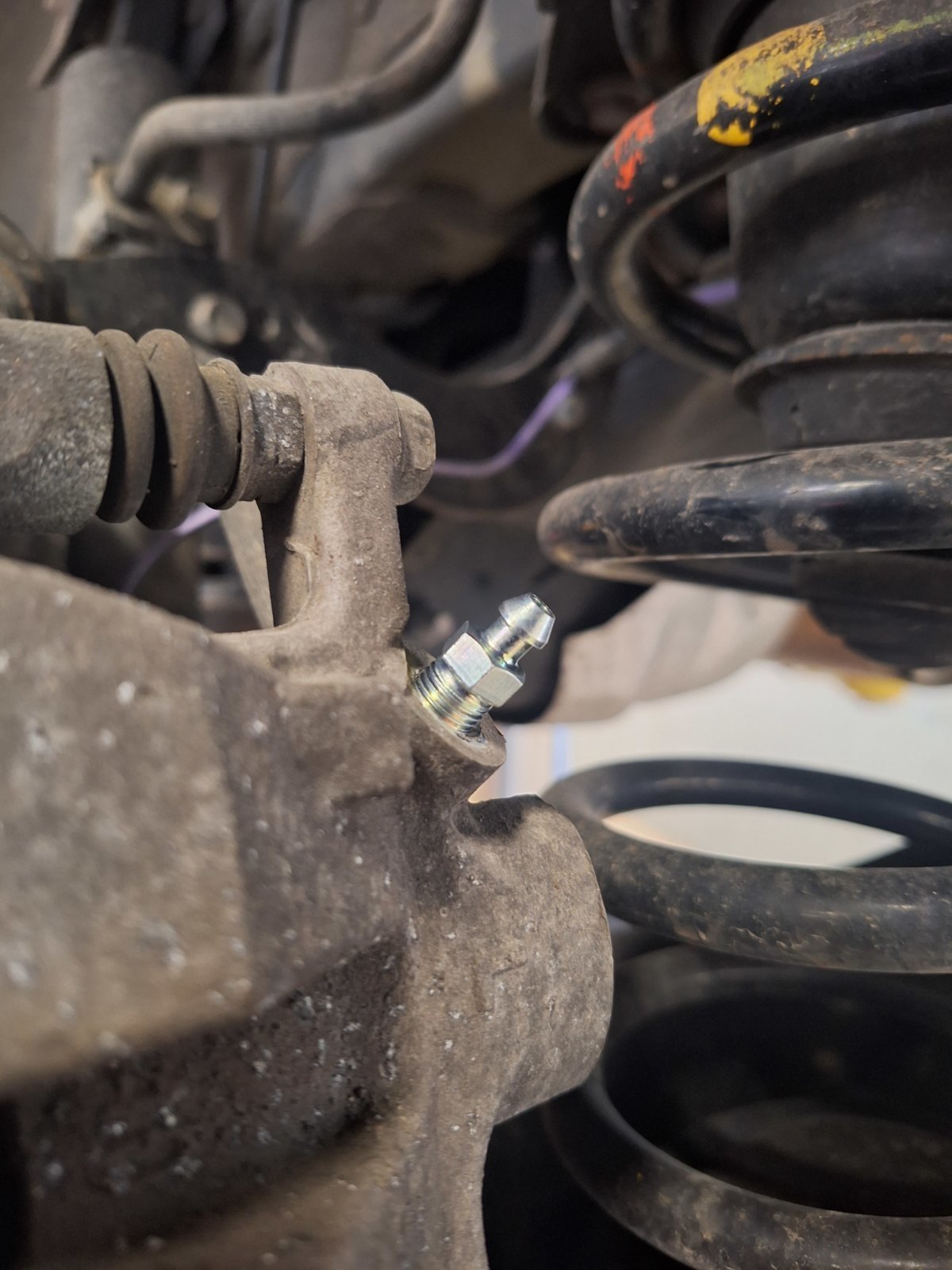

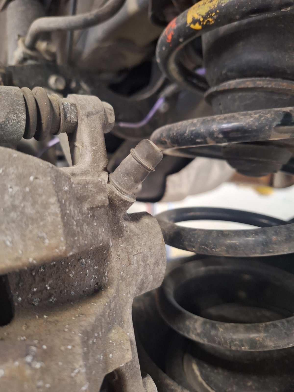

    Update I sorta found them. 19 Highlander rear caliper. Unfortunately, Toyota doesn't seem to sell them separately from what I can find but here are a couple of pictures. They were on a 10mm bleeder but test fitting they seemed to fit on an 8mm bleeder just fine. It may need some trimming vertically depending on bleeder protrusion height.

    Is that one piece or two? Just looks like there is a dividing line between the cap and sleeve?
