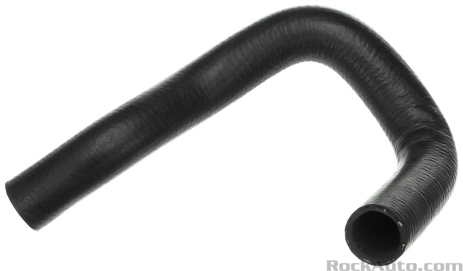

    You can purchase properly molded as in already formed in the right shape from many aftermarket suppliers. Just un-clamp reinstall and thats it.
    I much prefer the original style constant tension spring style band clamps over the worm gear kind.

    You don't need to mold/shape the hoses. If you by the direct replacements they are already shaped to fit just like the originals.
    An example of molded upper rad hose

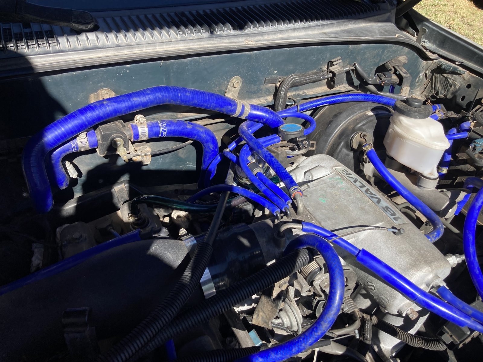

    Yeah there's a number of fluid hoses that run to/accross the back of the engine.
    the 2 heater hoses, the throttle body hose off the heater hose, and the egr coolant hose if yours has one.
    thats like 5 hoses counting the one from throttle body to ect sensor valve on back of the head...

    Are those silicone hoses or just blue?
    And note in his picture, some carry coolant and some are just vacuum hoses.
