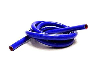

    Everything in there is silicone.....
    except for the wierd squiggly one from the heater supply hose to egr valve.....that one I left black oem...
    If any of those bust going down the road even tho they're small.....you'd be walking....
    The blue allows to easily see any cracks/flaws as they age...
    Prices have sky rocketed on silicone stuff last couple years......sooo, not everyone's cup of tea.....
    those 3 pretty blue heater hoses use to be in the $70 range.......now they're almost $150....HTP...

    Thats probably why those HTP heater hoses are so expensive....
    they're not just silicone....they have a liner....
    makes me wonder what the oem rubber ones cost...probably not cheap either...
    I would never buy the two main radiator hoses in silicone......they may not even last as long as oem or gates....
    I just get the gates from Orielly's........the radiator's top hot one I would replace every 5 yrs.......kinda pricey $28ish...
    All non lined silicone can only be used for vac lines....
    Any fluid ones need to be braided and have a liner....
    And the pcv or any vent line must be fuel resistant.......pure silicone will just swell and soften.....and dang sure cant use butyl......I used snow mobile 5/16" clear blue fuel line for this one........$8 for 10'....
    Replacing fluid lines should be like LBJ's.....worth the effort...
    especially the braided ones..

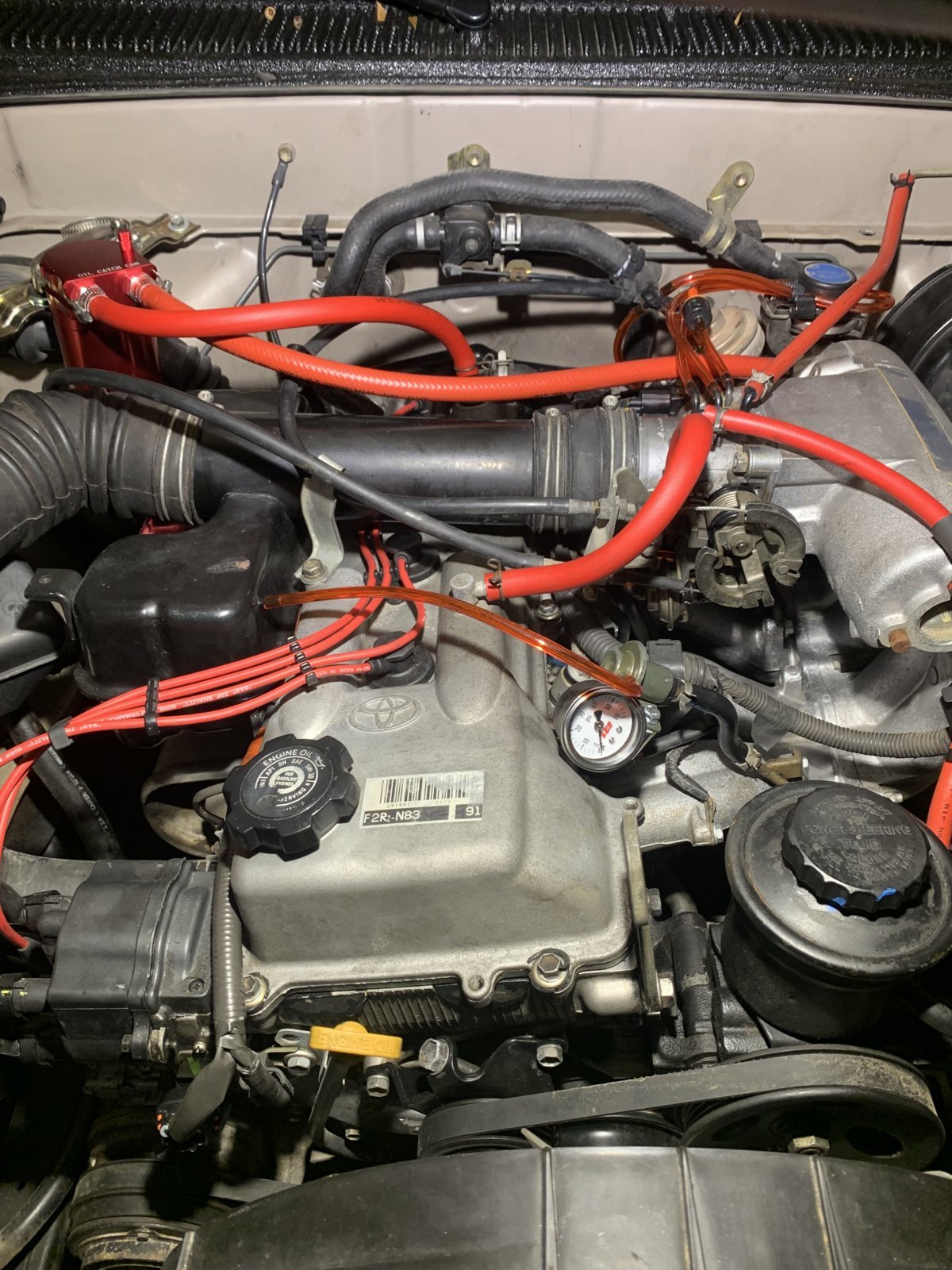

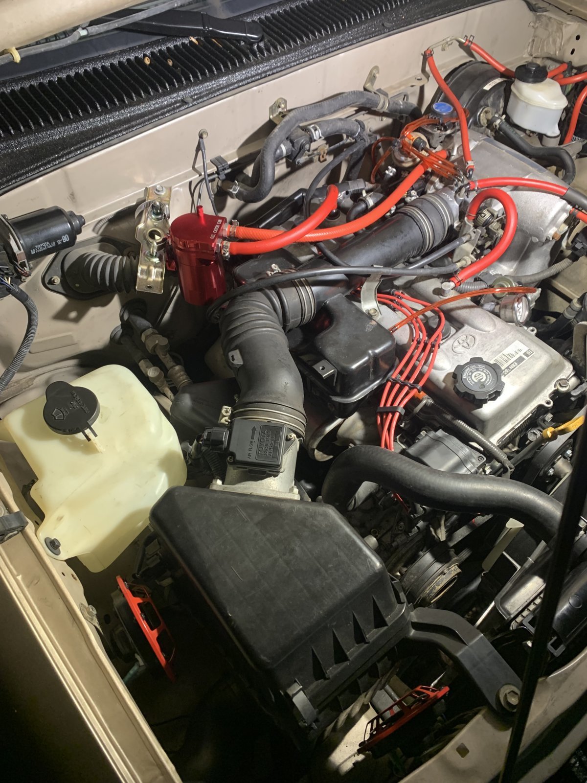

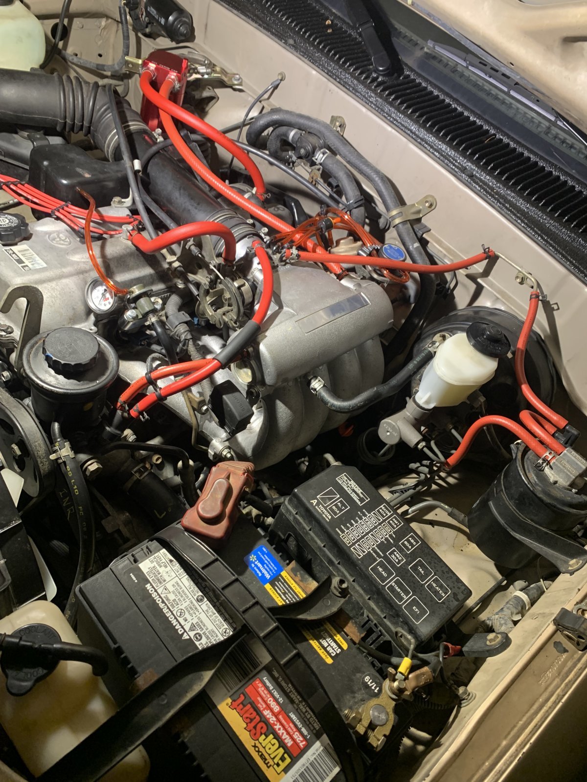

    Clock Volt meter/LSPV Delete/Hyundai 16’s/FP gauge/after 9months of wrenching ZERO oil leaks
    I’d wished i knew about the Amazon kit Time posted b4 I did mine
    I went to several old school hardware stores
    Result:

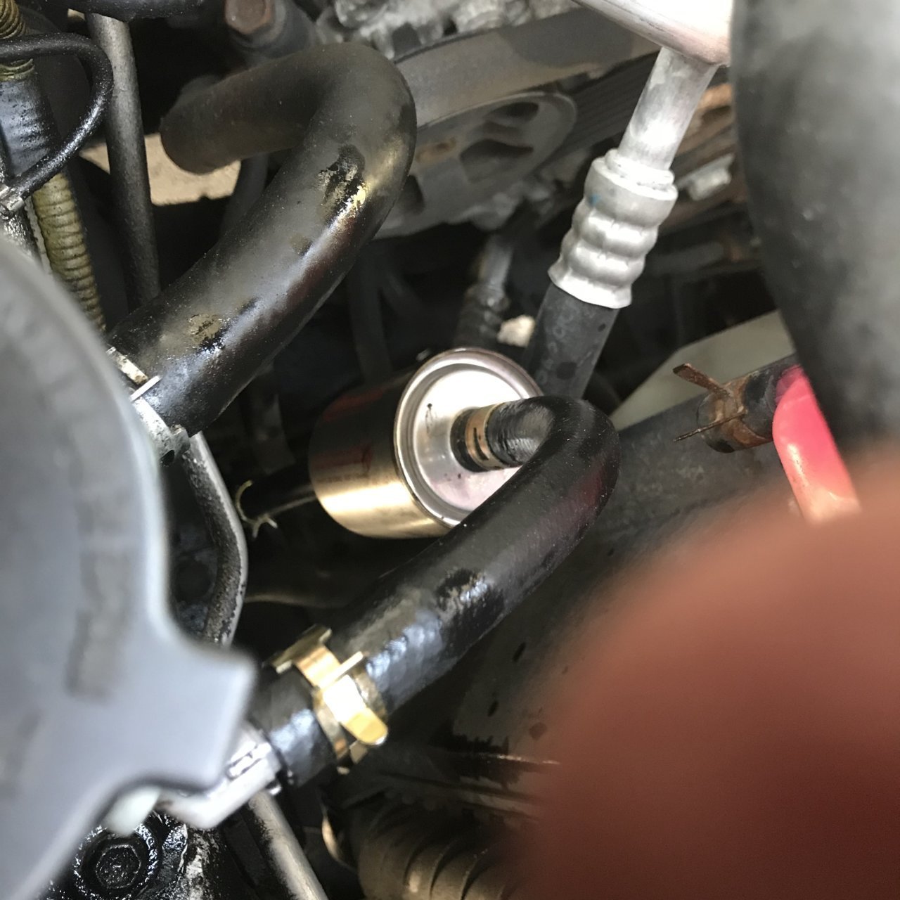

    That will do it. And when that runs out you now know you can substitute one of the later version of Dexron.
    There are two ways to replace the fluid. Some just use a Turkey Baster to draw the old fluid out of the reservoir and add some fresh. Then run / shut off and repeat.
    My method is more involved but does a complete fluid replacement.
    I block of the return port on the PS reservoir (brassy looking band clamp lower left in pic is where it enters) I use the red silicone block off plugs show below. Have them in different sizes an colors and use them to plug vacuum ports and even cover up exposed bolt thread to prevent corrosion.
    Then attach the cheap 12 volt pump to the return line and put pump output line in a container.
    When i turn on the pump it draws the fluid from reservoir all the way thru the PS system , thru the pump and out. Maybe 10 minutes in total.
    I just keep adding fresh PS fluid until what comes out on the pump end is fresh.
    The can shaped object is a Magnefine PS filter I added
