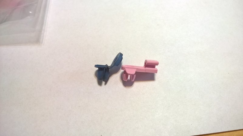

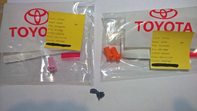

    Sure are a lot of threads about damn doors not locking or unlocking LOL. Well I just joined the club with my 1999 with an aftermarket security/door lock system put in by the original owner. The passenger side wouldn't unlock without the key in the outside lock. It would lock again using manual or electric. I popped the door panel and sprayed a bit of lube on the suspect parts. NOW it was unlocked ONLY - LOL. Time to dig deeper.
    Since the window guide has a shield that obscures the view and physical access of the rods and levers that control the locking/opening/etc. I removed the 1 bolt and the single nut that hold it in place. If you don't move the metal window guide out of the way you will be at a deadend because everything is covered up - most threads fail to mention this is pretty essential. The flexible rubber window track allowed me to push the shield out of the way and I saw that the ingenious but evil plastic rod keeper and the bottom of the manual door lock rod was broken.
    I ordered replacements from the dealer for delivery tomorrow. I say replacements because the choices were 'orange' or 'pink' as the only description for the plastic keepers and the one that was broken on my truck was a light blue or purple from the little bits of it that were left on the rod and lever. So I ordered both and hope one of them fits.
    Since the electric door locks were aftermarket it is possible they broke the original keeper and replaced it with 'one that fit' from their own toolbox.
    If the actual fixing has any surprises I'll post an update.
    Update: Door lock fix ended up being very simple. I also figured out why the dealer replacement parts were pink or orange instead of the light blue of the broken bits left on the rod. It's because they are not the same part. The factory uses a simpler rod keeper that has more of a universal fit. It is unlikely you could reinstall the original in your driveway without a bunch of unnecessary labor. The replacements were mirror images of each other and the colors just make it easier to identify lefty from righty. Their design is the common rotate and snap rod keepers found in Toyota doors. Both colors are in a single door assembly so I bought a couple of each to make sure to have them handy. About $3.50. Even though they are dimensional exact mirror images they have a slightly different price LOL. I attached pictures for your viewing pleasure.
