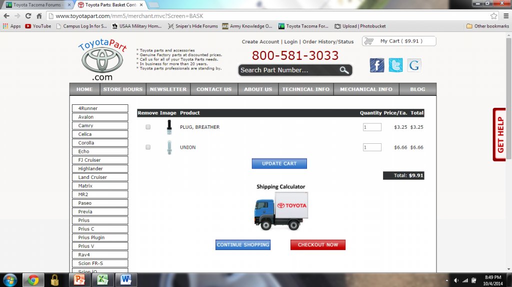

    Why cant u just run a hose off the breather up to the rear compartment?

    The reason the stock 'breather' causes water/mud to get into the differential is not where it is located (on the diff), but is because it is NOT a breather, but rather a one way check valve vent.
    A true breather (as Toyota uses on the front diff) will prevent a vacuum condition which can suck muddy water into the diff through the axle seals. This happens when you dunk a hot diff into water... happened to me when my truck was just 6 months old... and never again since I did the mod, shown on page one of this thread.
    Being a true breather (2 way gas/air flow), it needs to be up high, above any water...
    The stock breather is not where water gets into the diff unless the check valve inside is stuck.
