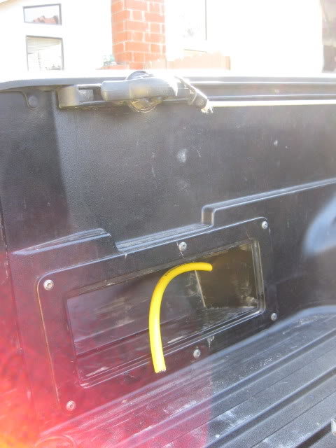

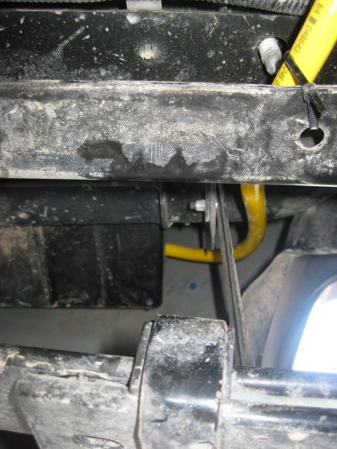

    Hi Johnny, no, not at all... see the first page of this thread where I show every step... wait, I will show a couple right here. See the zip ties to secure the hose?
    This is the view from below, see the storage box square shape and the tube going in, right above the springs?

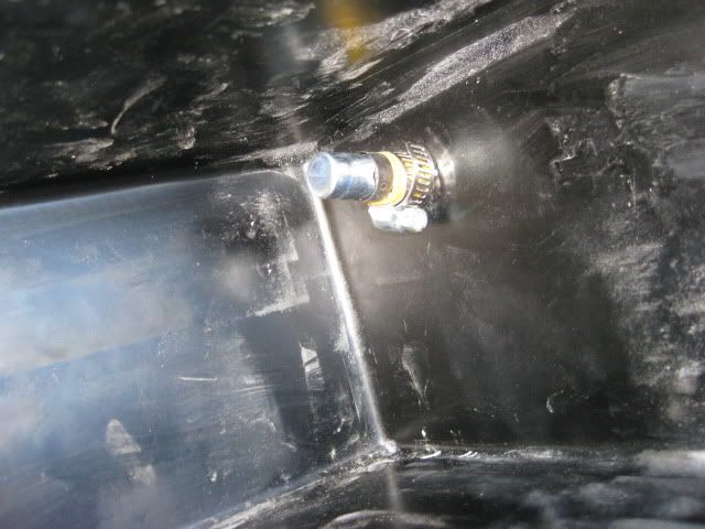

    Here is the other side, with the tube coming out...

    Brewster, MA
    Thanks for the reply, so you were able to get a drill in there?
    And the hose just sits in there?

    Ontario
    Double cab SR5 4x4
    I removed the cubby via the hex bolts. Then I drilled my hole, cut the hose so it would fit flush and then have the breather inside the cubby. ill see if I have pics
    EDIT: found the pic i was looking for in the OP

    '13 Taco DC OR 3" lift stock rims on 33s
    I can fit my drill in the compartment but its much easier to take it out and drill it.
    I also add another hose clamp to the other side of the compartment so the hose wont move anywhere. Not necessary but might as well lol
