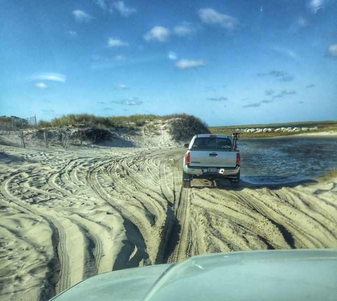

    Glad I did mine last week. Tide came in and had us forging about 18" of water to get back on asphalt. IMG_4681.jpg

    Hope you went through a car wash with underside sprays... Nice photo!

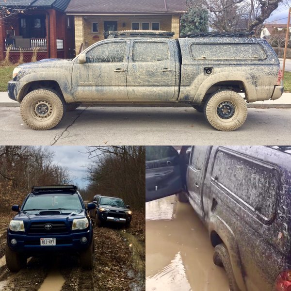

    Will def be doing this after worrying from last weekend FullSizeRender 2.jpg

    Check the diff oil! If milky, replace!!! "Do the mod... DO IT NOW!" (in Arnold's voice)
