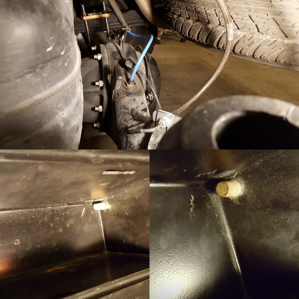

    Done and done. My Father's Day present was hiding from my kids long enough to do this mod.
    I was a bit delayed, I had to reorder the parts. The 50 pound beast I decided to share my house with (Portuguese Water Dog) decided that the breather was just a delicious snack. Never a dull moment.
    Thanks again for the write up

    Did mine today (breather to rear cubby in bed). Worked out well.. :)

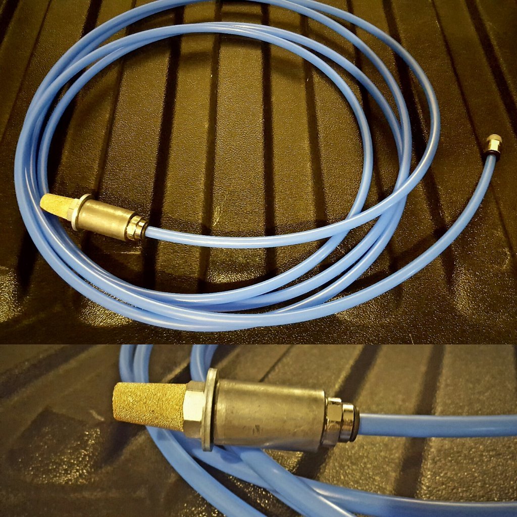

    Very nicely done. I think the sintered filter is the way to go. Where did you source the parts?

    That looks good what is it and where did you get it?
