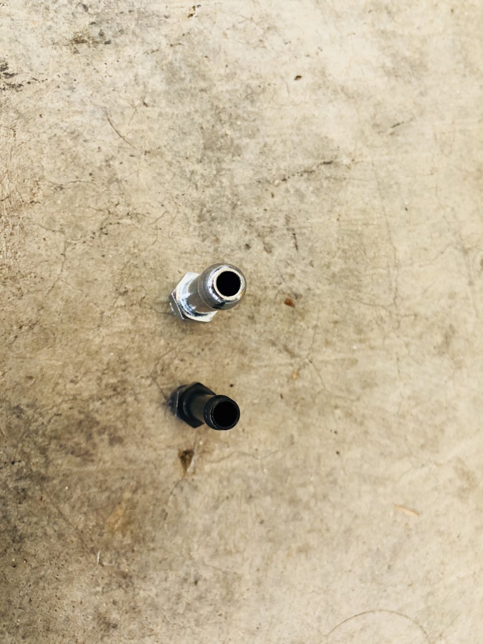

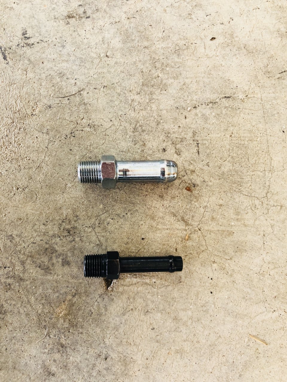

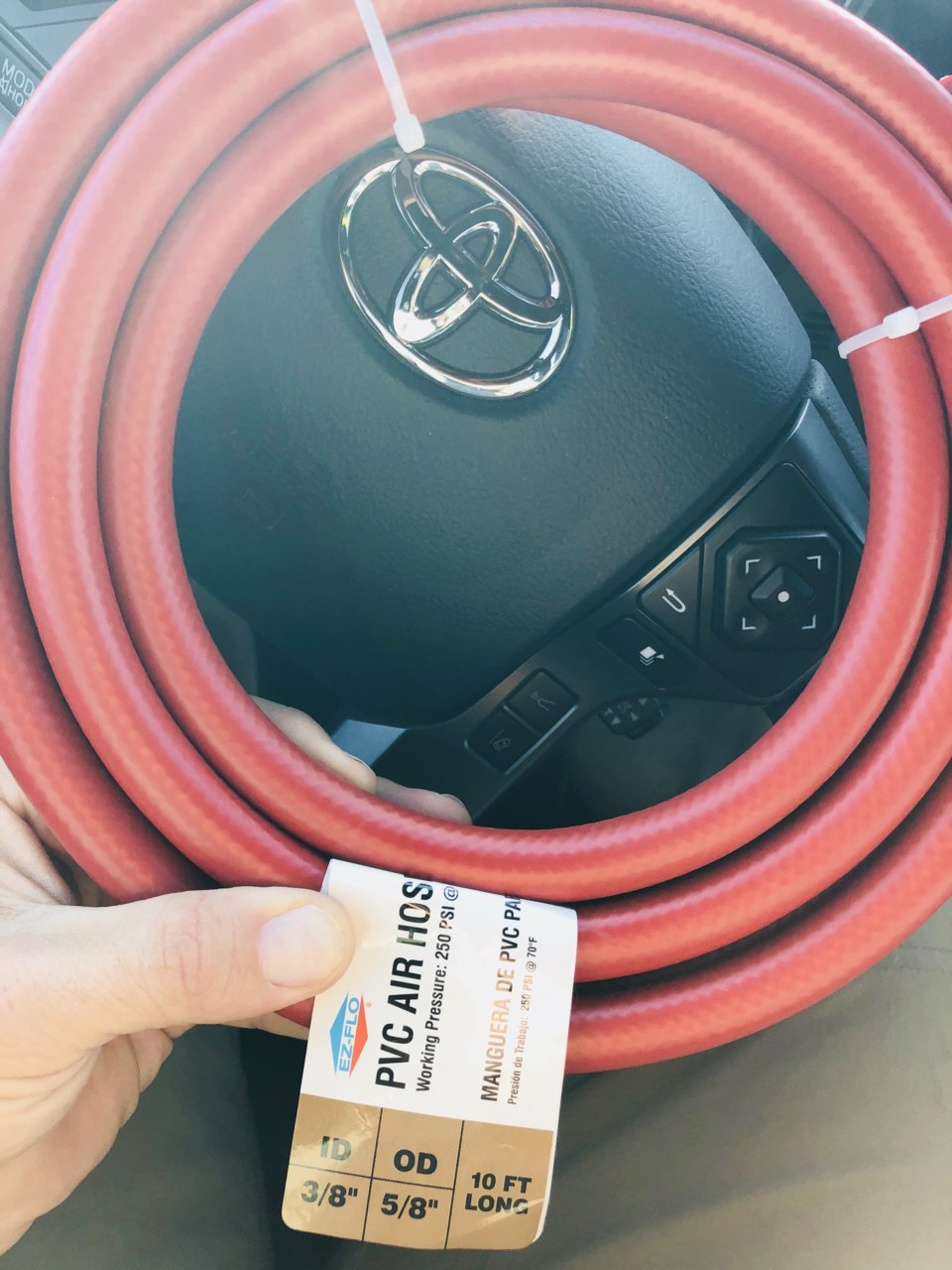

    Is this hose the same?

    Way to big

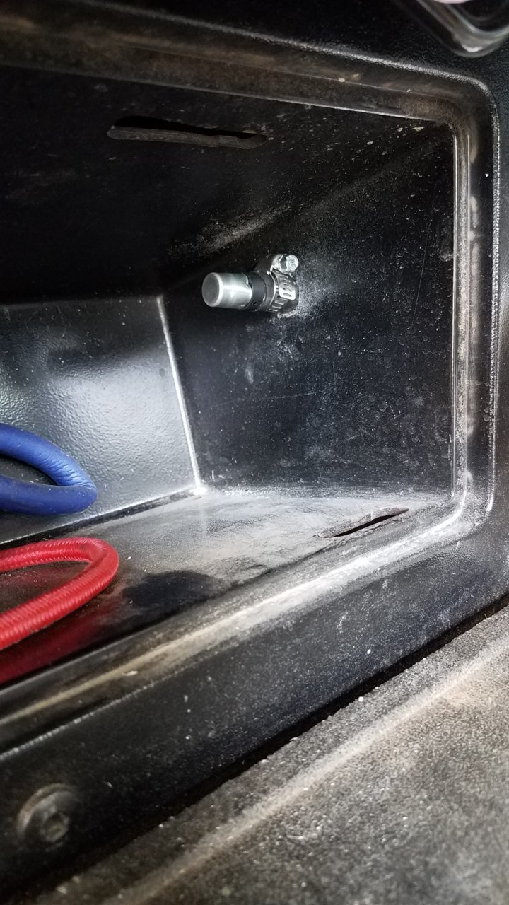

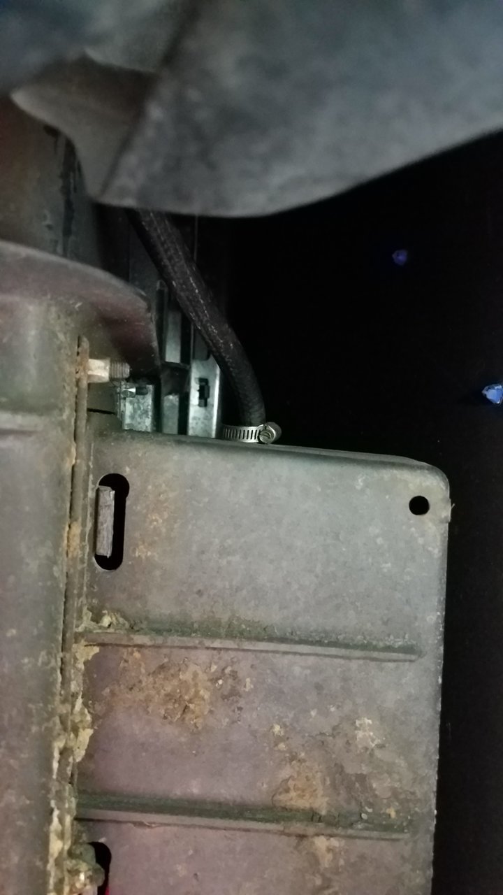

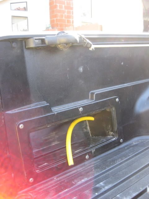

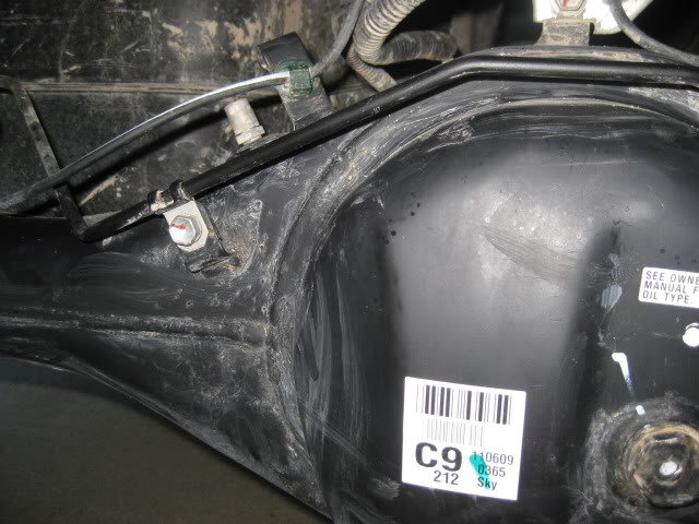

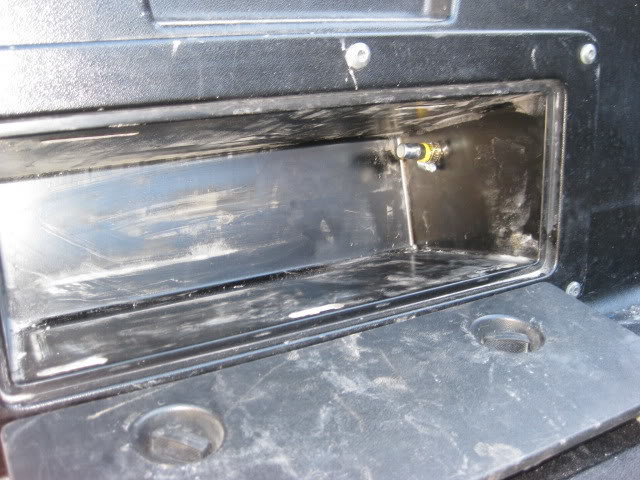

    As someone suggested earlier in this tread, I went with a 5/16 hose from Napa. Bought 4 linear feet, and ran to my bed compartment on driver side. Teflon top of tread only, not entire tread of new fitting. Enough to cover depth into differential. A little spit goes along way, for helping you penetrate the hose.

    I thought this was the size he says in the first thread. This is my first DIY job so I’m still learning. What should I be looking for then?

    The size is correct, but the material (pvc) is not the same. The thing that comes on the rear differential is not a breather but a vent. What the mod does is duplicate what Toyota puts on the front differential by putting a real breather, up high.

    So this hose will work then?

    I don't know, as you got PVC hose and not rubber hose. PVC is typically cemented to fittings (PVC hose or pipe) and rubber is pushed over barb/ insert fittings and clamped.

    I feel like one of these is the wrong part
