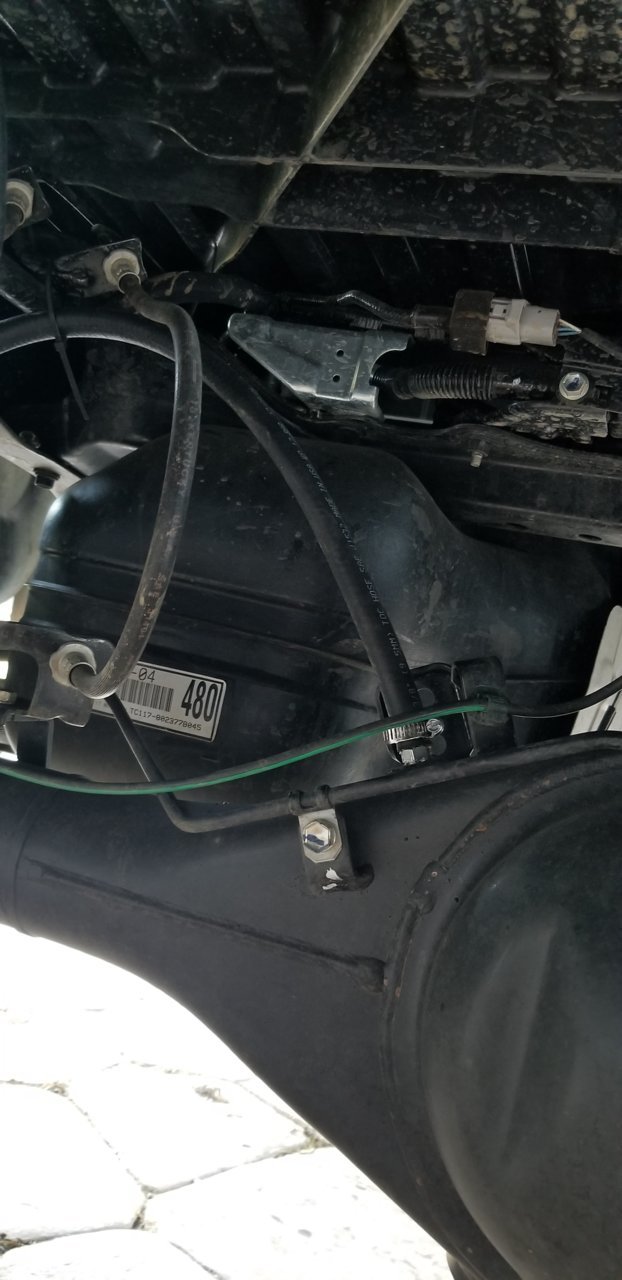

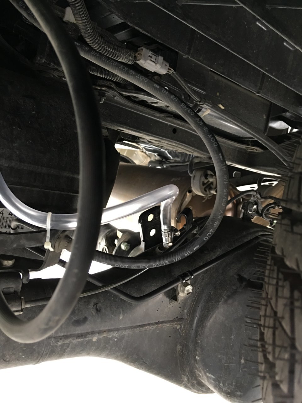

    I'm also concerned with this. David K said earlier to only put the tape on the thread which is obvious, but I'm still curious if someone needs to unscrew the union, if pieces of teflon would fall in.
    That's the hose I used.

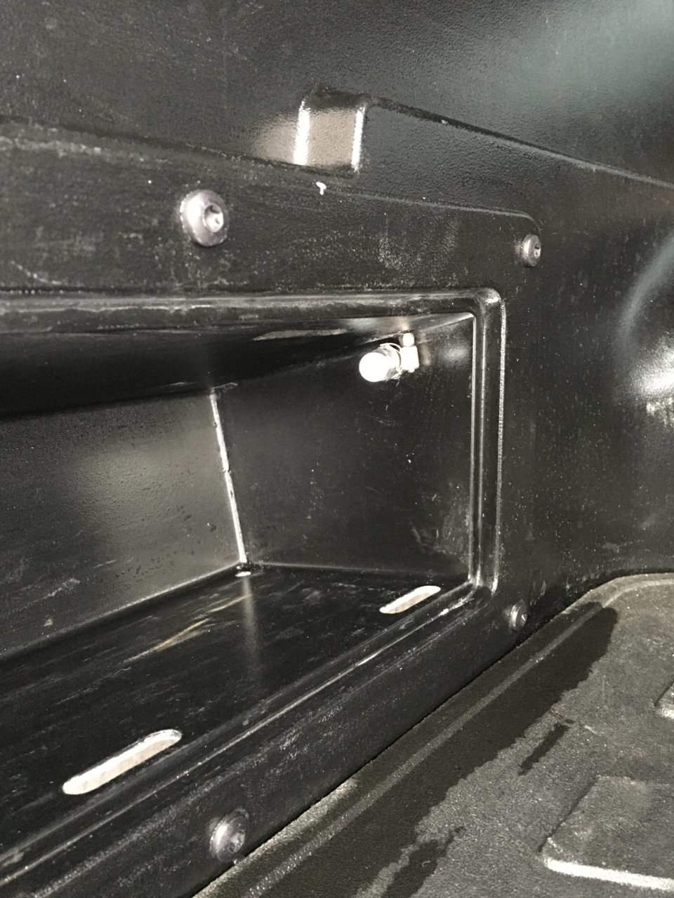

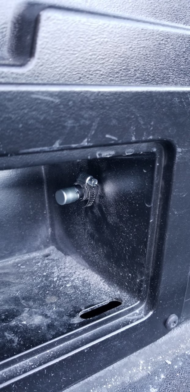

    After procrastinating for two years, finally got ‘er done today!!
    Thanks so much for the write up @David K and for the fast order/delivery of the parts @gunny1005!
    Only question I have though: when camping, I often sleep in the bed of my truck (I have a shell). Should I be concerned at all about the fumes from the breather now that I have it installed in the storage cubby??

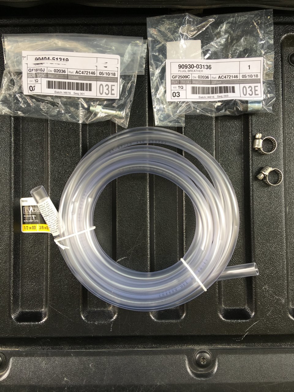

    Welcome to Canada. Here is a photo of the Toyota parts, purchased yesterday. $32.81 Canadian Pesos. About $21 USD.
    I love it here. :spending::canada:
