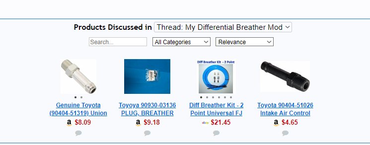

    I hate to be that guy, but when I called my dealership they said it would be 21.77$, I told them about this thread but they said they couldnt go that low, anyone do this recently and have the updated price?
  18. Apr 25, 2019 at 10:04 AM

    Look at the bottom of this page

    Thanks I called the dealership and told them the prices based off of Amazon and they matched them. It ended up being 17.40$
