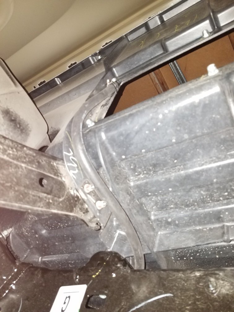

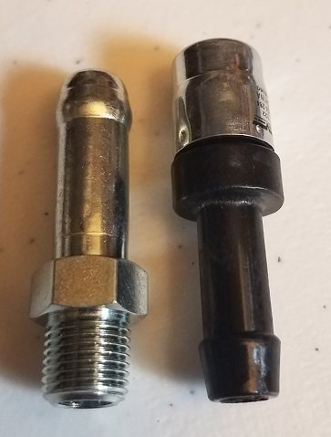

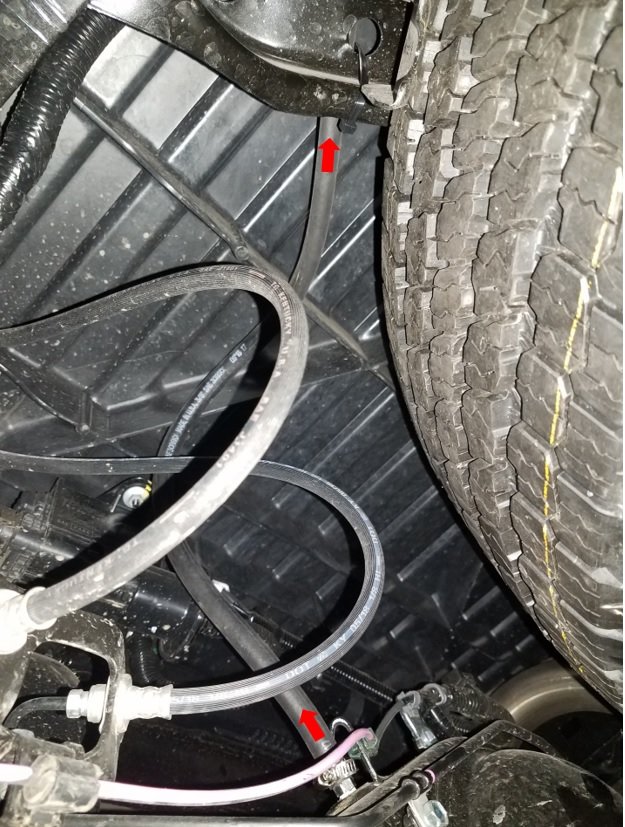

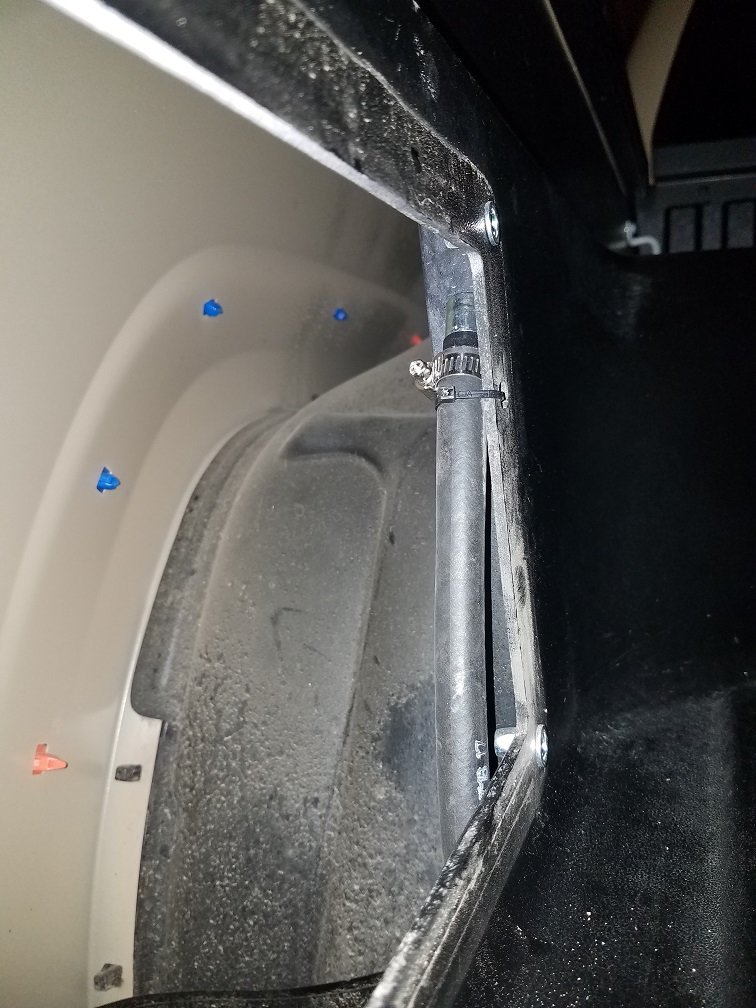

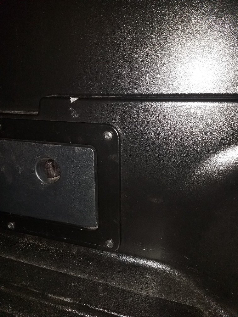

    This is how I did my breather mod to give other members some ideas also. 20180629_155355.jpg underbed.jpg 20180702_212828.jpg 20180702_211541.jpg 20180702_213536.jpg
