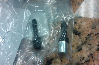

    I didn't read every page, but I read a lot. It seems the parts for the diff breather have been figured out and settled.
    However, there's several references to the breather for the e-locker but I didn't see if that uses the same parts, or if there may be different sizes of things involved?
    Would be great to know before I order if I can just double up on everything.

    Updated Amazon link for the ARB breather stuff, not sure what the differences are:
    https://www.amazon.com/Differential...8&sr=8-1-spons&sp_csd=d2lkZ2V0TmFtZT1zcF9hdGY
    https://www.amazon.com/ARB-170112-D...df5-4b6d-b953-11743fa041f9&pd_rd_i=B00QBQYNF0

    Locker breather is the size of vacuum line. Just get right sized line and extend it

    I don't believe there is any difference between the 8" and 8.4" diffs, just mount it up as high a you can.
    Those are cool. It's been many years since I did my breather mod, but I think you can still get the parts listed at the beginning of this tread for a lot less than those ARB products.

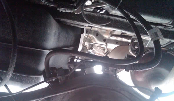

    As a follow-up zip ties still there doing their job in 2023.
