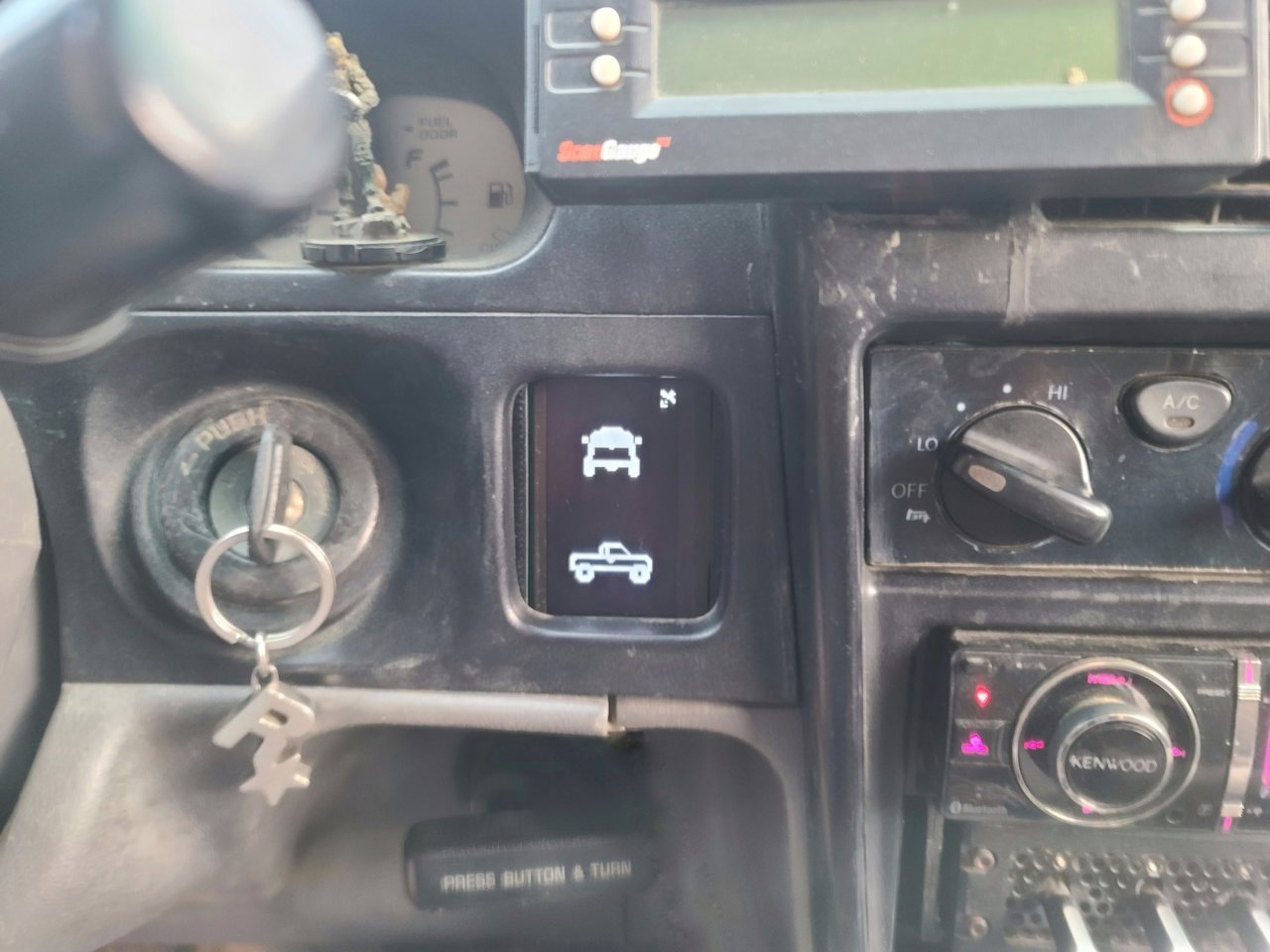

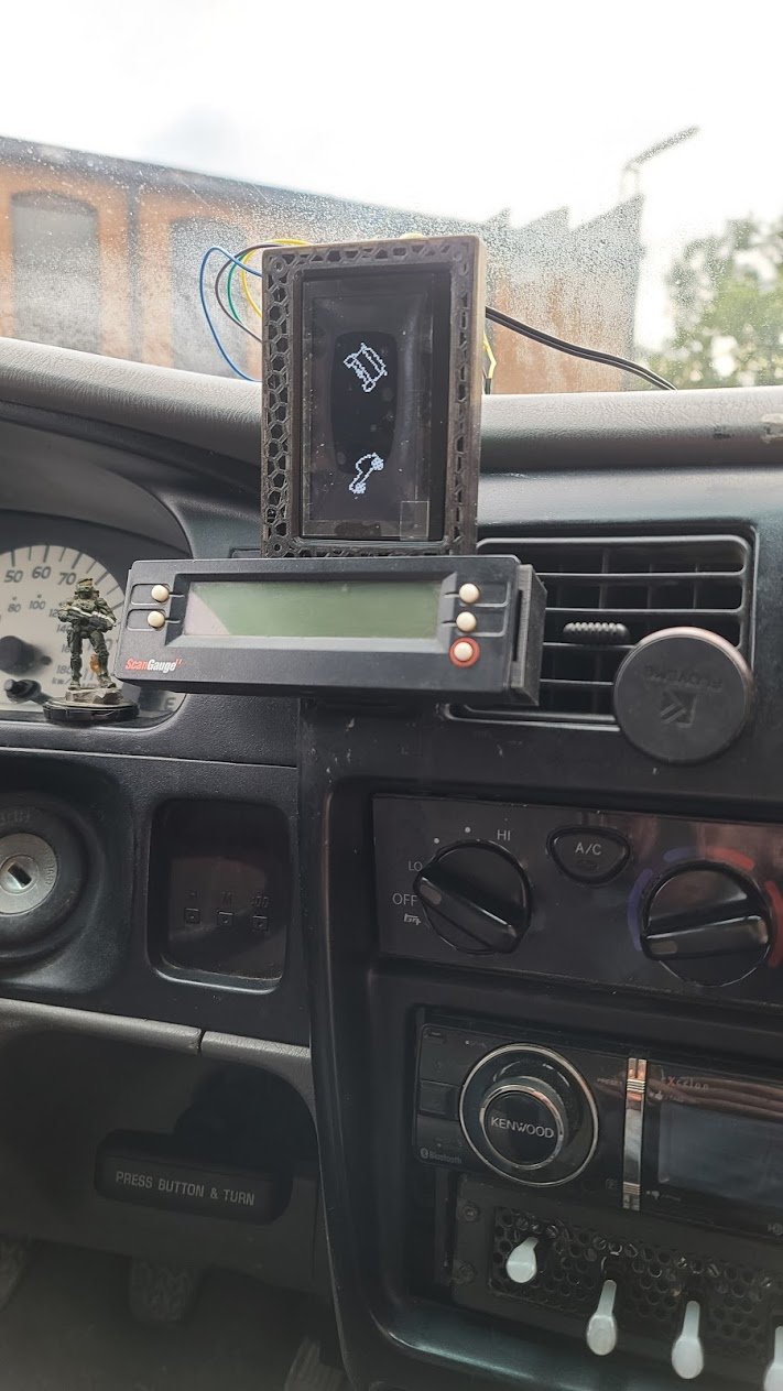

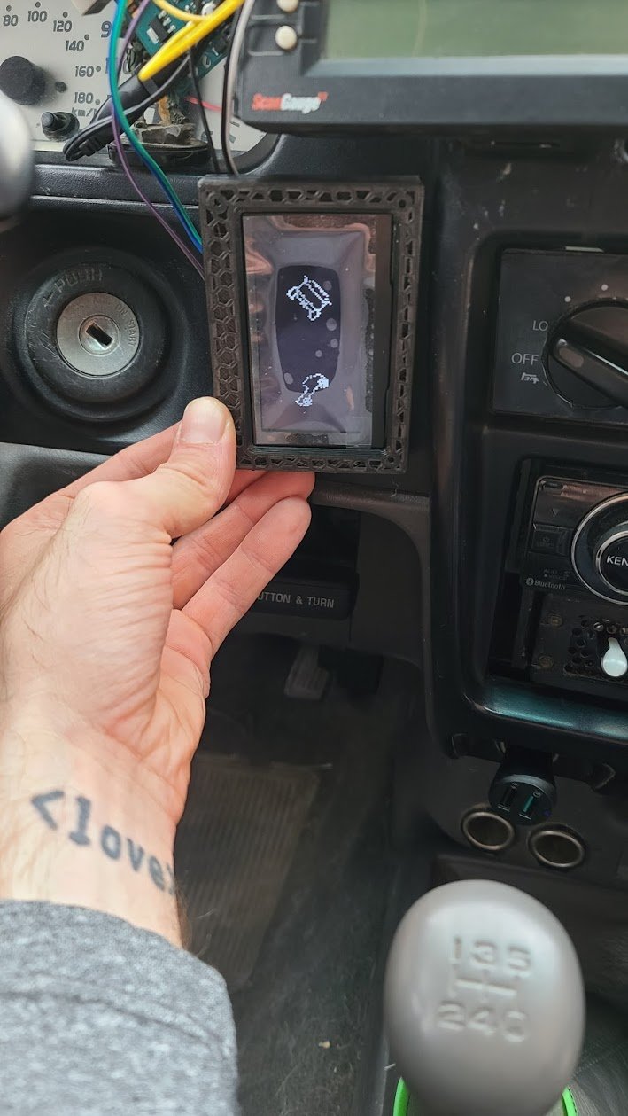

    Made a bezel and started to mock up additional locations. for my own setup, this has a clip that slides behind where my scanguage does, making it removable.
    i'll have to design a mount to have it sit where the clock is if I stick with this screen size. The problem with mounting it at the clock is it's not easily seen by the driver. not a big deal if it's not going to be used much but anything I use often I'd like to be able to catch at a glance without having to look for it.
    still like the idea of having it by the rearview, but I also have another project for up there that I haven't started so I wanted to hold off looking at that as an option.
