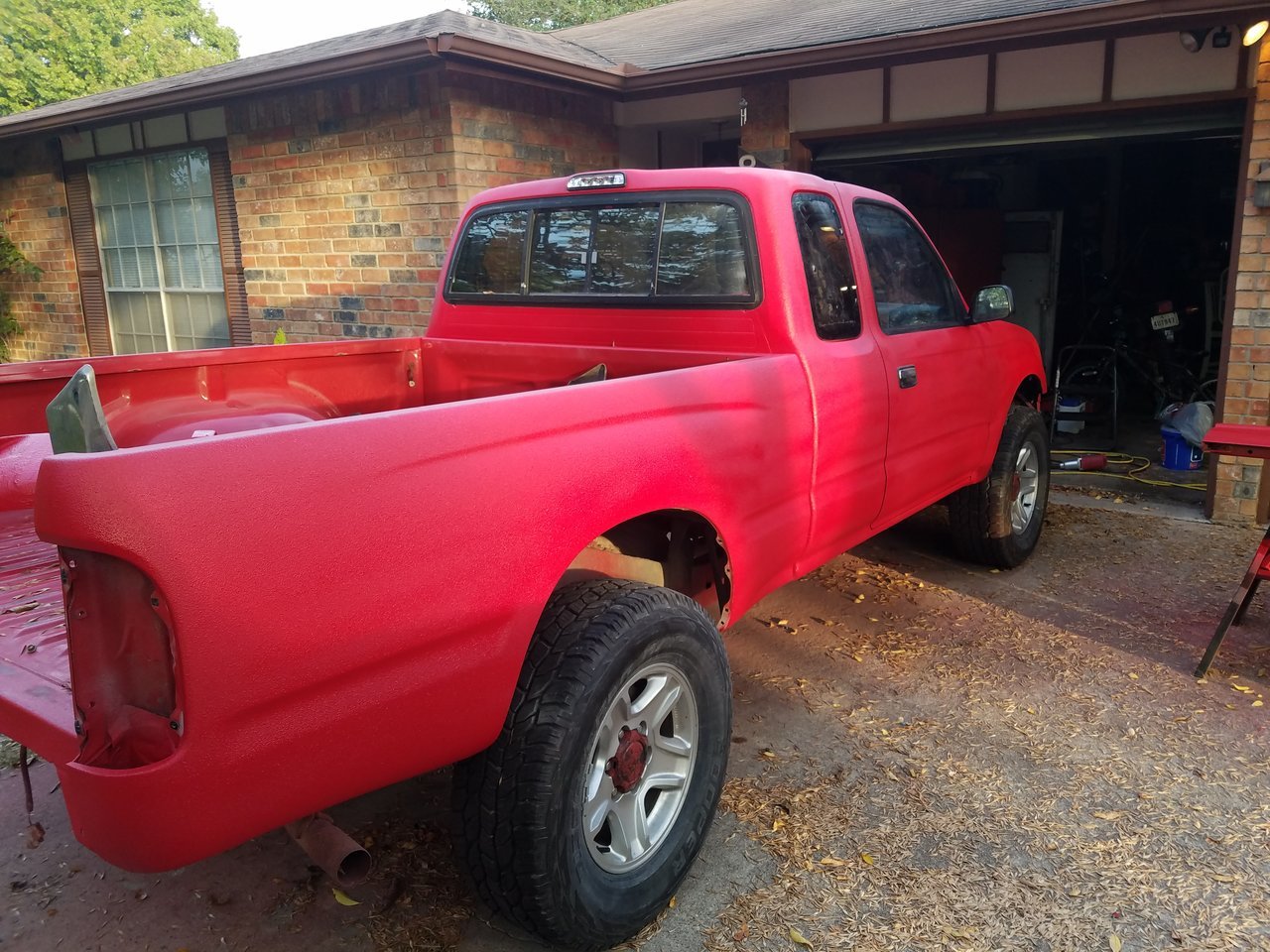

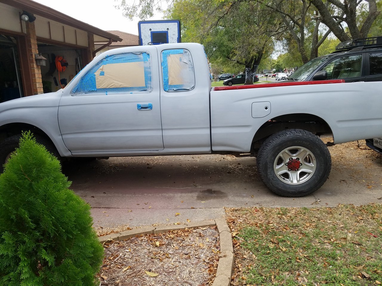

    I fortunately had the Honda behind it to drive while I prepped the truck. It took 3 weekends to prep and 2 hours to spray the bed liner on.

    Well you did a helluva job man. It looks great.

    I did, and put a lot of thought into it before I pulled the trigger. I really didn't want to mess it up. I've had this truck for 18 years and really don't want to ever get rid of it. My wife on the other hand said it was getting old and wanted me to trade it in for a newer model. I told her she's getting old should I trade her in for a newer model. Never heard any more about it from her.

    What spray gun did you use and what size compressor? Ive had my for 18 years and the paint is toast. One more question, how did you prime it, spray gun also?

    I used the Upol gun that came with the RaptorLiner kit. Here is the link to the spray gun: http://www.tcpglobal.com/UPO-726.html#.W7OWi2hKiUk . I purchased the whole kit from www.tcpglobal.com. Link to Kit: http://www.tcpglobal.com/UPO-KIT-0823-T14-6-GUN.html#.W7OkEmhKiUk. The compressor I used was a 120psi electric compressor. I used a psi regulator to control the psi output on the spray gun. (regulator came with the kit) I primed it 3 times with rattle cans. I used the rust-oleum automotive self-etching primer and sanded with 200grit in between cotes.
