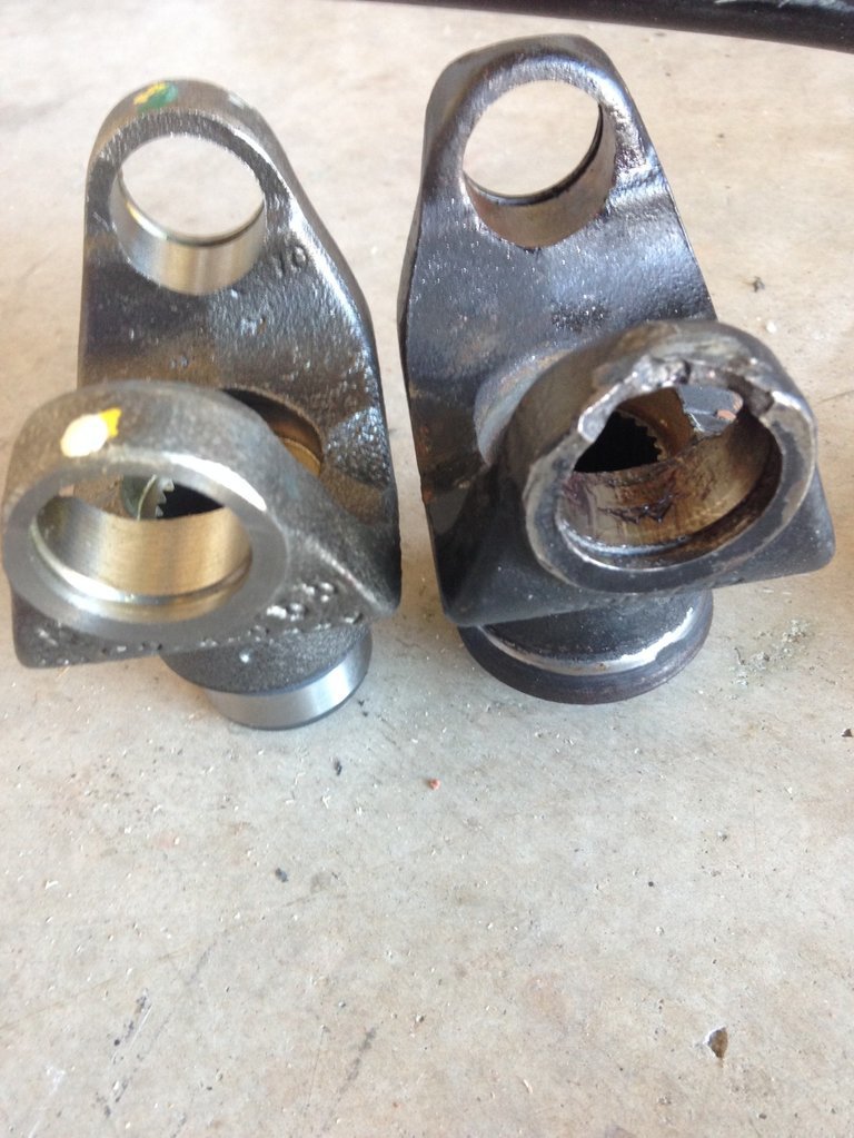

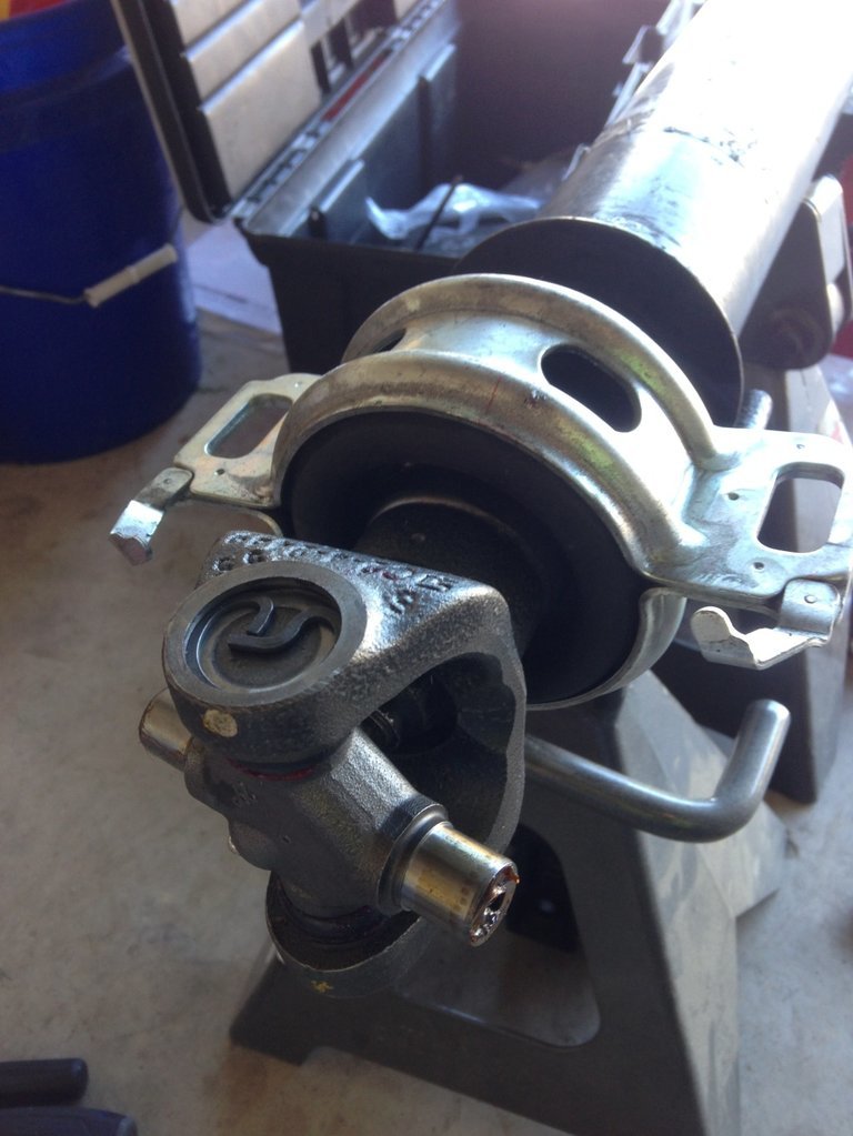

    Just wanted to document my "journey" I have had with my drive shaft over the last 19 months. The truck is a 2007 Access cab, 2wd, TRD Offroad, 3" front lift, with 2" rear block. I had the typical vibes, as I could not find the proper carrier bearing drop/ rear axle shim combo. I kept a 3/8" drop, no axle shim. I dealt with it and paid no attention to it. The problem started in May of 2014, with my drive line started squeaking while in reverse. I figured with 88,500 miles, it was time for new grease-able ujoints and a new carrier bearing.
    June 1, 2014
    88,500 Miles
    Reason for squeak. I guess 7 years in a humid climate will do that. Note at this point I had no symptoms of a bad carrier bearing. I replaced anyways since I had the drive shaft all the way apart.
    Fast forward to May of 2015. I start to notice a shimmy/ more vibes than before. I take notice, but can't figure quite what the problem is either. Started to investigate. Started with wheel bearings. Not the issue. At this time, my wife and I relocated to Texas, so the truck was put on the back burner. When I finally get some time to climb under the truck this is what I find.
    August 10, 2015
    103,794 miles
    (click for video)
    th_55F344E3-3F02-4658-A6A0-90DA33F16686__ba3cd499ea6f395a410f307517a5571445c5a8a7.jpg
    C8E02C66-734A-46A7-A124-A042CA73ECBB_zps_6b755d5e658e80fe2ee3095302231ed09921f755.jpg
    FAC3FE65-01F1-472F-B061-4AF37E6A579A_zps_f72e755444482a8af0b9510446e0df9b3d0d5f3f.jpg

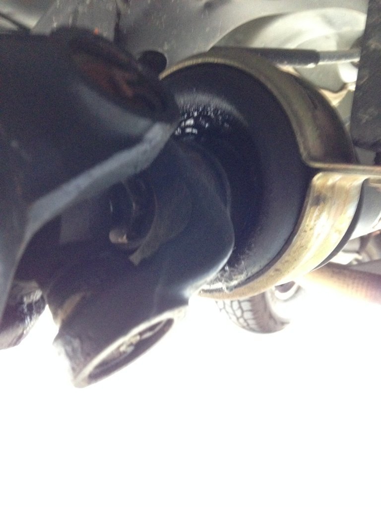

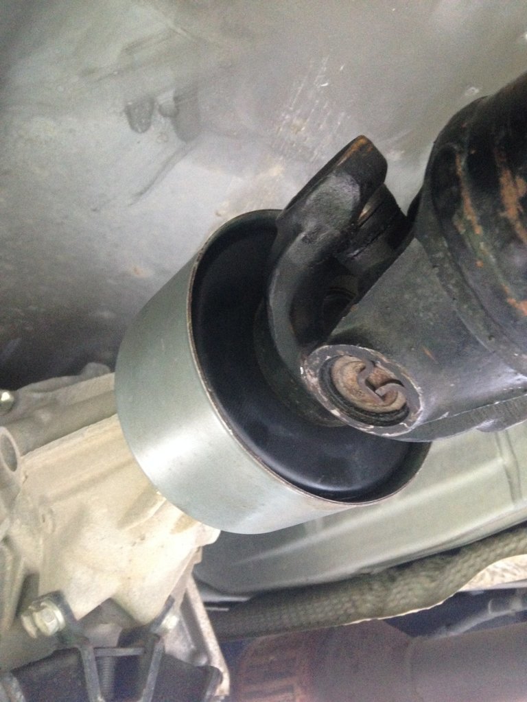

    Bad carrier bearing. I don't know if it was an installation issue, or a bad bearing.Failed after 15,357 miles!Either way, it needed to be taken care of immediately. This was a Monday, I had to work Tuesday and then was off for 5 days. My plan was to install a new bearing on Wednesday, my first off day.
    August 11,2015
    103,857 miles
    919EEFF7-0C4B-44BA-A645-229F6CCBEABA_zps_8b44e45fe57832a45d4f67a638f7f7f1a4e90b3e.jpg
    57CF4CC8-32DD-4782-85FD-951146F35E87_zps_c4ad3b3bda665a252b1709b44b2a30c563316666.jpg
    FA0F4098-8EC2-4894-AC0F-FEE09FB8E0BC_zps_f0279063a217cd07e4bb6c2607382e31558be1f2.jpg
    4F2E06E9-B098-4973-A7F2-F61257025586_zps_a0b83faffed8cd911a816f49b8ef4809bc6e4a7c.jpg

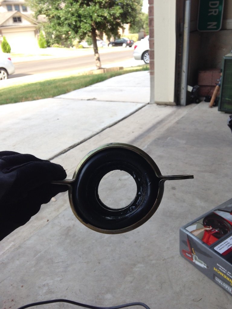

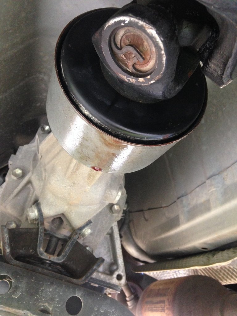

    This is what was left of the bearing
    CC71C9E5-F63D-476E-89F2-0FFB63688944_zps_39dd25cdec462adf3ea7aae6fcc690af22759e22.jpg
    The bearing didn't give me enough time to replace it. It gave out on me while I was heading home from work, doing 65 mph down the highway.

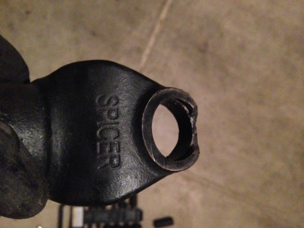

    Now I need a new bearing, a new bolt on flange yoke, and a new Ujoint. I noticed damage to the yoke that bolts to the shaft the carrier bearing is on but don't do anything about it.
    C6B935CC-5DDF-4DF3-B67F-80998B29D118_zps_449e5837483ed22971cb8217647dc336fb1d4adc.jpg
    C8E999AB-3E7C-4B5D-BB70-B069A386C2DD_zps_dde7691be5f18d27489c479c3c1e6563451c0e02.jpg
    Since I drive roughly 66 miles a day round trip for work, reliability is a must for me. I decide to remove the rear blocks. The lift is for looks anyways, and the trade off for reliability is worth it to me. I still had the vibes at highway speeds, and I did not want another failed bearings.

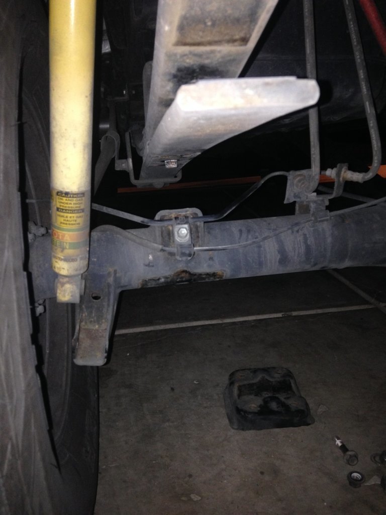

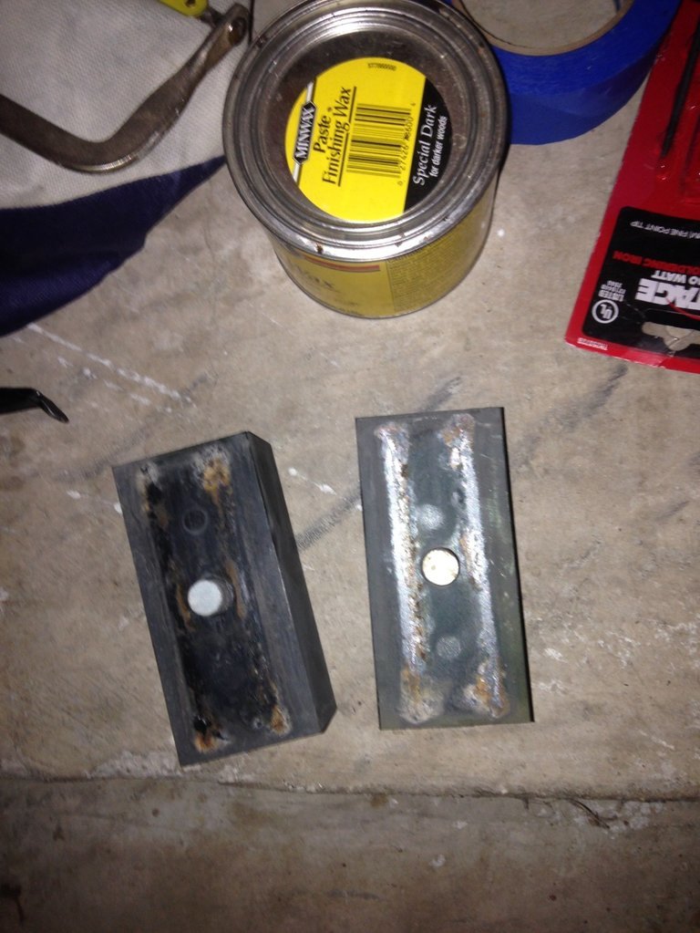

    November 10, 2015
    Rear lift removed, rear back to stock
    56FDC86F-EA21-477D-8F77-833FCB5DC364_zps_11e2406c9392f1ff9b1852ed63028f950aeb3735.jpg
    1D81EEE6-356E-4A45-841F-D3A3B5C5FCFA_zps_b3fe83697fa6d3afe6968ef0ae39a7aebd3fee73.jpg
    Still need to lower my front, but will get to that later in time.
    680DC4A2-66D9-4327-864C-619B67DE4D7B_zps_175ca43399180c561e60b477450c58ee4df1c0c3.jpg
    With the blocks and carrier bearing drop removed, I had eliminated the vibes at highway speeds, but had a worse take off shudder. After reading up on drivelines, I realize when I installed the last carrier bearing, I installed the bolt on yoke out of phase. This in turn was causing the take off shudders.

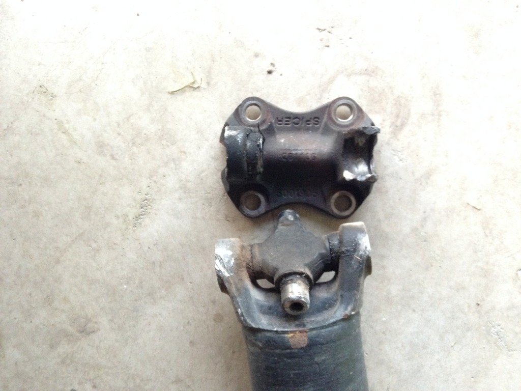

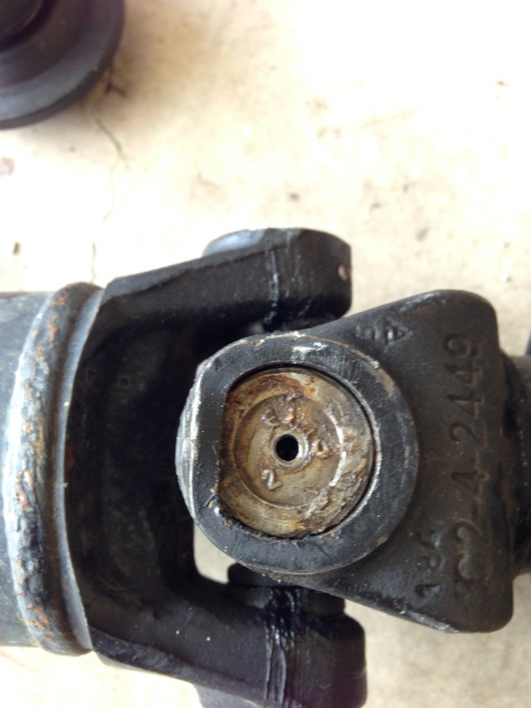

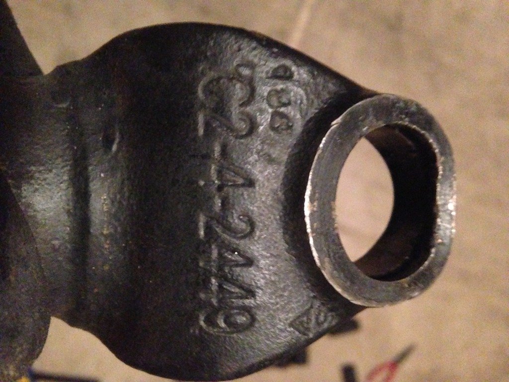

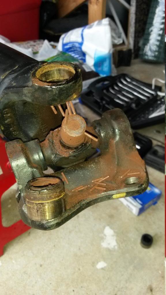

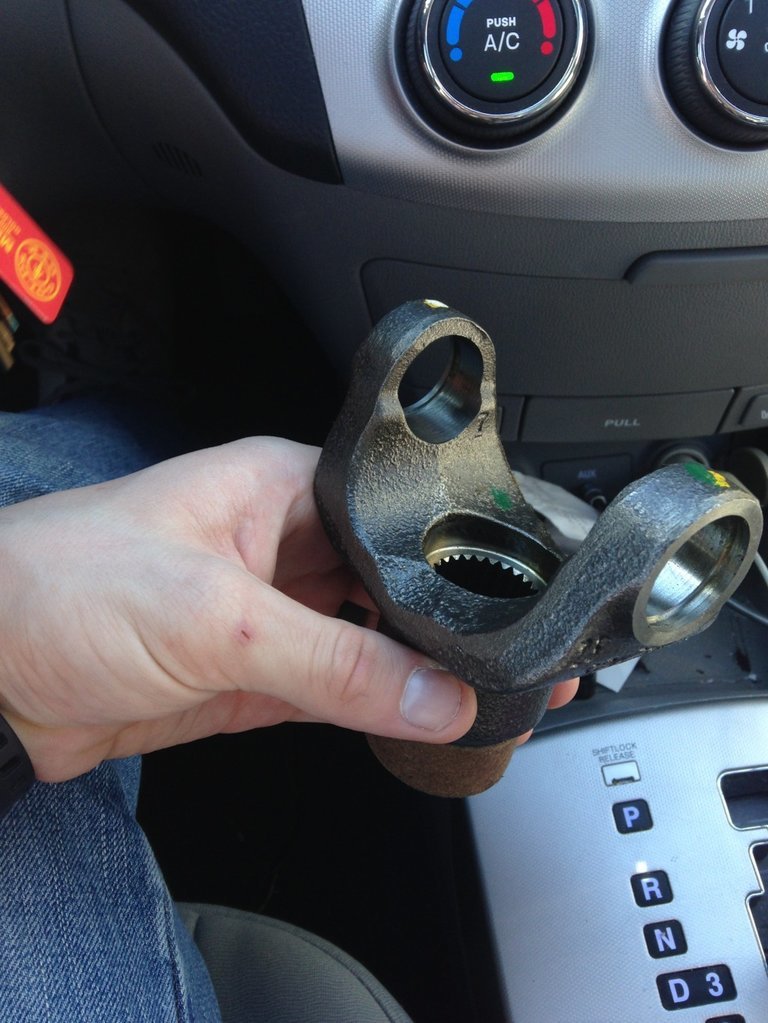

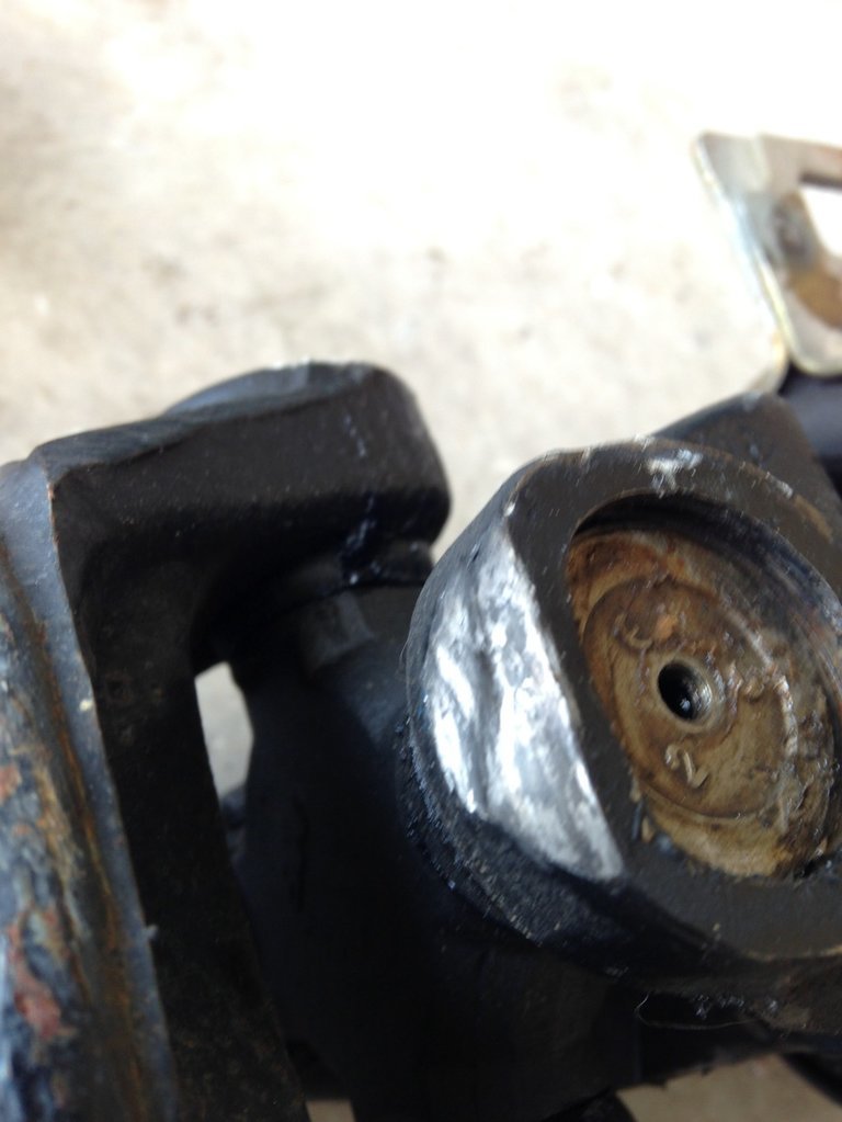

    I remove the bolt on flange and notice significantly more damage. I now regret not taking care of it when the carrier bearing failed. The joint goes together by hand, and is held in by half of a spring retaining clip. I call a local shop, and luckily they have a yoke in stock. I start to head the shop, get a mile from my house, and the Ujoint falls apart.

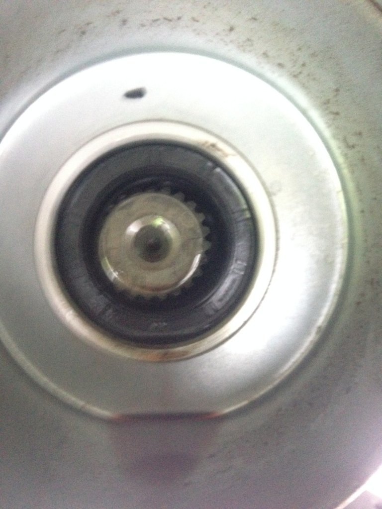

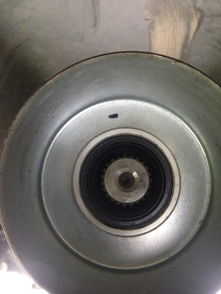

    January 16,2016
    111,175 miles
    03624F1D-2D3B-4662-BC95-1A90E1E2C034_zps_c1f8081e6d8ed9301cb3362c7cc56bc121d3762f.jpg
    B14B5A8B-3453-458C-BD7A-10A6759B0CB4_zps_c6ad1b866711cd6e46975b0d27b67b5989c7d8af.jpg

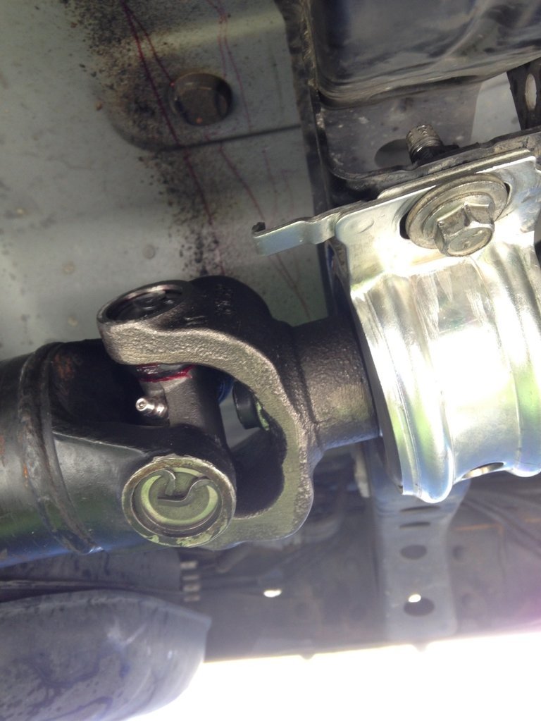

    Now my output shaft seal is leaking. I must have damaged it putting the shaft back in. So now to the dealership for the new double lip seal.
    65E7971D-F2F0-46AD-9E76-A6A37B18C782_zps_475707793e9c2c109d152707ec11b9e9aae87a28.jpg
    5E83DA4A-CB6F-4C04-8185-B6D5CDB747B4_zps_cb9b9a74b052f084d70ace1b0b777a2e9883bb90.jpg
    Got that taken care of and so far so good. About 100 miles on the new seal, no leaks, smooth sailing. Here's to hoping that is the end of my drive shaft saga.
