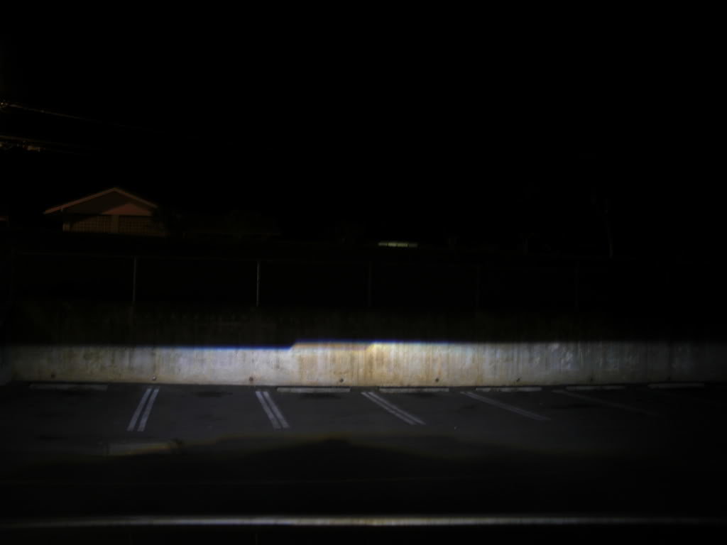

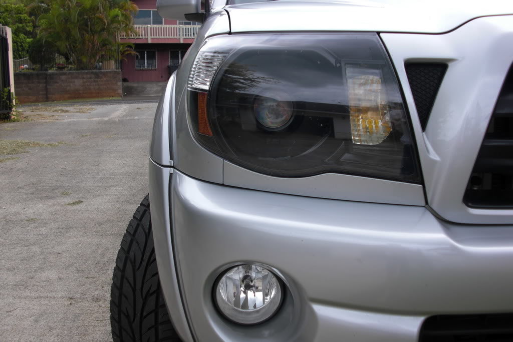

    Here's my tl retro.

    Those look totally badass- get some eyelids and they'll look straight evil

    retro fits are sooooooo damn secksy

    TL projectors with E46 shrouds.
    Which shrouds did you go with?

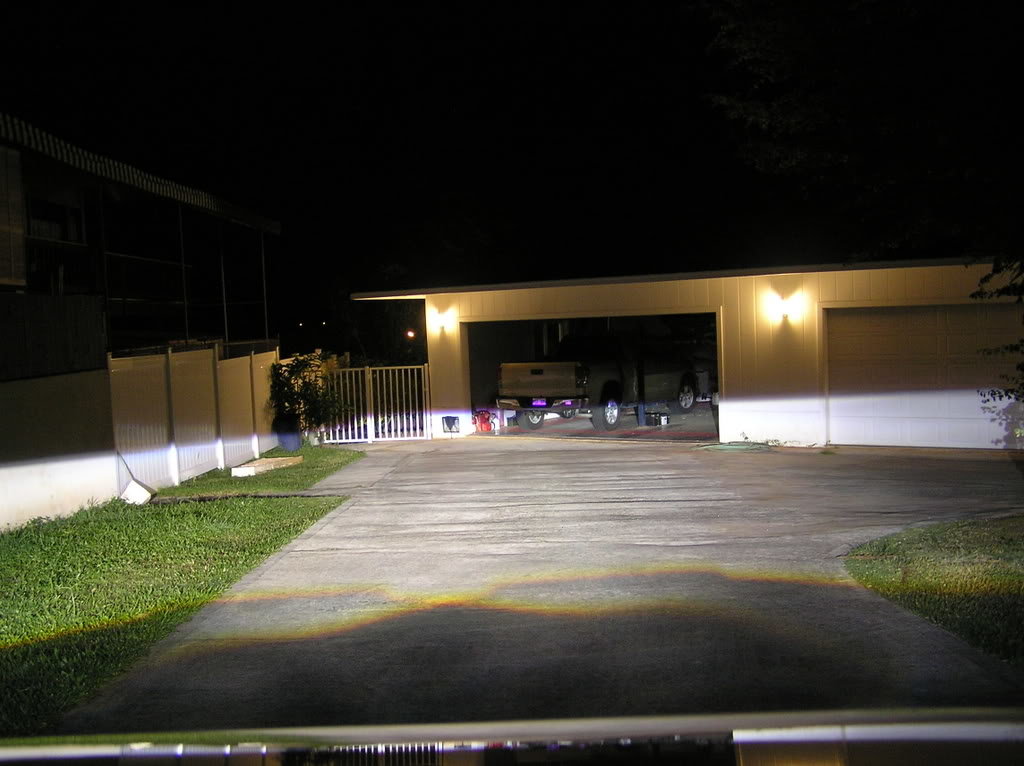

    I used E90 shrouds. I wanted shrouds that were completely round. I just had to trim a small area for the solenoid to stick through.
    They are bi-xenon, so here's my high beam.

    Not all projectors are bi-xenon. Only tl, fx35, murano, porsche, g35, e55, e46 the last 2 have very poor performance. Low beam only are tsx, s2000, ls430, rx330, sc430 and others that I can't remember now.
    Oh and the thing that makes them bi-xenon is a shield that moves down to reflect the light in a different pattern.
