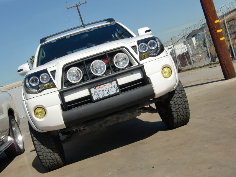

    I never did post up any pics..... but, Here are mine: :cool:
