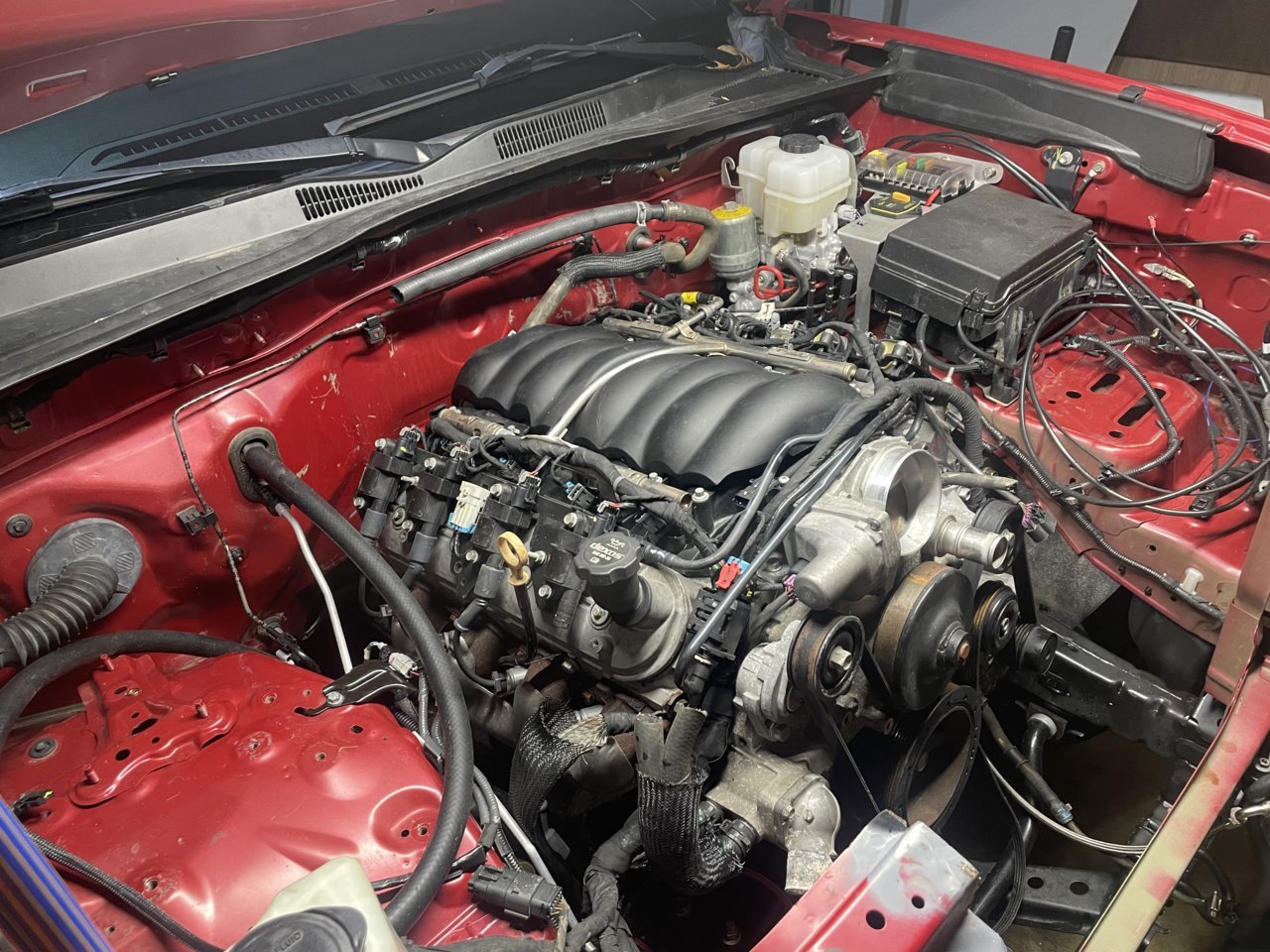

    I’ve pretty much got the motor mounts fabricated up, I’m curious is anyone would be interested in some, I could mass produce them pretty easily. I have also made them so you use the factory Toyota rubber mounts so there is no cutting and welding on the truck. I’ll get some pictures up when they are all done

    I know you had mentioned before about the trans tunnel not being large enough for the ls powertrain swap. Did you end up getting it to work, or what trans are you using? Sorry if I missed it alrwady being said.

    What I’m learning now is the trans tunnel has plenty of room. The problem is the oil pan, there definitely isn’t an after market pan that works. I’m in the process of making my own, the diff is where it gets difficult.

    Oh yea I’ve been driving this around for over 1000 miles, I now have a transfer case installed just waiting on having a front driveshaft made. It is pretty much a perfect daily driver now, plenty of power

    I’m using a t-case from a 2018 silverado. I will be using my buddies stand alone harness and programmed controller for the control side of it, he owns swaptimeusa check him out
