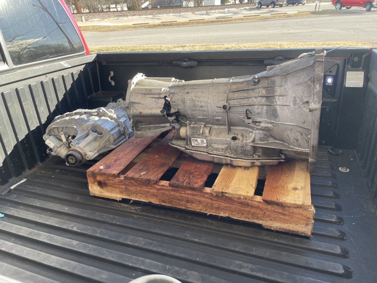

    104
    Drew
    2016 TRD OR
    3.6TT Engine swapped, Icon Stage 4, SCS wheels
    Picked up a transmission and transfer case and TCM today from a local salvage yard, I’m now in really uncharted territory, not to many people have swapped a LF3 into many different vehicles, no one has swapped anything into a 3rd gen, now I’m trying to make a LF3 4 wheel drive lol
    Transmission and T-case is from a 2018 Colorado with 10k miles.
    I have some cool stuff coming from my buddy Mitch from SwaptimeUSA that I’m excited to show you to help with this but that stuff should be here next week sometime
    my goal this weekend is to try and get this Tranny in and mounted in the truck
    BTW I have no idea if this trans will even mount to the LF3 lol
  12. Jan 27, 2023 at 10:29 PM
    #152
    BananaMan
    BananaMan Well-Known Member
    Sep 4, 2019
    #304247
    8,273
    Bumfrick nowhere Maine
    06 2.7 RC 2wd manual "squattytruck"
    Only one way to find out! :welder:

  13. Jan 28, 2023 at 10:12 AM
    #153
    ExplorHer
    ExplorHer Question Authority
    May 2, 2016
    #185889
    822
    Near Pittsburgh
    2016 4cyl, 5MT, 4x4, 2 seats, dents, & rust
    A LF3 powered 2wd Tacoma would be a super fun Street machine, but I appreciate the drive to make the 4wd functional. Looking forward to seeing your progress :thumbsup:
