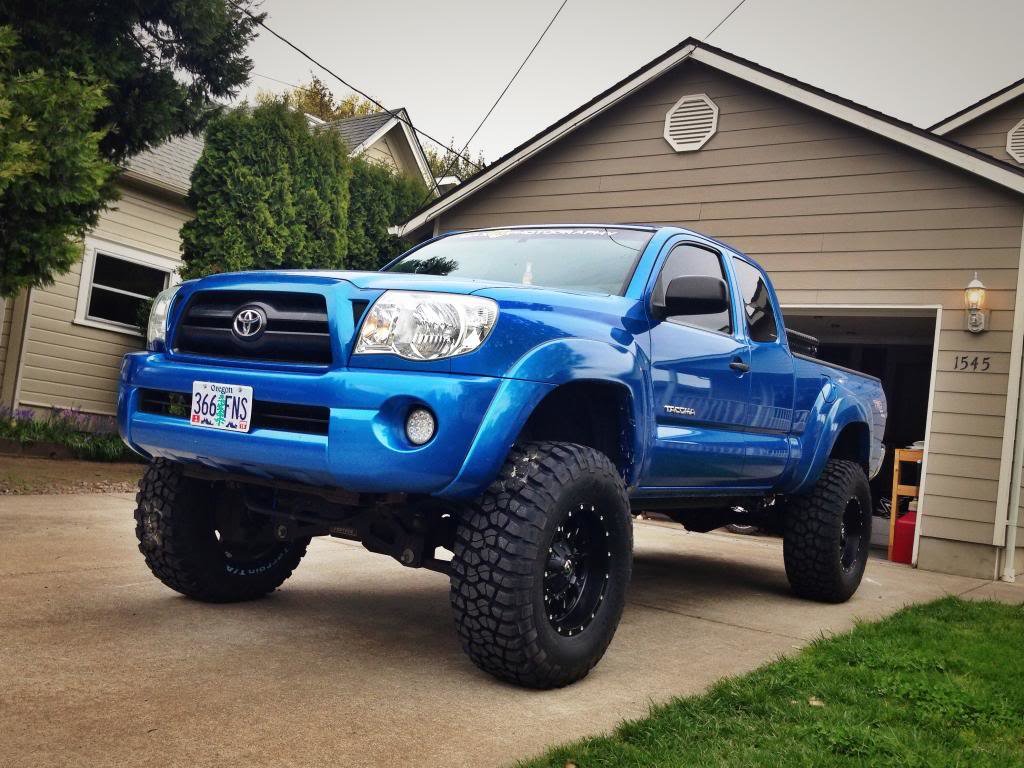

    I bought my truck in December, with a Fabtech DB lift already installed. It was the dirt logic upgraded version, but still only blocks in the rear. The back end had begun to sag, especially on the drivers side, the ride was crap, and the truck had bad axle wrap under hard acceleration.
    I started looking into replacement options. I landed on Alcan, after seeing others had gone that direction.

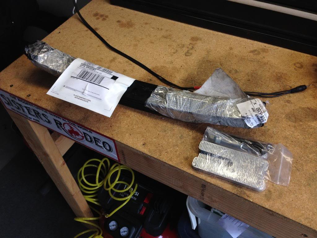

    I placed my order on March 12th, for 6" lift springs, for $785 to my door.
    The springs made it to my door by March 28th, in only 16 days.

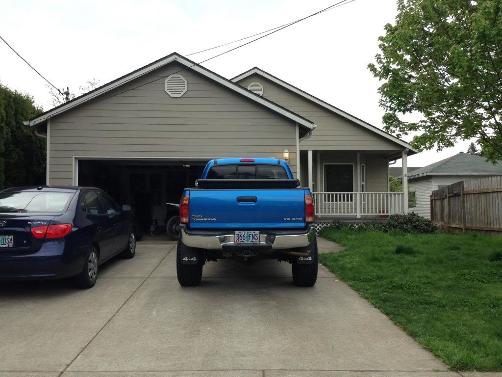

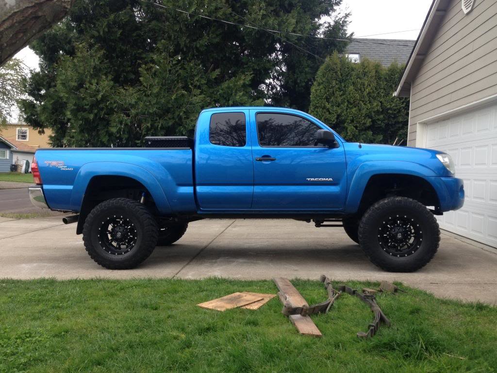

    The springs went on easily and as expected. After the initial ride, the axle wrap was nearly non-existent, the ride was noticeably better, and the truck was sitting level. Although level, I was expecting more height out of the rear end, I was hoping for a small rake.
    Out came the measuring tape. I measured my truck against my girlfriends stock height truck :)cool:), from the top of the 17" wheels with a level to the bottom of the fender. The result was, my new leaves only net me 4.5" of lift.
    Also, the truck still sat a little lower on the drivers side than the passenger. The front of the truck has the same issue.

    Took some measurements, used the same method: measured from the top of the wheels with a level. The new springs net me almost exactly 6" of lift, after settling, on the PASSENGER side. I'm still facing the issue of the toyota lean. The new springs helped, but did not solve. I'm going to try a 1/2" toytec spacer on the front drivers side.
