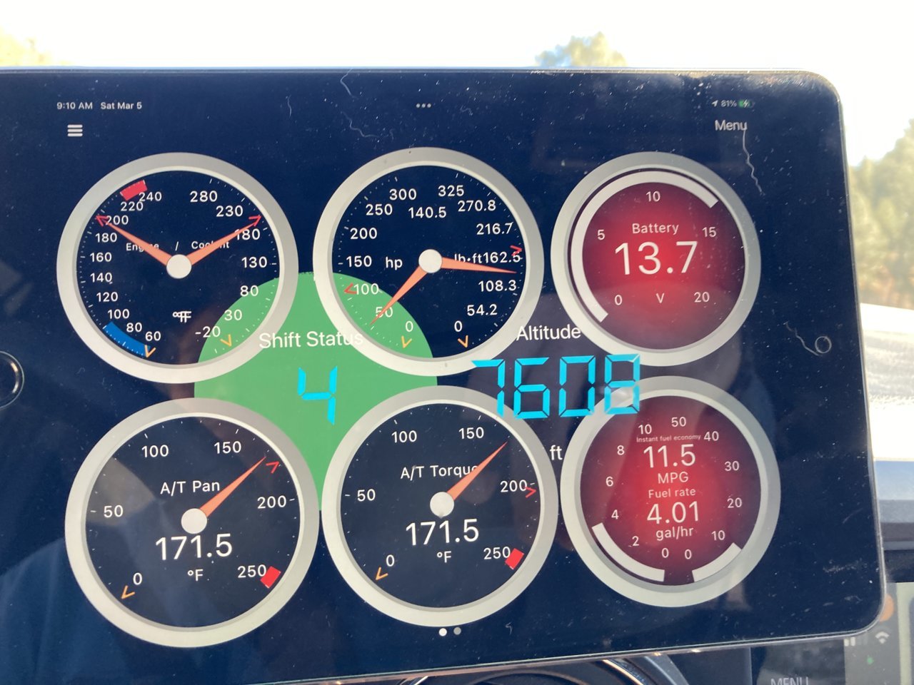

    So what temps are you maxing at pulling up a hill or into a headwind?

    Ya know, I'd have to check my records. This is from a post I made in the aftermarket cooler thread:
    "... I logged my Temps last weekend pulling my SxS, no aftermarket cooler, and ran between 195 and 200 virtually the whole time except for stop lights and hills. I spiked to 224 at a stoplight and running up hill I had to really push it to get it to climb over 215 or so. I tow around 65 mph max, but found if I went much faster the temps would climb. Fast.
    After awhile, my pan and converter were within a few degrees of each other, around town my converter is hotter than the pan by a larger margin.
    Around town I'm usually at 185-195.
    I actually quit monitoring temps as hard as I once did since nothing ever happened.

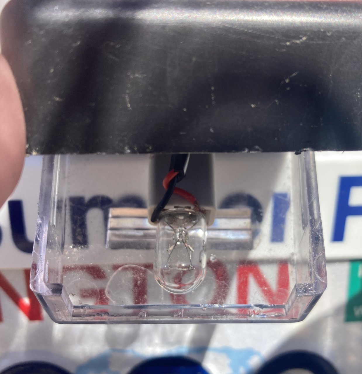

    I have a apex nano 185 bh . My question for you is how did you power the backup camera system on the trailer ? I’m trying to figure out before I spend my money .

    I connected directly to the 501 licence plate bulb and pushed the bulb back in. Easiest and best mod to date.
