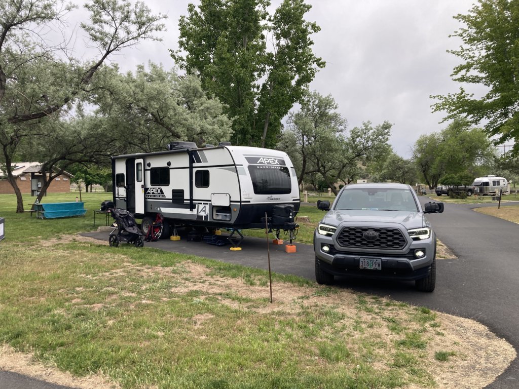

    Just a quick thought....Looking at your pic. Your trailer carries a lot of weight behind the axel and the front is slightly elevated. That could explain the sway. I have never experienced any sway with my Casita. There is not a lot of the trailer behind the axel and my tongue weight is just over 400 lbs.
    I have started paying closer attention to my tongue weight after picking up a scale to measure it.

    Good point. I haven't actually weight the tongue.... might need to do that.

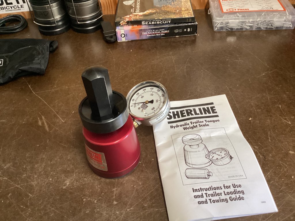

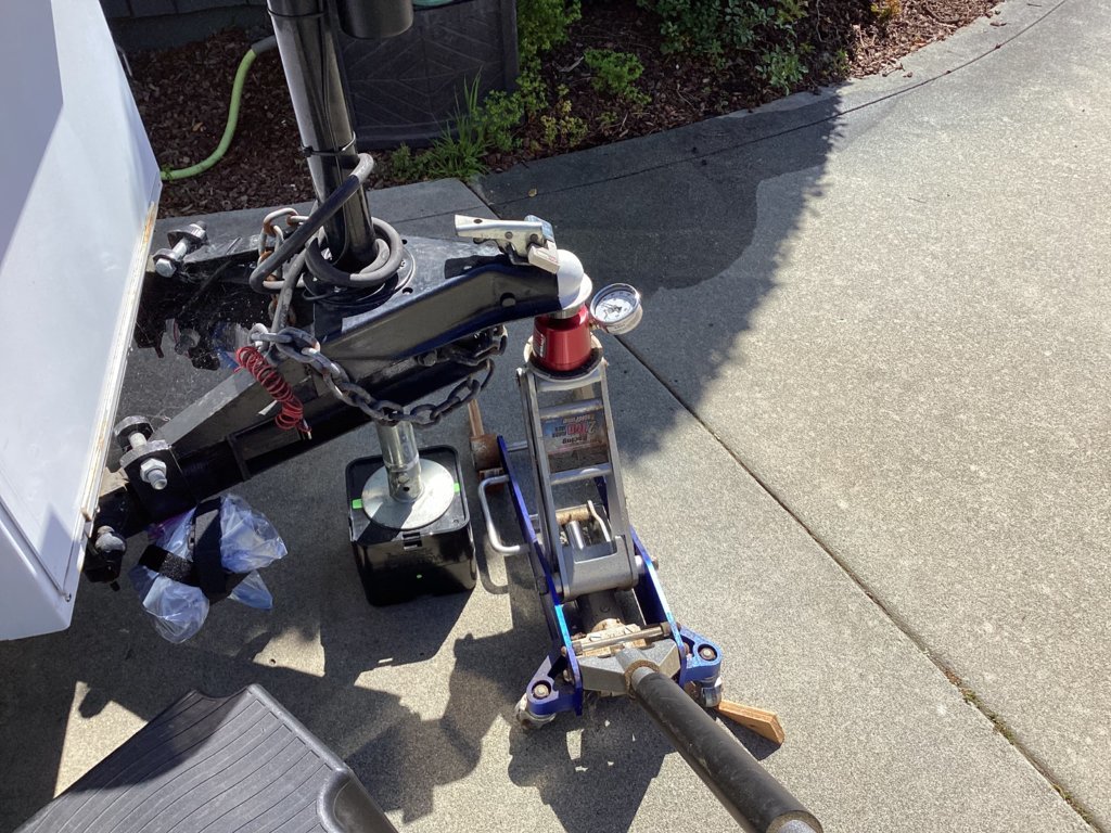

    My tongue weighing system. I use the jack to make sure the reading is taken with the trailer in the exact position, regarding level, as when it is hooked up.
    To little tongue weight is generally considered the primary cause of sway.
