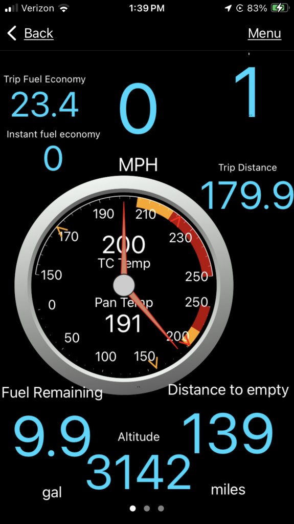

    I just did a drive from Lincoln city OR to Redmond OR up through the cascade mountains (not towing from sea level to 4,200ft elevation ) and I woke my OBD fusion app half way up and was shocked to see my pan temp was 201’f and my torque converter was up at 227’f.
    I was driving very tamely (wife and baby in the car) in D. Switched to S mode to control gears temps and all was fine after that. This has also happened on other big climbs before.
    I’ve seen charts about oil breakdown etc but i would love to know what Toyota considers “High” for trans oil temps…
    Anyone else get temps like this with normal driving through mountains?

    I never thought to turn on the app when I wasn't towing. That does seem a little elevated for not towing. How many miles are on your truck and have to changed the tranny fluid?

    40k miles and nope on the tranny fluid.
    I’ve had it happen a few times before on long drives where the system is fully up to temp and then doing a big climb. Ultimately 201’f is only 15’f over when the thermostat opens. I feel like potentially 200’f at the pan is nothing to worry about.
    Daily, how many tacos drive up 4kft elevation in D? Lots I’m sure, how many are having transmissions replaced? I certainly haven’t read about any/many on here. I’m thinking 200’f is well within specs.
    If Toyota had concerns why did they remove the trans radiator mid 2020?

    EDIT: through chatting with some peeps I'm kinda leaning towards the fact that the trans pan oil could probably get up to 220'f for a short while without worrying too much. I think it would be bloody difficult to get it up to that temp, but from now on I'm not going to stress about keeping it below 200'f.
    I'll try and bottle up some of the trans oil to see what condition it's in, could even send it off to be analyzed.

    I can’t find any transmission temp option on my fusion. How did you get all of that info? Thanks.

    They are under Toyota, Lexus, Scion heading.
    A/T oil temperature No.1 is the Pan temp and A/T oil temperature No.2 is as it comes out of the torque converter.
    The temperature of the oil coming out of the torque converter will vary quite quickly and dramatically. If you’re pushing the truck hard expect to see temps upwards of 230’f at the TC and 200’f at the pan. The thermostat on the transmission opens at 186’f +\-.

    It looks like I’ll have to pay for an upgrade for Toyota specific PID’s? Thanks for the quick response.

    I experience 200 routinely with normal driving- not towing. There are some that post about temps around 170 -but I basically never see that except on cold start. I wish it were lower. I’ve resigned myself to an earlier AT drain and fill - maybe 30K. Not as much room for external cooler on the 4G as was on the 3G. On My old 3G I added an extra external cooler and it helped - but not as much as I would have liked. 4G runs 10-20 degrees hotter than 3G (oil and AT fluid).

    Does the 4G have a dedicated external cooler for the transmission or just use the coolant radiator like the >2020 3rd gens?
    Have you actually had a monitor on to verify the 4G runs hotter?
    The 3rd gen transmission operating temp is 186’f, this is when the thermostat opens to start cooling the oil. So posts talking about operating temps of 170’f are nonsense, unless they have the thermostat pinned open.
