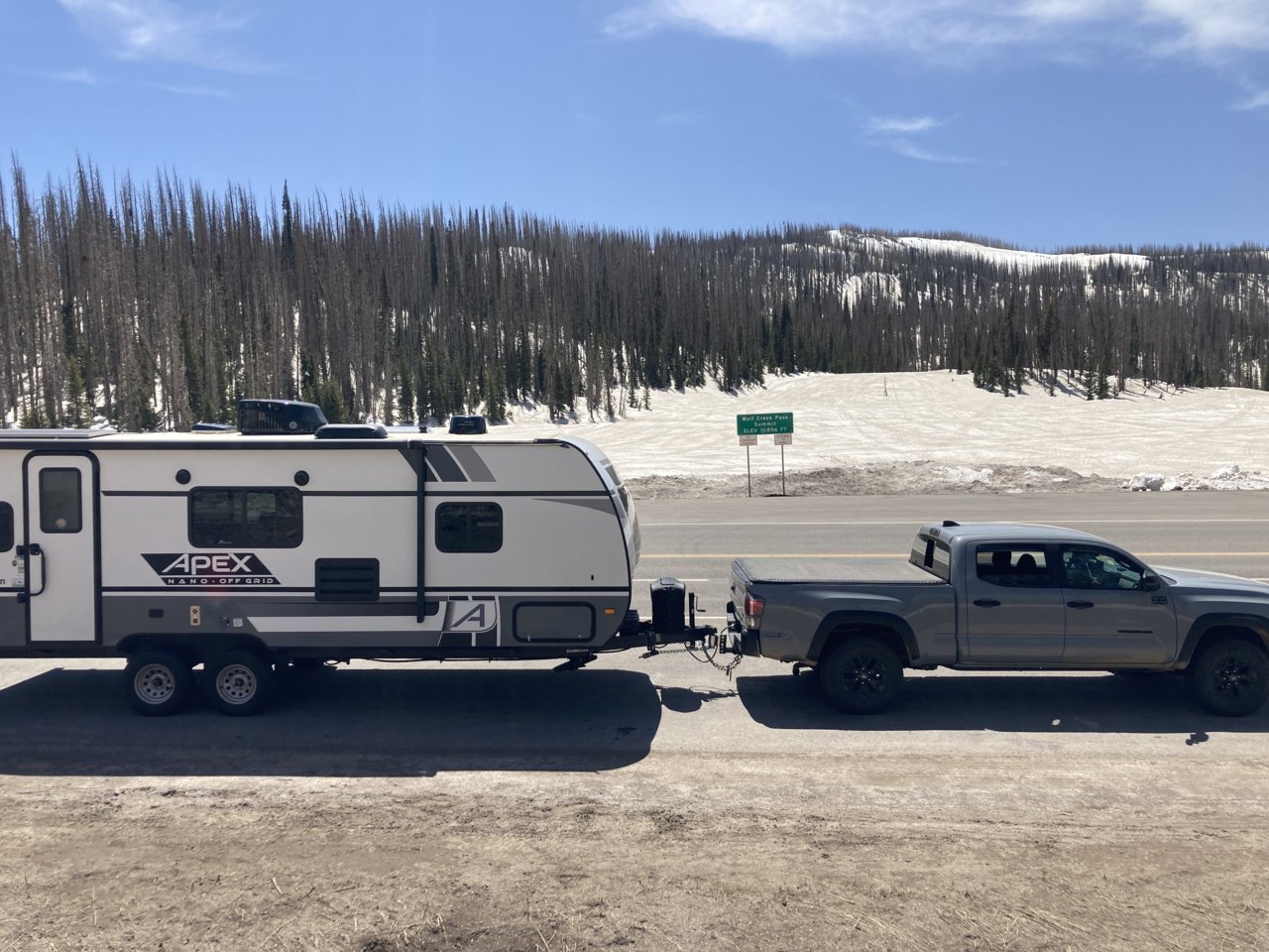

    What was your speed going up WCP? Were you able to hold the speed limit?

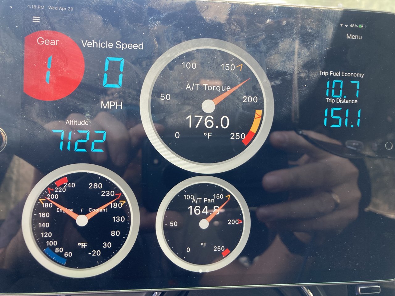

    I find this most interesting. As for my experience when towing, not enabling ECT causes massive amounts of shifting when towing anything with air resistance. Now I am on 33's, so that undoubtedly makes it even worse, but even stock or on 17" 265's it was very similar.
    As for towing in OD, I too monitor my stuff with OBD Fusion and have it set up similar as far as watching temps and locking/unlocking, temps never factor in. I do run an external cooler, but even stock it made no matter per my temps.
    The manual says use S5 or lower anyways.

    WCP speed limit 45 I held 40 up to the top, 2nd gear of course.
