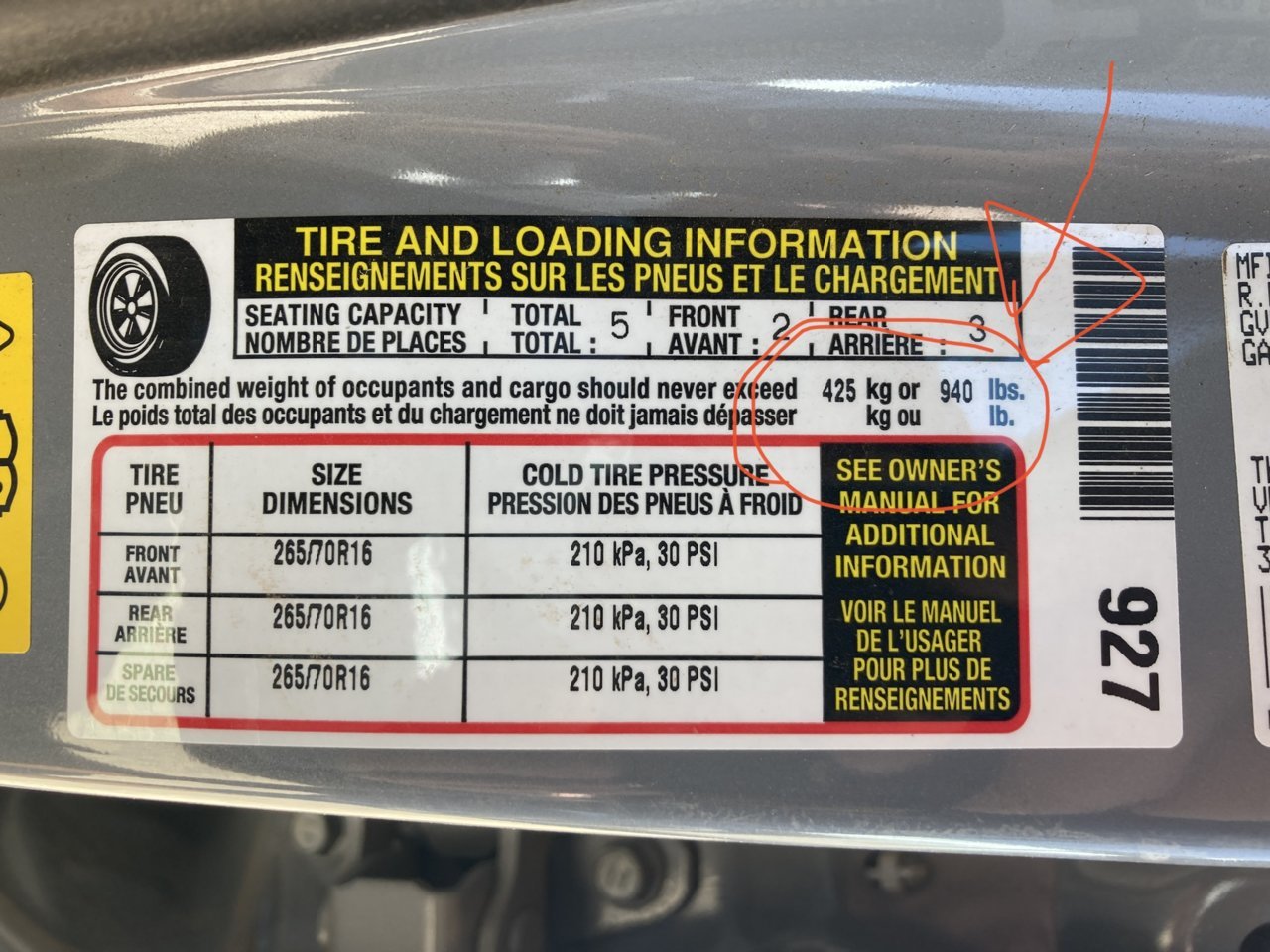

    I have some heavy side steps + TRD Skid + Talon CAT + bed mat. I'd want a tonneau cover as well to have locking capability. The DiamondBack is desired but I may have to go with tri-fold.
    **removing the side-steps would be my first step to reduce GVWR.**
    Here's some particulars I just took from the decal on the driver's side door:
    MFG 4/21
    GVWR 5600LB/2450KG
    GAWR
    Front-2940
    Rear-1490
    Tires-P265/65R17

    What does it say here…

    It states: 450KGs // 990 lbs on my TRD Sport.

    That’s good, mines an ORLB so a bit heavier.
    So your payload is 990, subtract all the stuff I listed above and that tells you how much weight you have left for a tongue weight. Tongue weight should be approximately 12-15% of your trailer loaded weight.
    You will run out of payload before you hit your tow capacity.

    The payload rating has a full tank of fuel factored in.

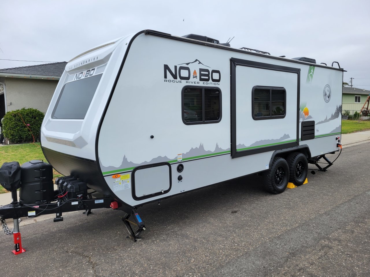

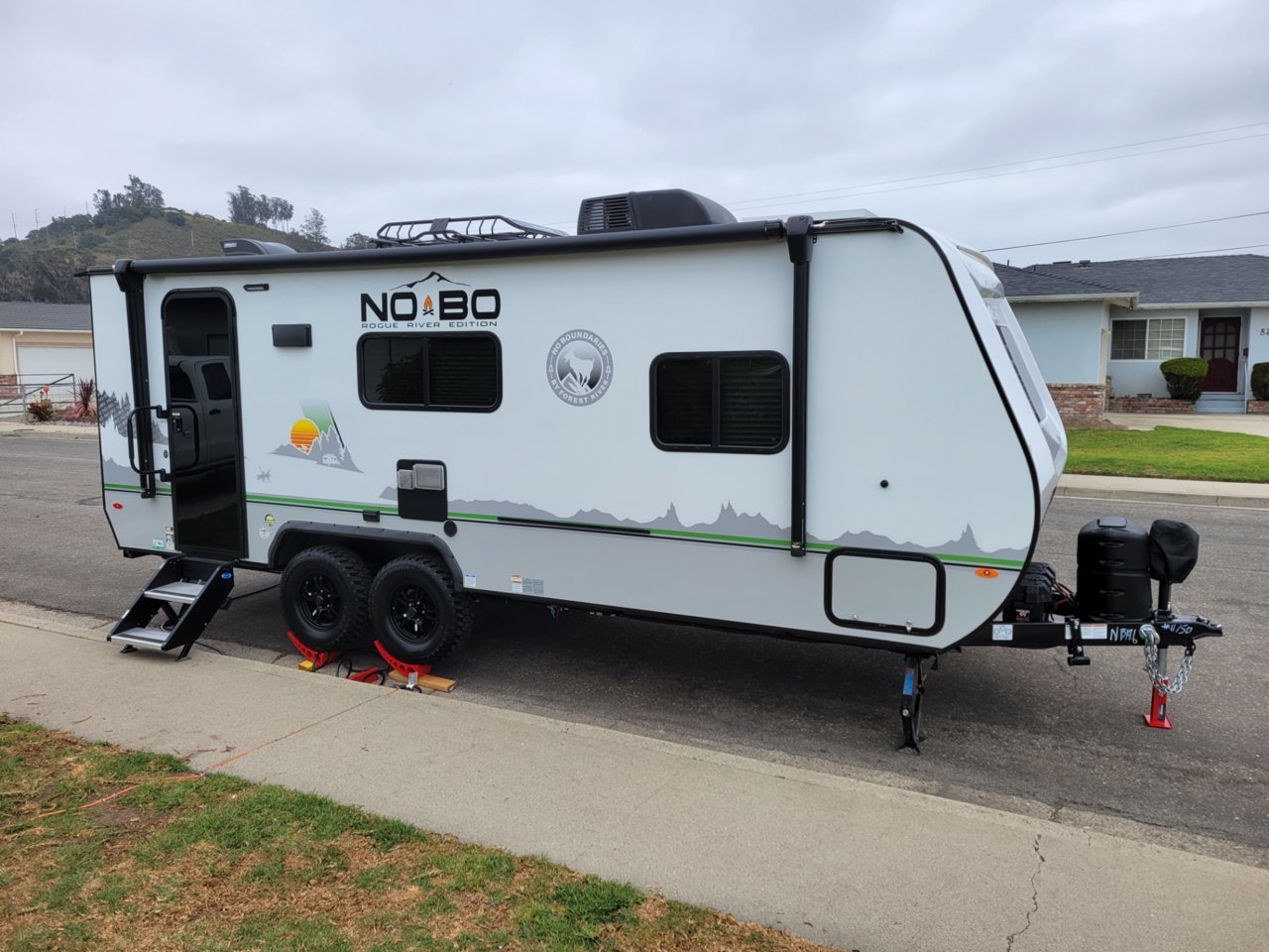

    @mosccat Great write up. Glad I stumbled onto it. I'll be going back and closely reading the back and forth but I just picked up our brand new NoBo 19.6 Rogue River Edition TT. I seriously thought I was done towing much when I bought this truck back in August! Something new everyday! Our TT specs are very similar. 4250# dry, 490# tongue, with an insane 7700 GVW thanks to the tandem axles but these run the no leaf spring, independent torsion sprung axles which should help with the off the beaten path tow performance. I also went with the Anderson WDH. I only have about 10 miles of towing so far as I have spent the last week completely going through the trailer, improving on, tightening, fixing, all the general BS with a brand new trailer fresh from the factory. Fixed 2 water leaks already! I also have a bad set screw thread on my Andersen left hand outside bracket so they're sending me a new bracket asap!
    When I first set up, I couldn't get the sag out! I was concerned about tweaking the A-frame with so much tension to clear the sag. I think my issue was the dealer filled my fresh water tank to near full which is a shit ton of tongue weight that I would never drive with. Close to 240# lbs! I drained it and am waiting on my new bracket but in the meantime, I'm just dialing her in while she's in the front yard and making it mine!
    Lots of questions to come!
