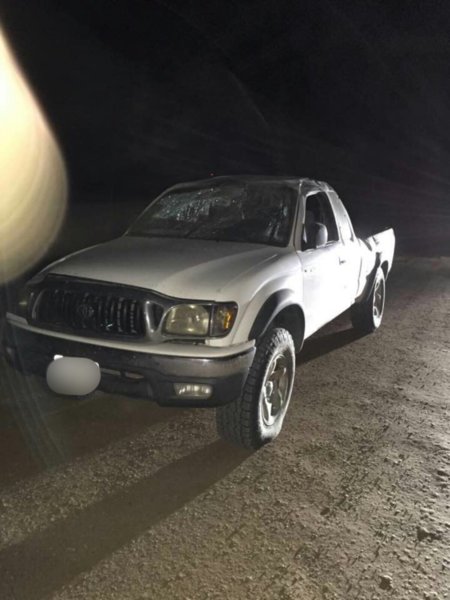

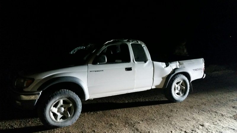

    No part out. his parents are making him repay and rebuild it.:notsure: No idea how realistic that is though.
