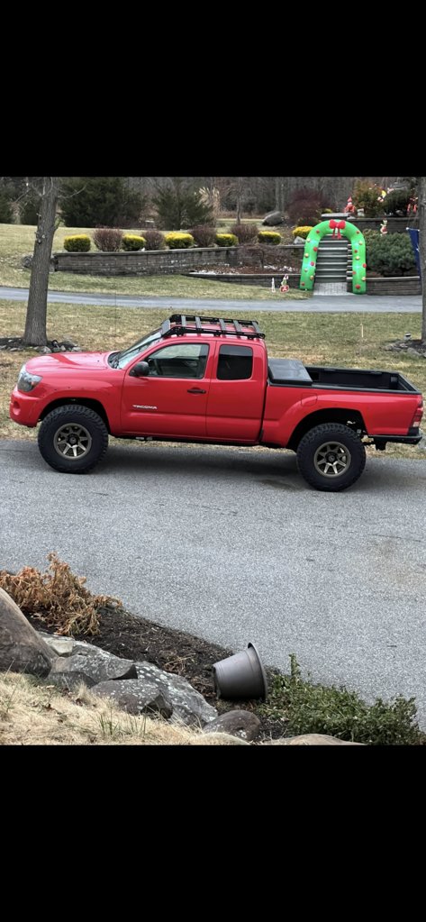

    Hello everyone, i’ve been following the forums and reading quite a lot for the past year. So much that i bought a 2nd gen tacoma V6 automatic for myself and joined the community. The truck needed a new frame and drove smooth! I replaced the frame myself, did some fender trimming and installed 35s on my truck. I was very happy with the outcome. No complains at all the truck drove like a dream for the past 15k miles no signs. 2 weeks ago i was driving home from work doing 65 on the highway and right before my exit the transmission gave out at 114k miles on it. I rolled it out the exit try to put it in gear and would only reverse. I took it home and put the scanner on it p2714 came up ughhhh. I opened up the pan removed the valve body cleaned it and tested all the solenoids. I installed a new filter refilled the transmission with toyota fluid as recommended and filled it accordingly. I followed by shifting the gears from park to L all seemed to be working fine again. I then put it in reverse and try to move the truck and it wouldn't move, no idea as to where to go from there. Any intel will be appreciated.
