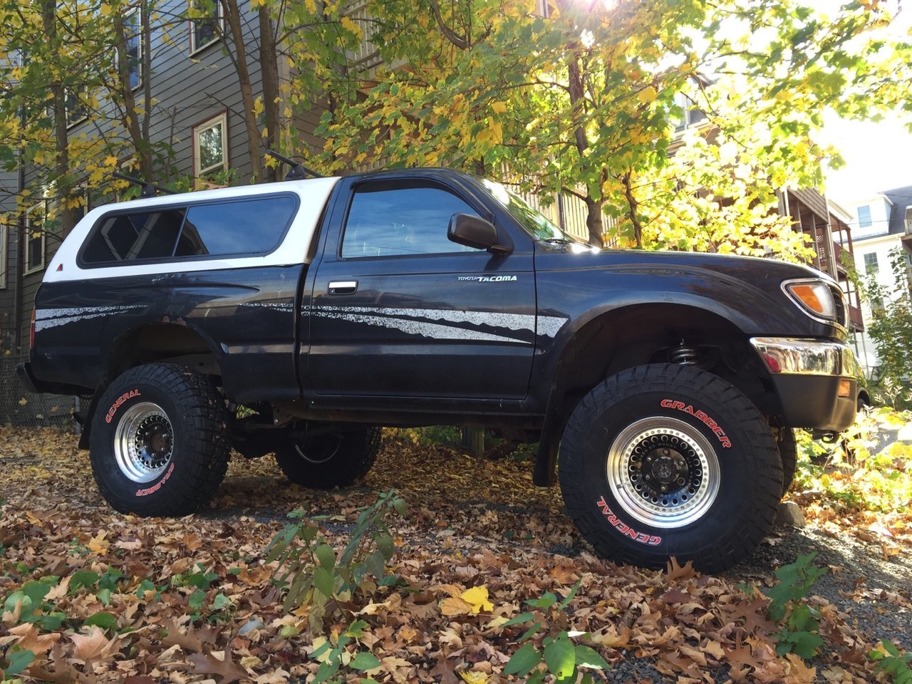

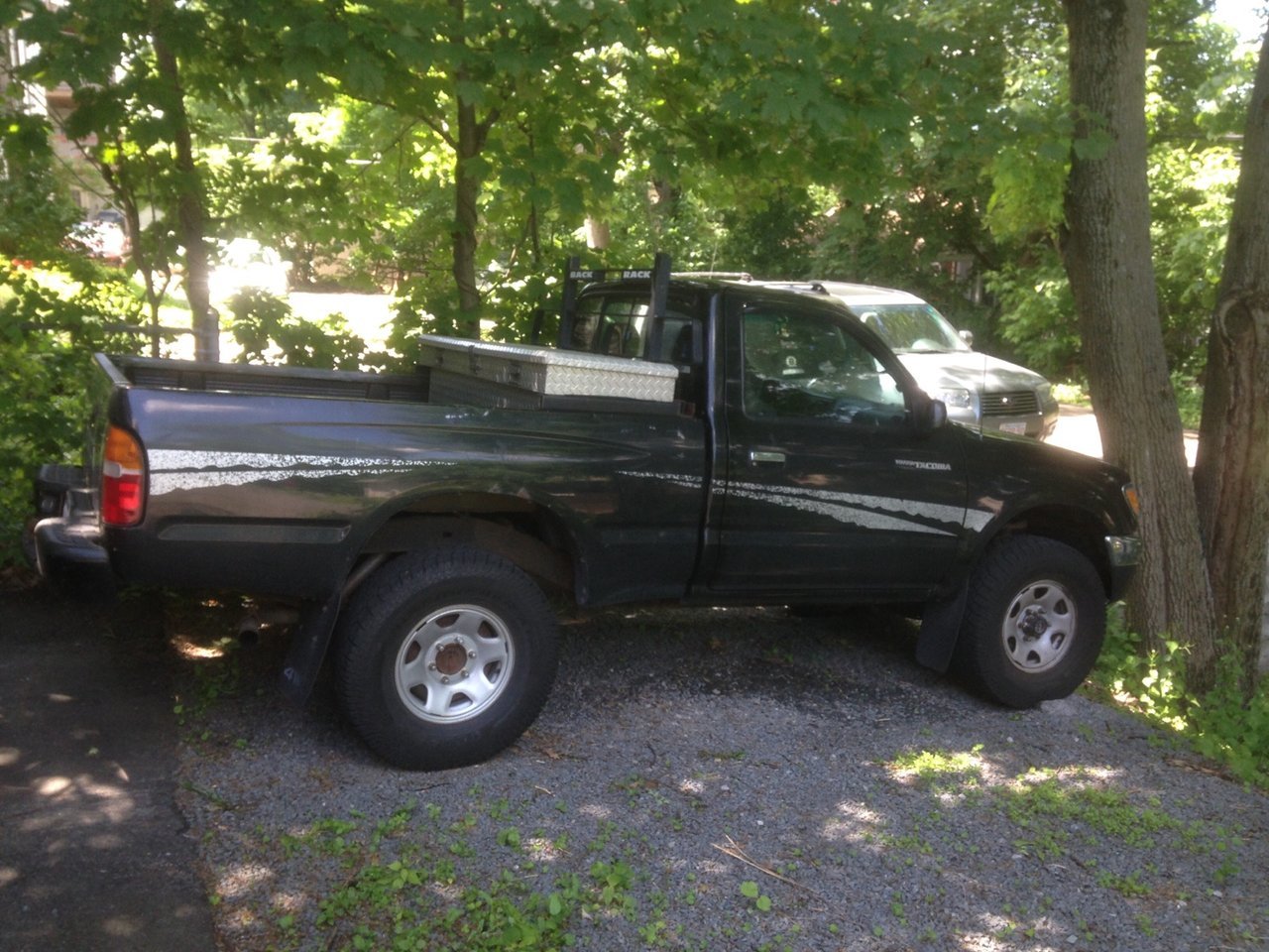

    Bought it as a winter beater but I really love the thing and want to keep it alive.
    Before
    After
    What I've done
    Plugs, wires, cap rotor
    Tie rods
    Ball joints
    3" lift
    Bilstein 5100 all around
    Toytec coils
    Ome add a leaf
    All new hardware, shackles, bushings.
    Diff/ transfer case oil.
    15x7.5 epsilon wheels
    33 tires
    Truck has 177k
    Some rust issues I plan on addressing soon
    How am I doing?
    Anything else I should take care of?

    other things to consider off the top of my head: new coolant, timing belt/components, valve lash adjustment, cataclean big maybe, maybe someone could chime in about the chevy alternator swap, new brake fluid(?), put some more lights on it, tow hitch, nerf bars.

    I forgot to mention I did
    Cat back exhaust,
    coolant flush,
    oil and filter.
    Definitely going to do timing belt, not sure why I didn't think of that.
    Did a little cleaning/under coating around the things I replaced but I'll keep it up with the rust repair.
    Brake fluid looked ok when I put in the longer rear line, but should probably flush it.
    Didn't see the Chevy alt in the DIY(worth it?)
    Custom tube bumpers and additional lighting is definitely on the way.

    I don't think cat-back exhausts come with the new cats since they're so difficult to get approved by the EPA or CARB/equivalents and that our trucks (or at least mine) have 2 cats. cataclean may still be an option.
    And yes, I heard on another thread that a chevy alt swap is easily possible since they're identical mounts. just gonna have to wait for someone who knows about them to put their 2 cents.
