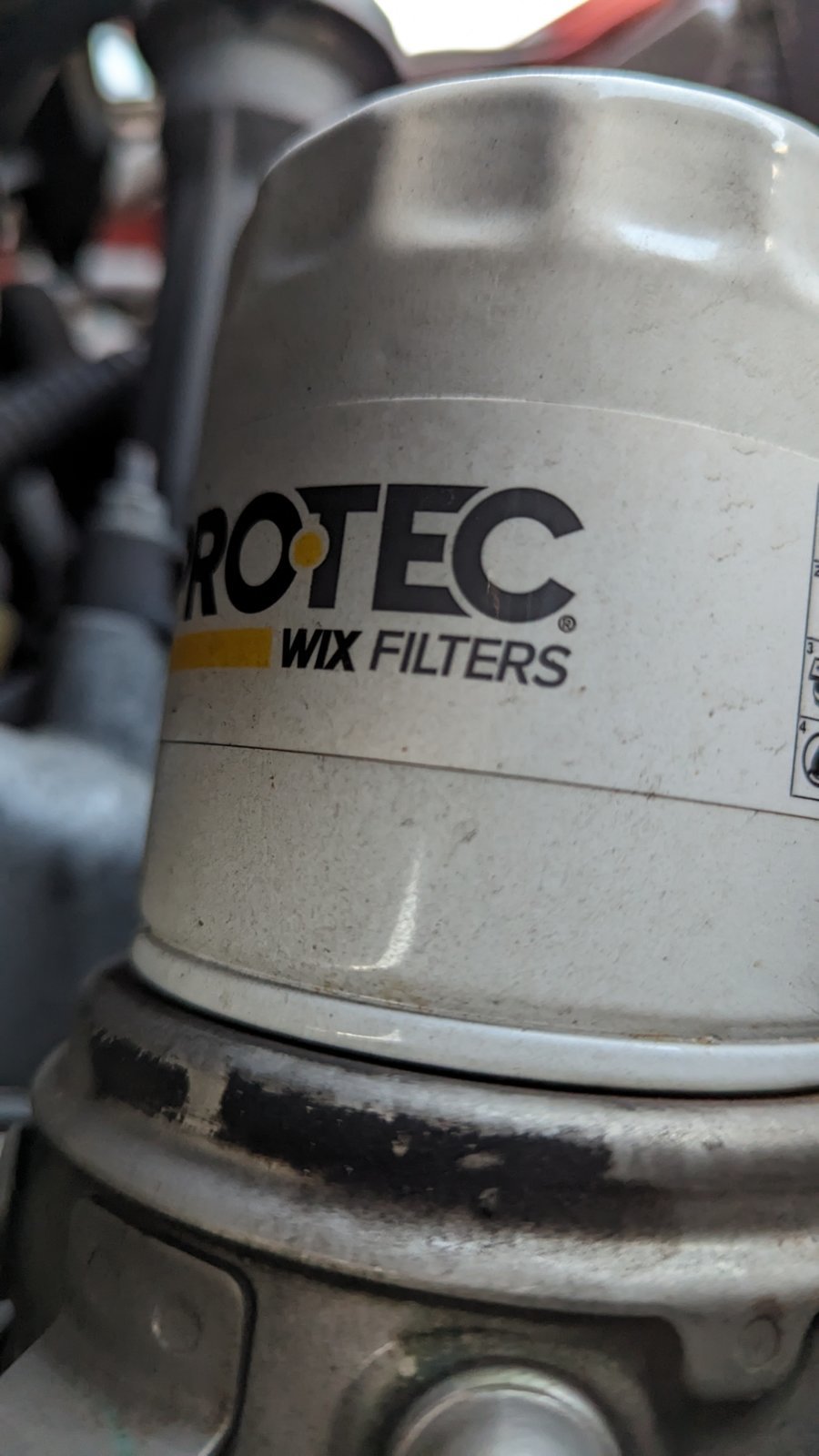

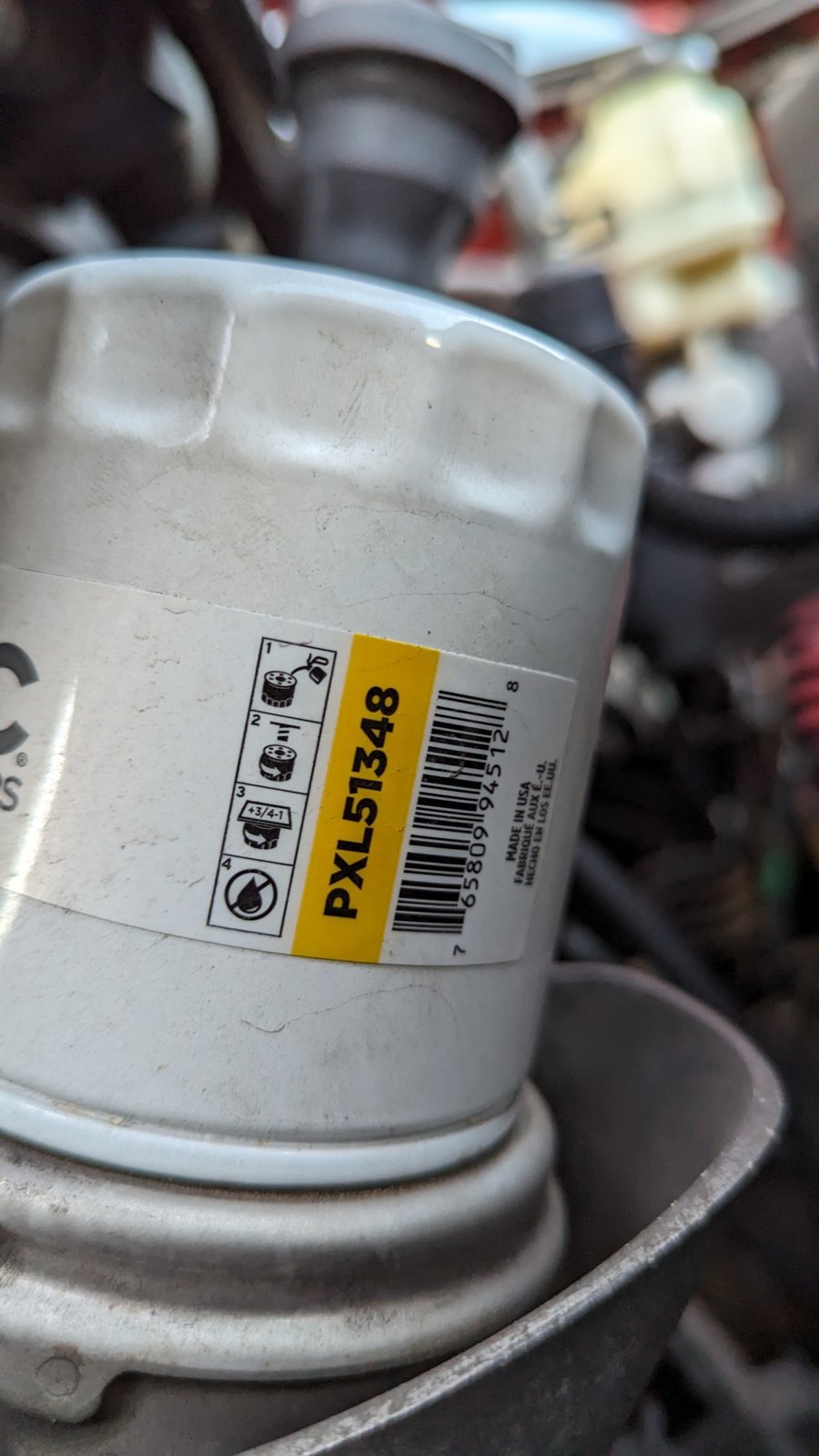

    Started doing my first oil changes after spending $80 on an oil change in North Carolina when driving it up to NY from FL. I had 81,500 miles on the odometer back then.
    The mechanic used Mobil 1 and a Wix filter in NC.
    When I did my own last year when I was at 91,500 miles. It was my first time and used a guide similar to chris4x4's guide. I used Valvoline 5w-30 Full Synthetic with a K&N HP-1002 filter (I know, I took the pic of the K&N filter on the French translated side instead of the front English cover by accident).
    I recently found more info and plan on using more of the OEM Toyota YZZD3 filters and the gaskets going forward.

    I’d re think your intervals but to each their own. I do mine every 5-6 with Mobil 1 and the larger Oem filter. It’s nice knowing you did everything right vs a kid making $9 a hour that could care less.

    Yes, I was new back then, I recently changed my oil again now at 94,450 mi on the Odo, right before taking the family on a road trip to DC.
    I'm now aiming to do my oil changes with the correct OEM filters every 4.5K or 5K miles going forward.

    i'd stick with OEM filters and invest in a Fumoto drain valve to simplify things, Just my .02. Cheers,

    If the area around your existing drain plug isn't beat up I wouldn't worry about it.
