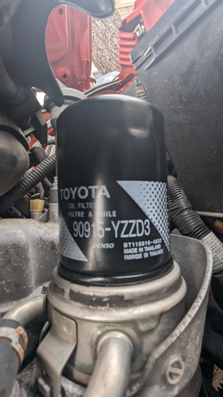

    This should make all you guys super happy - OEM oil filter installed.
    My engine seems to like it as well - runs smoother with less vibrations too!
